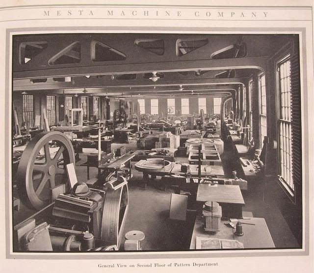

    Second floor of the Pattern Department. The roof trusses and roof are steel with covered with concrete to make the area fireproof. A platform extends out from the pattern department into the main foundry. Patterns can be moved out onto this platform and there lifted directly by the overhead cranes and taken to the place where they will be used:

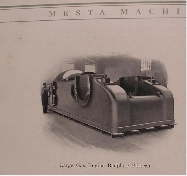

    Here is a pattern for a large gas engine:

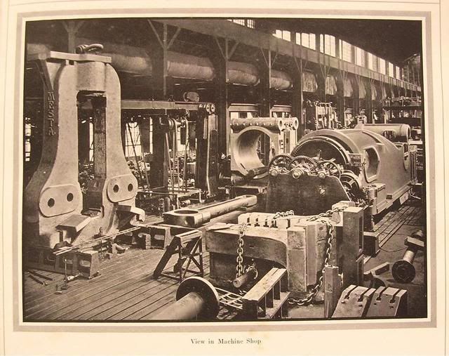

    I am not sure what this engine is, but the "centre crank" engines (ie crank arms and main bearings each side of the crankpin) were only used on Gas Engines and Reversing Engines according to the catalogue. Those look like Corliss valve cylinders nearby, but may be unrelated to the large engine bed plate being machined.
    Any ideas - are they facing the end of the bed plate, or boring the trunk guide surfaces? I guess the former.

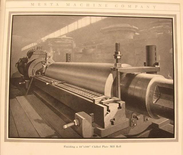

    The Roll Turning Department, made up of two departments, Roughing and Finishing. In the Roughing department there are ten lathes. Sinkheads can be removed and test cuts taken to check the roll. In the Finishing Department there are 19 Mesta Roll Turning Lathes, also other machine tools including grinders for finishing the rolls. These curious lathes were discussed in another thread a while back:

    I think what you are seeing in that crank picture is an illusion. That would be the end of the crankshaft that you see.

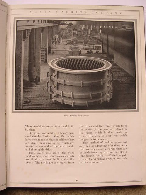

    This shows machine molded gears, ie unmachined teeth:

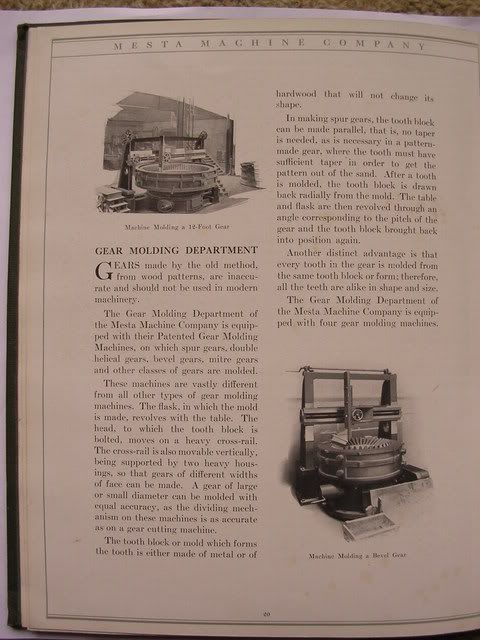

    Here is an explanation of the Machine Molded gears. They claim it is more accurate than using a pattern. It seems like a simple way of making molds, once you have the machine, that is.
    I wonder how the forming tool actually makes it imprint in the sand. I would have thought simply pressing into the sand would deform the last tooth? Anyone seen this process?

    I’m not sure how Mesta’s method differs from earlier types, but in those the normal practice with machine moulded gears was to set the short sector of the tooth pattern in place, and to fill the space with sand and ram it up against the pattern. The sand would often be strengthened with nails, and holes would be made for venting. Sounds like very delicate work. Of course there would also be all the usual problems of distortion and shrinkage to contend with. These would be much greater with steel gears than with cast iron (and it was much more difficult to get a good surface finish with steel).
