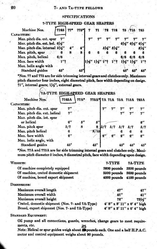

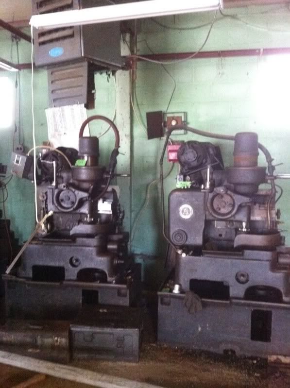

    I'm not sure on the weight of a #6, the guess of the rigger who has been working there loading out other machines was about 3800. the #7's are 3300 per the book.
    I'd need the forklift at 908 East Elm Street Scranton, PA 18505
    Archie has books on the #6, the book should have a weight listed.

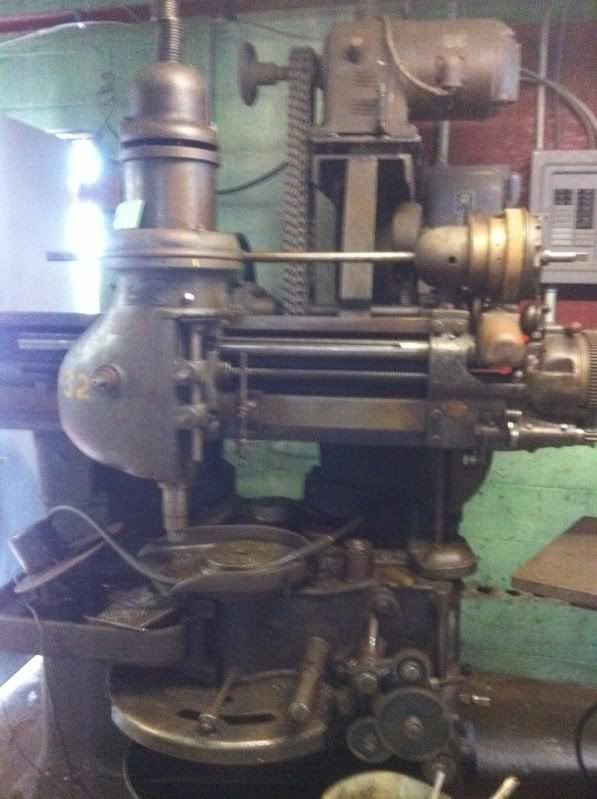

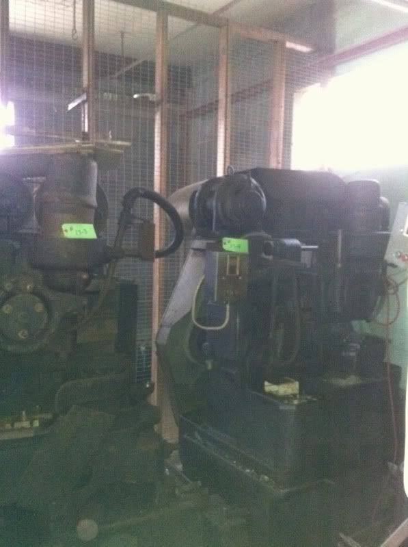

    Here are some photos of the stuff I got to move

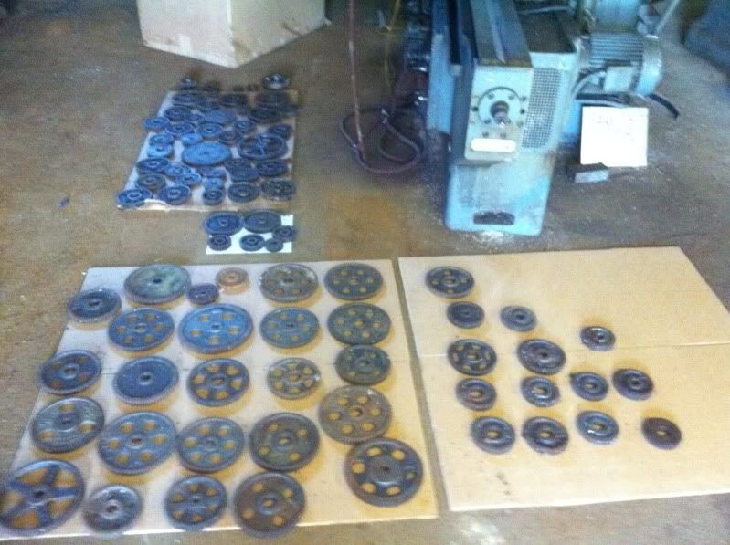

    It looks like you have 60 or more change gears from the picture. Change gears for an early Type 6 are 16 DP and 3/4" holes, with a single keyway. 33 change gears are needed to cut the range gears from 10 to 100 teeth:
    34, 36, 37, 38, 39, 40, 41, 42, 42, 43, 44, 45, 46, 47, 48, 49, 50, 52, 54, 56, 58, 60, 62, 64, 66, 68, 70, 72, 90, 96, 100, 108, & 120
    In addition there are "pitch change gears", which are also 16 DP and have 7/8" holes: 24, 32, 40, 42, 48, 54, 56, 60, 64, 72, 84, & 96. (These numbers are to the best of my current knowledge.)

    The Type 6 looks much like what we have at Tuckahoe, but a bit later model. If I had to guess, I would say 1920's. Other than the change gears, the only other loose tooling is one gear blank arbor. There seem to be a few cutters mounted on the machines. These go for up to $100 & more on eBay, so one can hope that there cutters in the two boxes pictured.

    P.S.: Looking carefully at the picture of the gears, I can see that some of them have the boss on the side where the pitch gears are identified and also that they are a mix of gears with a round hole and single keyway, and the later Fellows tri-lobe bores. The former may fit the Type 6 and the latter the Type 7's.

    Lots of change gears are included, but I'm sure a lot don't fit any of the shapers

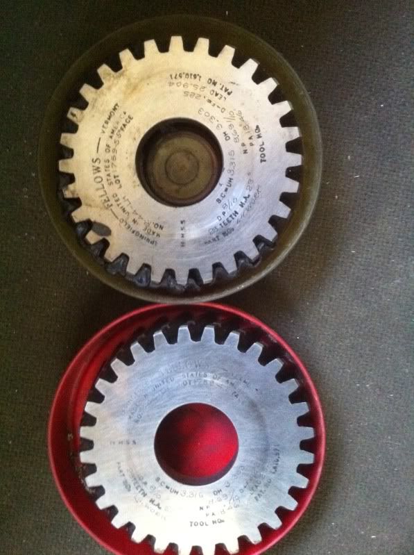

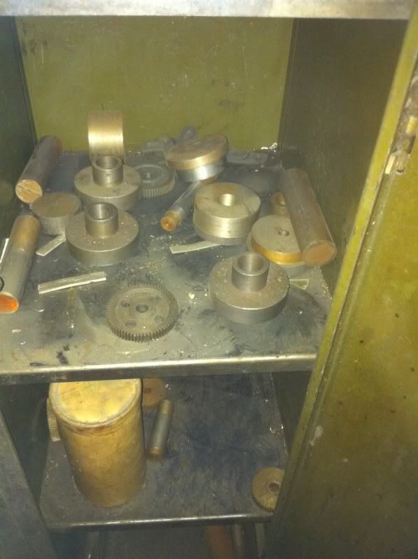

    A few more arbors and a couple of helical cutters. She says the helical cutters are for a machine they already sold, but we'll have to check and see if any of the machines have a helical guide installed.

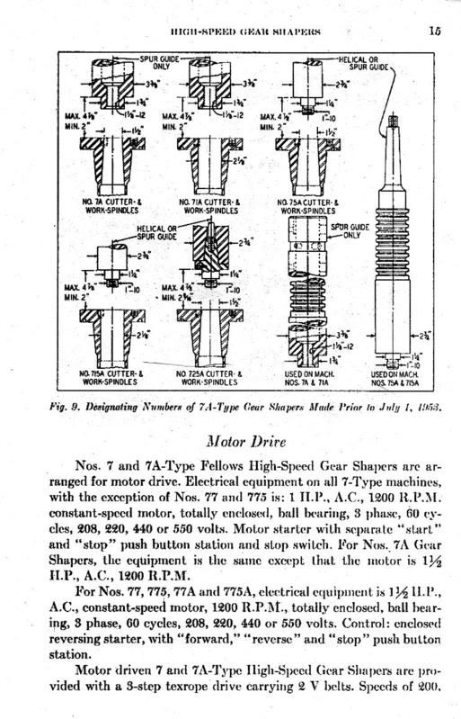

    These 4 pages are all I've found on 7 type shapers. Lots of different models and specs.

    I just looked at two of my Fellows spec sheets and here are the weights they have listed.
    6-Type shaper model range from 61 through 645Y weight given includes machine, compound tank & motor 4950 through 5700 lbs.
    6A-Type shaper model range 61A thorugh 645A# weight 6800 through 7450 lbs.
    The photo of the 6 shaper almost matches the machine shown in the 6-type spec sheet.
    Great machines I had a 615 and 2-7125 shapers.
    Hope this helps.
    I'd go with a 10-12,000 forklift to play it safe. When I cleared out my step dad's place we had a couple of machines that weighed less than the 8,000 lbs forklift but their size required us getting a bigger lift.

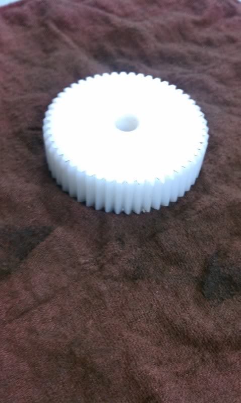

    Fired up the #7 and cut my first test gear today.
    I have 2 75's, 2 72's, and a 7. I'm not sure which 6 type I've got yet.
