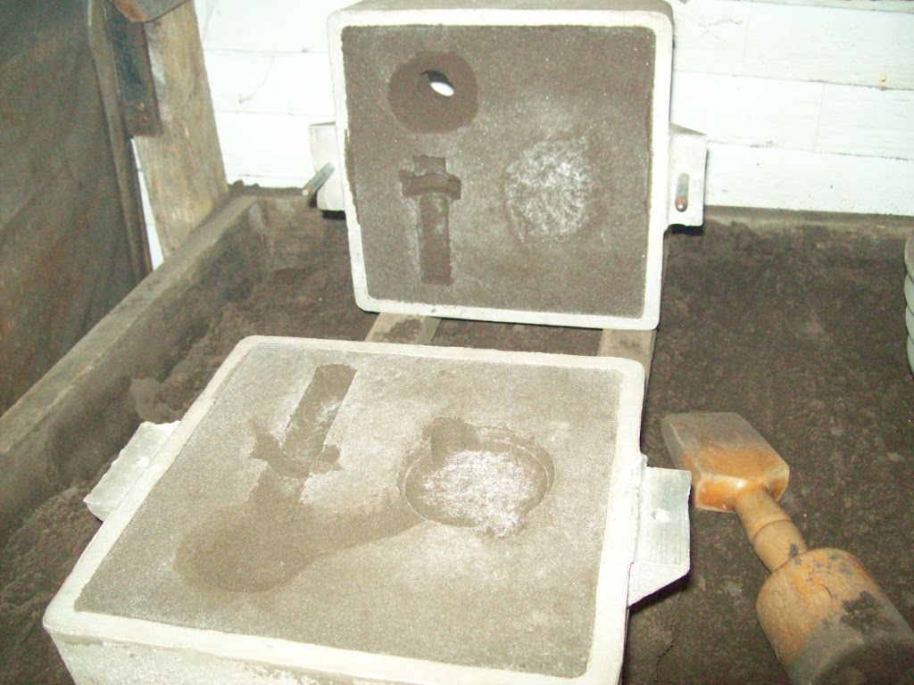

    This morning I recieved an E-mail from Peter Grant - owner of Odd Duck Foundry. Yesterday he was able to pour the resty of the fittings though today he is re-casting one of the flanged elbows - it didn't fillout on the first try (such are the mysteries of casting!) Anyway....here are some more photos for Foundry 101 continued...........
    In this photo the Drag (bottom half of the mold) has been rammed-up, flipped over and the other half of the patterns placed. Now the top half (Cope) frame will be put in place and rammed-up with sand.
    Now the two halves (Cope & Drag) have been separated, gates and vents cut and the patterns removed.
    Then the core's are placed. Peter coated them with Plumbago to give a better finish and allow the core sand to release easier. Each core has a groove cut down the center before the two core halves are joined. This allows venting of the gas from the core binder and glue. Peter was worried that the core for the flanged elbow might shift so he placed a chaplet under it - this was nothing more than a piece of bronze vent sprue from a previous casting.
    Once the cores are in place the Cope & Drag are re-assembled and the bronze poured. Here are the castings ready for clean-up, machine and polish time!

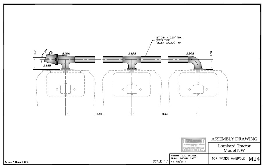

    With the intake manifold casting done I have switched my focus to the patterns for the Top Water Manifold. Similar to the intake manifold these are separate bronze castings joined with 1-1/2" O.D. brass pipe silver soldered to the fittings and rubber hose connectors.
    As usual for me I start with a good set of drawings - bellow is the overall assembly. In addition to this I have created detailed drawings for each fitting and its associated pattern which will be printed 1:1. That way I can assemble most of the pattern directly on top of the drawings, sort of like when I use to build balsa airplanes models.
    Here is a photo of the front fitting (A18A) on Don's Lombard. This patten with its tapered body will give me a good reason to use the taper attachment on the old Southbend

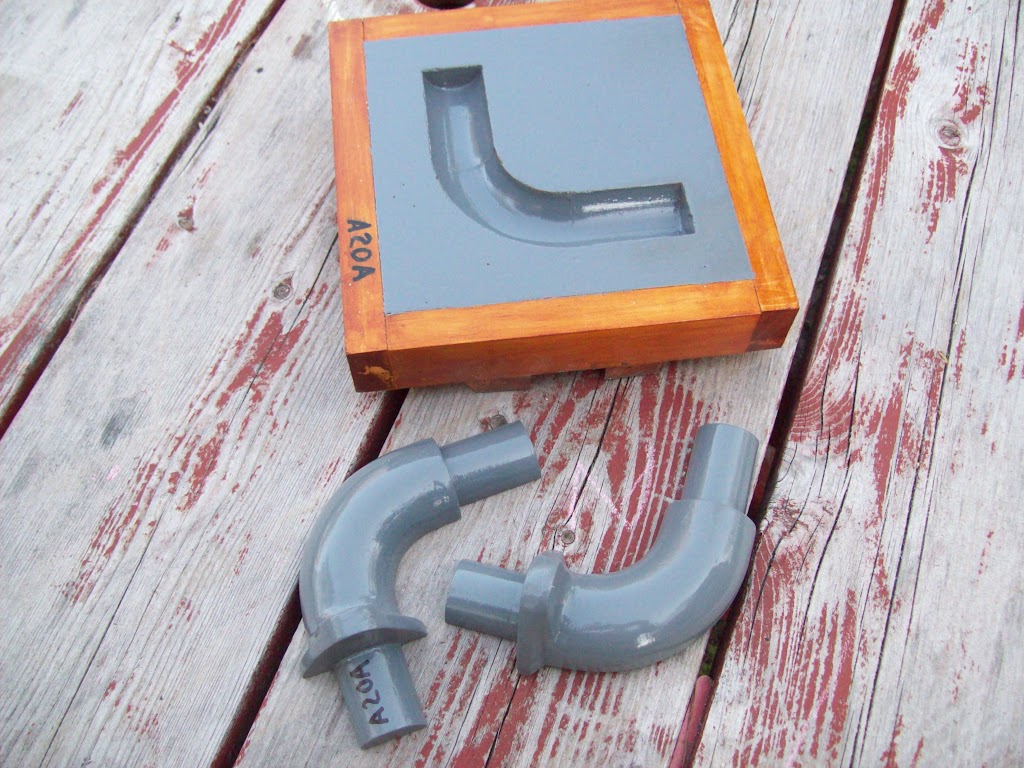

    Yesterday I finished the Pattern and corebox for part No. A20A (upper water manifold rear section) This will be sent off to the Odd Duck Foundry to join its mates for a hot
    date with some molten bronze.
    Just one more pattern to go (A32A - upper water manifold extension) and I can move onto the lower water manifold patterns. That means just six patterns to go and I will have all
    the castings on hand - then the machine work begins with a vengence!

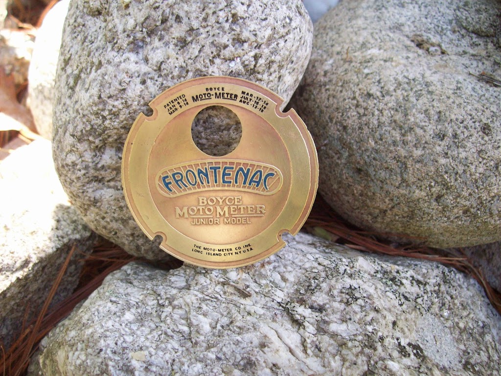

    I also took time out to etch a motometer face for a Frontenac Ford living in France and a name plate for the radiator of an model AB Mack.

    Now how I made the Elbow patterns:
    You need to know several things before you start. The first is the percentage of shrinkage for the metal or alloy you are going to use. For instance Aluminum can shrink up to ¼” per foot depending on the alloy. Therefore if I wanted to cast a piece that will be 24” X 24” I would make my pattern 24-1/2”x24-1/2”. I use a CAD program so once I draw the part its very simple to scale it up to compensate for the shrinkage. There are instances when a foundry will use a existing casting (if available) as a pattern to cast a duplicate rather than fabricate a pattern for a one-off piece. In this case it’s important that the original serving as the pattern is built-out to adjust for shrinkage. Sometimes this can be accomplished with a few coats of paint. You also must allow for machining. For instance on a flange face I will add 1/16” if it needs to be machined.
    Now onto the how too….
    First I glued up the blank. I use pine that is kiln dried and knot free. This is used to make-up of layers of wedges cut at 45 degrees and 22-1/2 degrees to form four separate segments or quarters that butt together tightly. I also alternate the wedges in layers so the joints within each quarter overlap for strength. (I.e. two 45’s per quarter in the first layer followed by four 22-1/2’s in the second layer etc.)
    Next we go over to the lathe. I use a quick and dirty sacrificial MDF face plate bolted to the face plate on my lathe. I attach the four quarters to the MDF by sheet rock screws through the back along the centerline of the finished piece. It’s important to make sure the intersection of the quarters are centered and that the break lines separating the quarters are aligned properly.
    Next we turn the outside diameter and bore the center and face to the proper height... At this point we have a donut that looks like it’s just been cut out of the dough - flat on the top with vertical sides.
    To fix this cut 45 degree facets so in cross section it will look like half of an octagon. Sometimes I will take it a bit further and cut 22-1/2 degree facets but you don’t really have too.
    Next use course sand paper to knock-off the remaining edges and transform the cross section to a half round shape using a template to check it as you go along. When you’re done you will have…well….. One half of a bagel.
    We are now done with the lathe and can check-out our work. When the pieces are removed from the face plate each quarter will match exactly with its opposite – and there you have it two elbows!
    The straight segments of the patterns are just two pieces of laminated pine that are screwed together and turned on the lathe. What is important is that before separating the pieces they need to be pegged so they can be aligned exact when you mate-up the two halves of the pattern. I use wood dowels but Freemans Supply FreemanSupply.com - Mold Making, Casting Resin, & Foundry Materials has neat metal pegs and sockets.
    In the old days the patterns would have been glued together with thickened shellac. I use plain old Elmer’s wood glue. Since these patterns won’t see a lot of use I also do not bother with keys or mortises etc. I just butt joint everything. I had not painted the mating surfaces yet so you can see how rough my joinery actually is. However, once the finish coat of paint is applied the outside surface will be nice and smooth with a close fit between the two halves.
    The core prints are the small diameter pieces that extend from each end of the elbow. These must match the desired as-cast inside diameter of the pipe. They serve to key the core in place. It’s also important that the ends of the core prints have draft so they can be pulled from the sand easily. I use a 3 degree angle. Draft is a critical item to keep in mind when developing a pattern. Any vertical face perpendicular to the parting line will need draft.
    I fill any voids and form fillets with Durham’s Water putty. You can also use wax fillets which are available from Freeman’s Supply. For finish I shellac it to seal the grain, prime and paint with automotive spray paint. It’s important to get as smooth a finish as possible so the pattern will pull clean from the sand.
    As for the core box….I fabricate a male master pattern as above with the diameter matching exactly the diameter of the core prints on the pattern and with an overall length which includes the core prints. You want the core to key exactly into the core prints left by the pattern. Here is the pattern next to one of the male core masters (work in progress). This pattern is for part No. A33A (Lower water Manifold Extension on Pump). What is hard to see from the photo is that the flange is rotated 13 degrees to the part line of the pipe. Because of this I will make a follower - but thats another story! Also because this part is not symetrical I will need to make two core boxes that mirror each other.
    Here is a good illustration of how the cores will key into the core prints left by the pattern. The cores (the graphite coated pieces are formed from a sand and sodium silicate mixture using the core boxes. Once cured the halves of the cores are than glued together and placed in the core prints formed by the pattern.
    I attach half of the core print to a piece of MDF and finish it with Shellac. Note that if the piece is symmetrical you only need one core box. If the piece is asymmetrical than you will need two (one mirroring the other).
    Next I make a simple wooden frame and make a Hydrocal plaster casting using the male pattern. Once the plaster is set I fill any voids etc. with Durham’s, shellac and paint and you’re done!
    I hope this helps!
