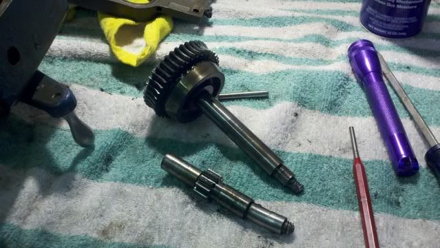

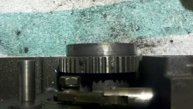

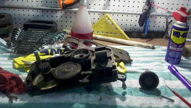

    Ok guys, made some progress last night. Took my grinder to the stripped nut on the apron and it came right off, not a single thread left on the shaft.
    While digging around inside the apron, I found 1.5 broken teeth on the clutch, I do not believe this will be a difficult fix, but you can't even tell they are missing when you turn it...
    Next up are the two "broken" shafts in the apron. Now not being a machinist, the damage to these shafts is very small relative to the amount of work it would take to make new ones. Is it possible to repair these shaft?
    The upper shaft could just have the end turned down and re-threaded to accommodate a smaller nut. And the lower shaft, which is for the apron hand wheel just need to have the bent portion replaced. Not sure if that is possible or completely re-making the shafts is needed.
    Next up was the cross slide
    Getting it apart wasn't all that hard. And the damage doesn't appear to be all that bad either. A new shaft is definitely in order, but the damaged handles are salvageable, they just need to be machined down to remove the messed up areas and then can seat properly again. The threaded piece that mates into the cross slide casting will need to be re-made.
    Let me know your feedback on the repairs that are needed. I have a couple friends with lathes that I will be calling on to see if making the repairs will be easy, but if not, might go with a local machine shop.
    Still having fun with this thing though, I have all the belts now and am ready to pull the spindle and quick change gear box to get the belts replaced.
    Ben
    You might try a little heat on the lower shaft. Slip a piece of appropriate sized pipe over one end and then hold it is a vise. Heat up the protruding stud to a red heat and then put a corresponding pipe over it and use the pipe as a fulcrum to bend it back straight by eye.
    You could try an "allnut" (long nut) over the exposed threads to protect them from the pipe.
    A couple of tries and I'll bet you can make it almost like new.
    Joe

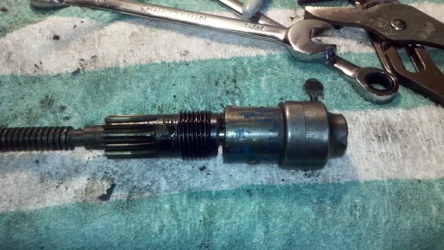

    Ok, so over a year later I am finally trying to get back at the lathe now that I am back home. I have been traveling internationally way, way too much with work since my last post and unfortunately didn't make any progress.
    I am currently trying to get the clutch apart and can't figure out how to do this. I was able to pick up another apron, so I have enough parts to get the lathe back and working once I can get it all disassembled. Appears that the PO of the spare apron decided that filling/lubing it lithium grease would be a good idea....
    If anybody has any tips on getting the clutch apart, I am all ears. I can't figure out how to sufficiently steady the gear and the knurled knob on the opposite side and get them apart. I can post a picture of the parts manual when I get home so you folks have a better idea of what I am talking about...
    EDIT: Found my copy of the manual, the red arrows point to the 2 parts that I am attempting to get apart...

    I think that it is a left hand thread!

    Quote Originally Posted by ttok View Post
    A.T.
    Are you sure? The "off" arrow is pointing in the typical CCW direction and I would assume the loosening/off for the clutch would be the direction I need to go.

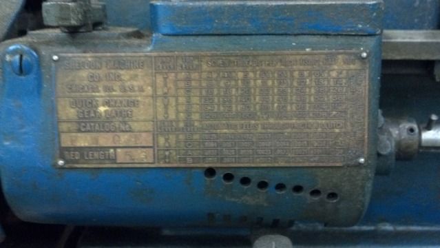

    Can you to get a clear picture of the feed chart on the front of the gearbox and post it here if it is not too much trouble.

    Well, it appears that AT was correct, it was LH threaded, I got the clutch out, now to cleaning out all of that lithium grease...

    Here are the pics you requested (with flash and none):

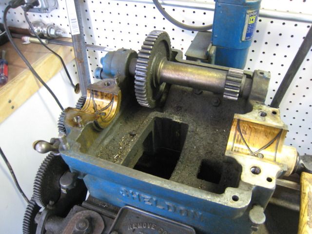

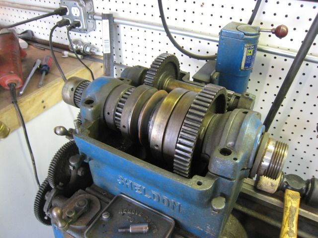

    I started the day by removing the headstock so that I could replace the belts

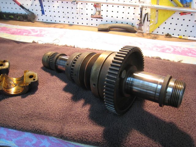

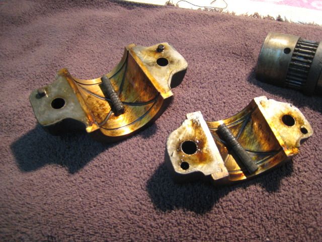

    I knew that it was a bronze bearing model, and they appear to be in great shape!
    Here is a picture of the main shaft (what is this called?) as well, looks to be good too...
    What is the rule of thumb for replacing the felt wicks? These appear to be in great shape, but I can replace them if needed. Also, the bronze on the top caps looks great too.

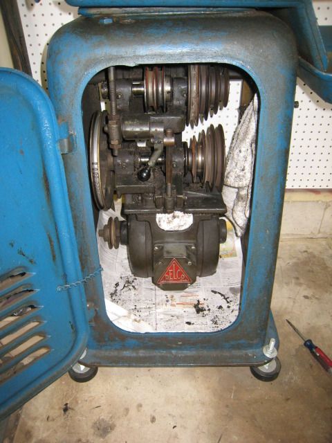

    Next up was cleaning up the underdrive, so that I could pull the middle shaft for changing the belts.

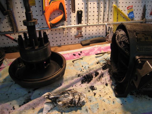

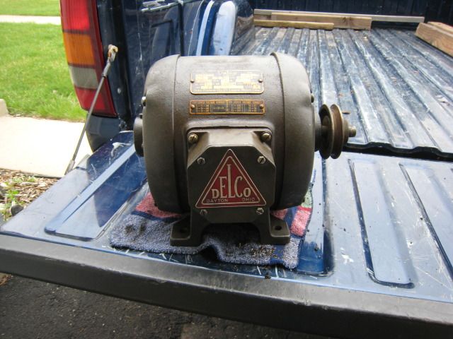

    Unfortunately, upon further inspection, the motor needs bearings and was completely (yes, completely) full of chips, so out it came...
    Do to the holes in the bottom (it is inverted when mounted) the chips (which somehow came through the hole in the headstock?) filled the motor.
    Given the simplicity of 3PH motors, I think I will be fine, but I did even find 2 keys and 1 allen key in the motor. I have never seen a smooth armature before either, I hope this wasn't worn smooth with contact from chips...

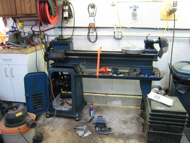

    Here is what it looked like at the end of the day
    I am currently waiting on gasket maker to get the apron back together, I need to get the proper oil for lubrication, will need new bearing for the motor, going to make a plate to sandwich above the motor to deflect chips and THEN setup for the taper attachment. I am not going to do any painting at this time, I want to get it functional and running...
