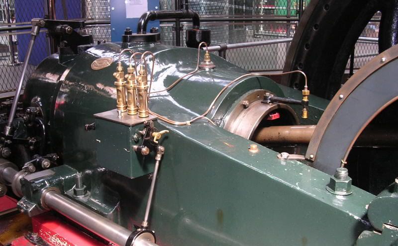

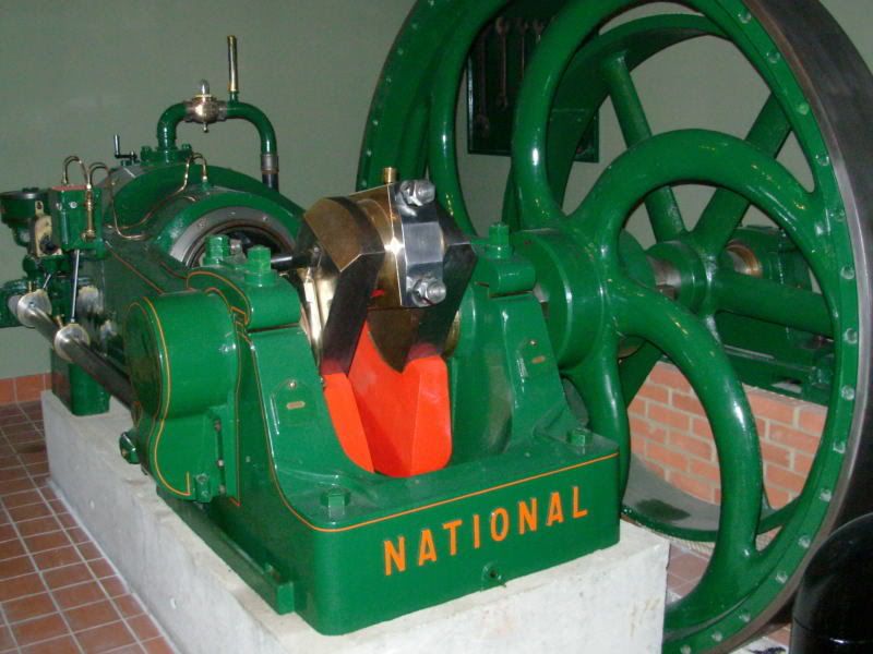

    These photos show a National gas engine at the Bygones Museum, Basingstoke. Of course it wouldn’t have looked as smooth and shiny as this when it left the factory. Some might prefer to see equipment in its working clothes, but I was full of admiration for the unusually high standard of finish that the restorers have achieved on this and many other exhibits at the museum. There are plenty of ordinary restorations elsewhere for the purists, and ‘jewellery’ like these exhibits is more likely to attract the attention of laypersons.
    This one is at the excellent Wheal Martyn china clay works museum in Cornwall. The belt drives a generator made by Newton Electrical in Taunton, Somerset. The reason I mention this is to bring in a tenuous link to Lancashire Dynamo & Crypto. Newton Electrical also produced automotive testing products, and this Division was taken over by Lancashire Dynamo, and renamed Crypton. I don’t know whether the N on the end of Crypton derives from Newton, but no matter. ‘Crypton Tuning’ signs were familiar sights to UK motorists, and the firm still has their HQ in Somerset.
    Back to National: they merged with Mirrlees Diesels to become Mirrlees National, and some years ago the Ashton works was closed. The company was started by Harold Neild Bickerton who was formerly involved with Mirrlees, Bickerton & Day, and at some point I’ll post a photo of some of their engines here.

    Let’s have some snaps of the National engine in Manchester Museum of Science & Industry. With something that looks like this, you know it’s not going to fall apart when you get it home:-

    Interesting question about the oil in those early gas engines. Here in NZ many cars were converted to run on CNG and LPG in the 1970's-80's, one of the characteristics of these engines was that the oil remained cleaner than when the same engine was run on petrol. Nevertheless, the oil change requirements remained much the same, i.e. the oil still contained unseen impurities (acids?) that were bad. I also recall there were special oils developed for these gas-fuelled engines.
    I have a 1917 Lister that drove the shearing gear on the farm I grew up on. I wonder (and doubt) if engines like this ever had an oil change!

    Going back to the Openshaw/Gorton area, I’ll offer these pictures of engines. Not very interesting, but they’re a bit different.
    This is a Crossley Combined ‘Lightfoot’ dry air refrigerator and Otto gas engine. It might not look much like a fridge, but it was, so there. It could also provide hot water to heat the part of your premises that you're not cooling.
    This is a steam-driven vacuum pump by Frank Pearn & Co of West Gorton. Apparently the works was ‘round the corner’ from Beyer-Peacock, but I haven’t pinpointed the location. I mentioned Mr Pearn's horizontal boring machine in post #121. I didn't mention his tapper, but I have now.
