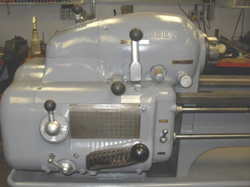

    Default Latest pics of my Hendey
    Aside from a bit of light surface rust and some peeling paint it appears to be in nice shape. I got the DC drive to work after tightening two set screws and adjusting the autotransformers to allow the gears to mesh properly. There are several belts that will need to be replaced but can probably wait for a few months. I paid about $400.00 for this lathe. It also came with 14 Lyndex BT 50 taper collet holders new in the boxes covered in layers of dust. I missed the steadyrest but did get three rotary tables and six vises too. Anyone need a vise, or some Lyndex parts?

    You did extremely well for yourself.
    A note regarding your photographs - while it is always appreciated when photographs are kept small in terms of bandwidth, yours, at least on my machine, are really too small to see details. A bit larger, and more of them, would suit.
