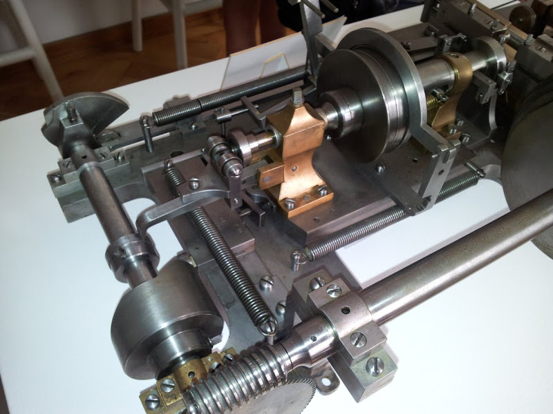

    ... which lathe would be considered the most significant lathe produced before computerized machines ...
    The date in your thread title and the theme of your opening question are incongruent.
    Most developements happen earlier than you'd think. My vote goes to the sliding head cam driven automatic.
    thermite likes this.

    That's an interesting machine, I can't find the lathe in it though! Why was this significant?
    I guess a few of you would agree that the biggest improvements to the lathe as we know it were made before the 20th century?
    I am avoiding defining MY interpretation of "significant" and am rather enjoying the various directions YOUR interpretation of the word takes us.

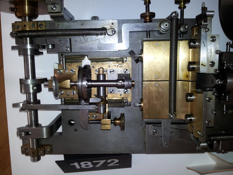

    Quote Originally Posted by etard View Post
    Here is the (sliding) Headstock and chuck:
    rearview of same:
    Here are views of the toolholders, tailstock and their activating mechanisms:
    I'm going to go out on a long limb and claim that since its invention most parts that have been made on the lathe were made on the swiss automatic type.
