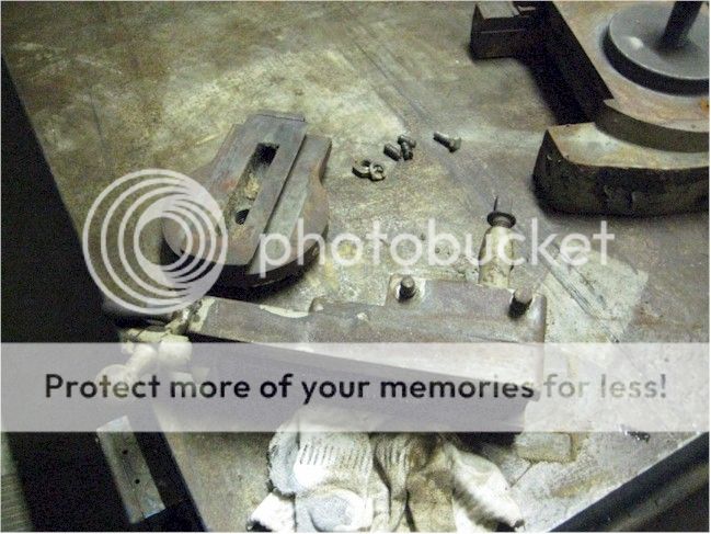

I'm fairly pleased with the swivel head, other than having to unstick the clapper box it seems to be sound. It well and truly will not budge so far with any of the finesse measures I've tried. I'd prefer not to have to get too aggressive.
On the other hand, someone left the machine with a piece of old warped stock in the vice which allowed corrosion to form under it. I'm leaning toward doing an electrolysis bath on it to see how much is salvageable. Some of the screw is eaten away and I figure the precision surface is well compromised near the stationary jaw.

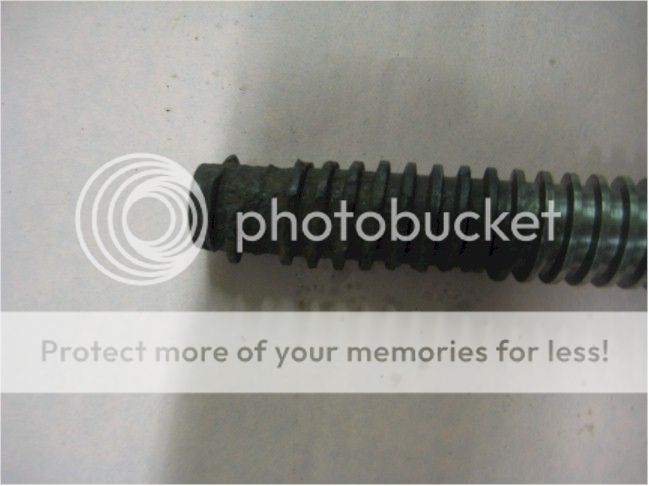

The first fruits of my labors now that all the crops are in and I have some time in the shop. I decided to tackle the vice first.
The screw being the worst part, it took some careful chipping with a spring center punch to get it out of the mobile jaw.
I let it cook in electrolysis for about 24 hours and it cleaned up enough to use. I considered making a new one, but like so many other parts of this machine, it was stamped with the number "4". So I decided to reuse anything that was obviously an original part and still reasonably serviceable. I don't anticipate working it real hard anyway, just enough to say it works.
I've begun cleaning up some other small parts with this process and it works so well I'm probably going to use it for the rest of the machine, after I can rig up a bigger tank for the main sections.

The main clapper box pin on a shaper is usualy tapered. If its driven in a bit deep or rust sets in, it will lock up. Caliper both ends and see if yours is tapered. If so, a well placed hammer blow or press should loosen it and allow you to drive the clapper free.
