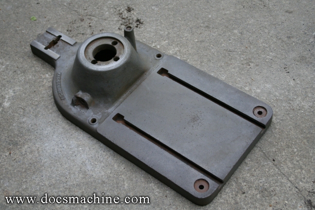

Lots of good progress today. Only major thing left is getting the spindle out of the bevel gear. I suspect that water ran down the shaft and locked them together. I almost think this machine got rained on (probably only once) and put away wet. Several of the smaller shafts have signs of rust lines. I'll soak it for a while and see what happens.
The problem with the quill turned out to be my bad. It would not push up because it was hitting the quill gear. Duh. I pulled out that, then it pushed right up, along with the top gear.
The main shaft bearings are well pitted. I think I'll try Paul's polishing plan and see how it goes, and consider Docs replacement idea for another time. The counter shaft is very nice at the motor end, and slight signs of rust at the other end.
The main downfeed drive shaft is also nearly frozen. I thought it was moving, but it turns out that the pulley was slipping. Got that soaking, too. The backgear eccentric is also locked, but the gear turns fine. More soaking.
All the major parts cleaned (and inspected) in the parts cleaner. No noticeable wear and not a single damaged tooth.

I'm planning on fitting small snap-cap oil cups to my main-shaft bearing caps. I'm not yet sure about the lower pulley shaft, as I may well be switching that to sealed-bearing pillow blocks. (The babbitt may be too worn to use properly, and modern bearings would eliminate a couple of oil cups. I want to use the thing, not spend all my time maintaining it. )
But apart from that, I don't see how a bit of cotton would hurt anything. On mine, the existing cups are so small that they wouldn't hold an appreciable amount of cotton and oil, so I doubt it'd save much oil-can time.
I will note, though, that on my crown gear, there was a hole drilled in from the underside of the gear, which was packed with cotton/felt/fiber of some sort. I assumed this was a wick to help maintain the oil film between the lower face of the gear and the top of the "thrust washer"- which in my case was a flat circle of something that looked fiberous and phenolic, almost wood. I have no idea what it was. I may replace it with a Delrin or Teflon disc.
Doc.

I was thinking about oilers on the main bearings, too. Maybe something like below for that 'period' look? I agree on the use it, not just maintaining it. Mine is only for casual use, nothing production.
I'd be interested to hear more about the pillow blocks. Would you mount them atop the existing shaft support? Since you noted sealed, I guess they would have to slip over the ends, right? The end opposite my v-belt pulley has a significant burr around the entire diameter, almost a 1/16". Nothing a file or grinder can't fix, of course. I don't know that I'm up to trying to redo babbit bearings, although mine should be OK for now.
Any suggestions on the best tool to use (file, stone, etc) to ensure that there is nothing left of the rust on the shafts that sticks above the shaft surface? I used steel wool and a wire brush so far, and they look much better, but the pitting is obvious now.
Any pointers on putting the babbit caps back on properly? There are some very thick shims on each side of all of them, easily a 16th or more and with clear impressions so the position is fairly obvious, and the bolts are much smaller than the holes, 3/8 vs 1/2 (or so). None of the bolts were more then slightly tight. Is that typical for babbit?
The Southbend forum has a "tool loaner program", any chance that idea has passed by here? I'd sure love to borrow an MT4 reamer to touch up the spindle.
Speaking of that, I already have a chuck with an MT2 and a MT2-MT4 adapter (not MT3 as I thought before), but it does not come up the spindle far enough to reach the release hole (technical term). Any reason I can't make a spacer to make up the difference? Is there a proper tool for this, other than a simple tapered bar?

-While those surely can't hurt, I had something more like these in mind.
-Actually, the vague and as-yet-undefined idea I have is an all-new setup. As I noted before, I'm thinking of making a riser, a short, fitted "table" to raise the whole drill up about six inches. I'm kind of tall, and the machine is deceptively short.
The table will also serve as a motor mount, as mine didn't have the built-in electric setup yours does. I'm proposing to mount the motor directly above the "tab" at the back of the base casting, in place of the original countershaft and mount. The motor would be bolted to the riser, not the drill base.
Then I'll make some hoop or bracket that mounts the countershaft directly above the motor. I'd obviously reuse the cone pulley, but I'll probably wind up making a new shaft and all the support bracketry. The old shaft, collars and bracket would be saved in case any restoration becomes necessary.
The cone pulley would then be raised roughly a foot, possibly as much as eighteen inches from it's original location. No big deal since I'll have to buy a new belt anyway- the old canvas one was long ago destroyed by exposure.
Now I know none of that applies to your setup, but if it were me, I'd just make a new bracket that holds a pair of over-the-counter pillow blocks, and whip up and new shaft for 'em.
