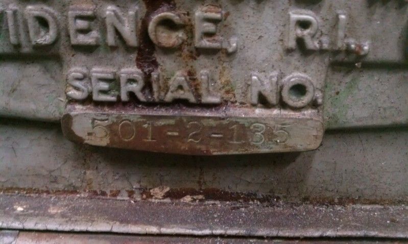

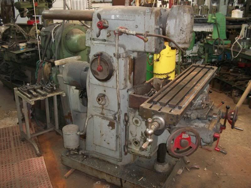

    Well I finally got around to re-wiring it from 440 to 220 and took it for a test-drive. Everything is working great except for the feeds. Rapids work, but no feeds. I've looked around for a manual and can only find one for the plain model. Another issue is when I fill the knee with oil to the middle of the upper sight glass, it begins to pour out of the peckerhead on the feed motor. Ideas? I really dont know why there are two sight glasses.
    Anybody know what year it is?
    On a side note, I'd spend more time fixing the mill up if I could get this POS to run right! What a mess!!!

    Not real sure about the sight glasses, but is it possible the upper one is a drip indicator for the knee oil pump and is not to be used as a fill level? Pacemaker lathe is set up that way.
    A guess would be about 1960, but the serial book has no 501 except the 2B under Dynamaster, and the first of that type number is 501-23-55 for '62. The Plain 1B was 502-2-133 for 1960.

    On the knee - bottom glass is for oil level, should be 1/2 way up. Top sight glass is for flow. If you need, the drain is in the front to the left of the elevation screw. If I recall correctly it takes an Allen wrench about 3/8" to unscrew the drain. I think there's a filter next to the drain. This oil does the saddle/knee ways, and the knee/column ways, too.
    Don't neglect the auto oiler for the table traverse - there's a sight glass on left side towards the back of the saddle. The filler for this is on the bck of the saddle on the left. The pump is under the saddle on the left, in front of the traverse leadscrew. There's a distribution block under the right side of the saddle towards the front behind a cover plate. The pump is stroked by the power table traverse lever through a cam and a long rod.
    There's a solenoid inside a cover next to the knee motor that has to pull in to get the feeds to work, it clutches in the output of the feed box. This allows you to start up with the feeds engaged if you want. You might check this solenoid as I think the rapids bypass this solenoid with the lever clutching the rapids in mechanically.

    Pull the feed motor and check the seal. It's probably shot.
