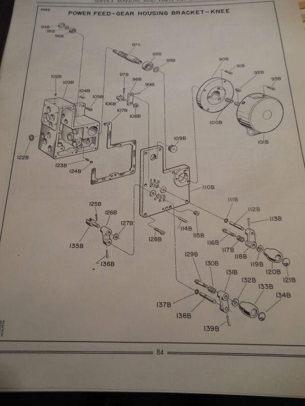

    Hi Andy what do you think the chances of me finding a OEM power feed motor for this and how many arms and legs do you think it would cost me? if I can't find one then I might be interested in letting go of some part. What parts are you needing? In one of the pictures on my original post,can you tell me what that tooling is worth(the plainer bit and the two facing tools... I guess that's what they are?)

    Here is the feed motor and other parts from the manual. The part number of the motor is 152543. I really don't know how hard it would be to find the motor. You might have to buy a parts mill to get one. It might be possible to adapt another motor to it.
    Don't know about the cutter value try looking them up on ebay. What you are calling "plainer" (on the right in the photo) is usually called a slab horizontal milling cutter the others look like old insert type face mills.

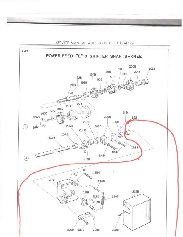

    Hey Andy...I haven't had time to do much but I did find the parts and service manual from the place I got the mill and there was some notes in there suggesting they ordered some gears for the powerfeed so I took the side cover off and found there to be acouple gears pretty chewed up. I can't seem to find any of these parts and from what I'm hearing from some guys, I probably won't ever unless I buy a whole machine for part and sense this is a hobby, I can live without that powerfeed so if can give me the part#'s I'll see if I got those ones or are you saying you need the whole gearbox? Just let me know I would consider sell or trade. I do need a few more things to get it going...I think I'm just going to buy or trade for a RPC and I still would like to find a good vise. Thanks

    I will get a list and a photo of what I need. I don't need anything in the gear box but others might. Cash might be better for me but I do have lots of vises and might still have a RPC. Shipping might be to high for a trade to work.

    I'm looking for any of the parts under the red line (all of the detent stuff). I will get the parts numbers soon but the Key numbers are 212B and 217B - 229B if you have the parts manual.
