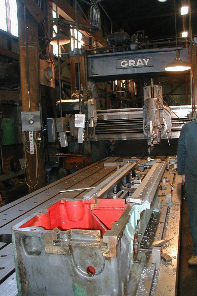

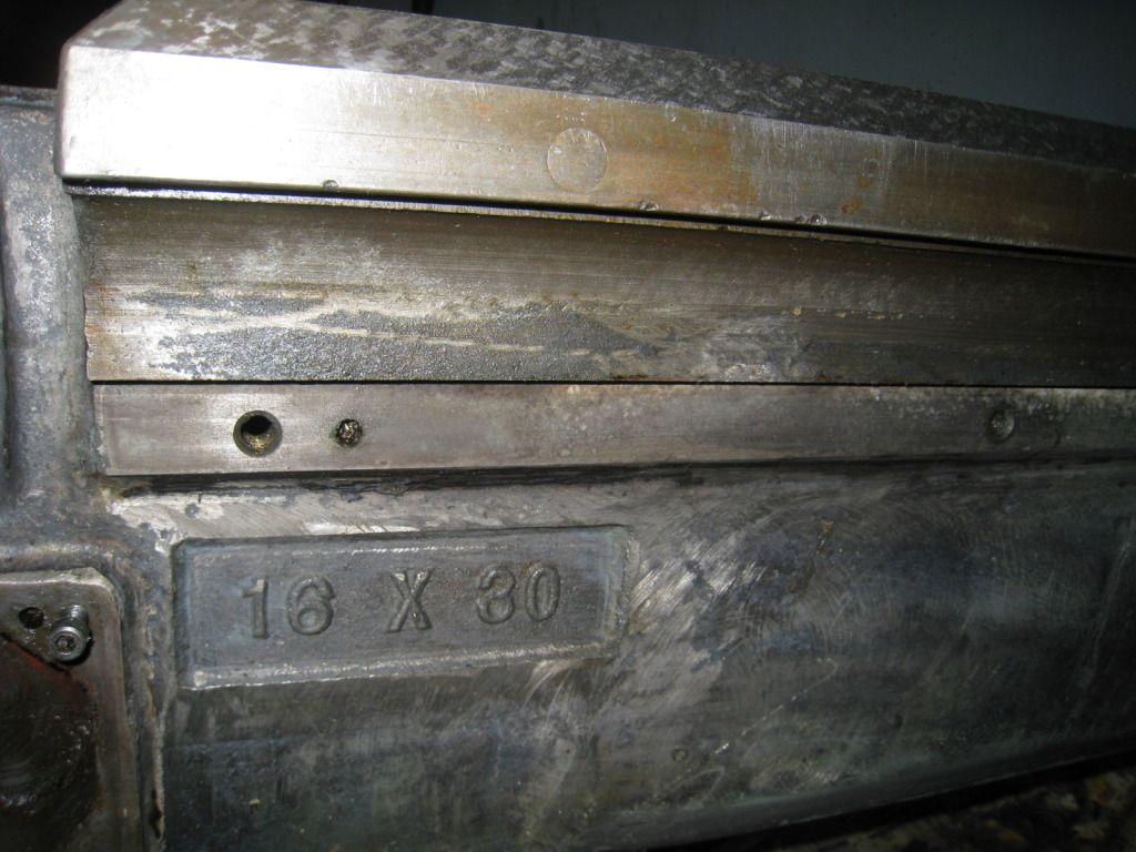

    Thanks Harry, I will look through those post. Here is a photo of the lathe bed on the planer.
    John, I did look briefly at removing material between the apron and bottom of the saddle, until I took it apart and realized as you said that it would cause huge problems with the crossfeed screw drive. My plan is to lower the gearbox to match the new center line of the of the shafts and leadscrew. It looks like I will either have to make some offset pins or leave them out all together. I will also have to modify the rack by milling slots where the cap screw holes are to enable lowering it. Sounds like everything will be coming down at least .040. My goal is to not have to do any sort of buildups with turcite or moglice.

    Great picture, I would love to see more of the shop where you are having your bed done. Do you plan to scrape the bed after planing?

    Although it may appear differently, but I'm one for doing the least amount of work on a reconditioning job as possible. I don't scrape a headstock unless I have to, or relocate gearboxes, etc., I'll use way strip bearing material to build up the saddle. So far I've been lucky, it hasn't been necessary.
    How are you going to deal with the apron mounted leadscrew reverse function that is tied into the headstock?

    Ronr, I don't have anymore pictures of the shop that planer is in. I think they have been there for 50 plus years and I don't think things have changed too much it all that time. They had someone come in to scrape and flake the bed/ apron after they planed it, so unless something comes up I will not have to deal with that. (which is good because I am not an experienced scraper, although I am lucky enough to work with one who is will to teach/ help)
    Harry, the feed reverse and leadscrew reverse linkage will be a tricky one. The connection is between the quick change gear box and the back gear ratio gear box, so nothing directly to the headstock there. However the back gear box will not be moving down, as it is driven directly off the spindle shaft and the headstock has not moved because I had them leave the headstock bearing surface alone. To make up the difference I will most likely make a new part in the linkage between the two gear boxes. Honestly, I am not planning too far ahead until I get the machine back together and have a better idea about what I will be dealing with.

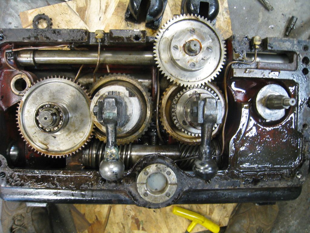

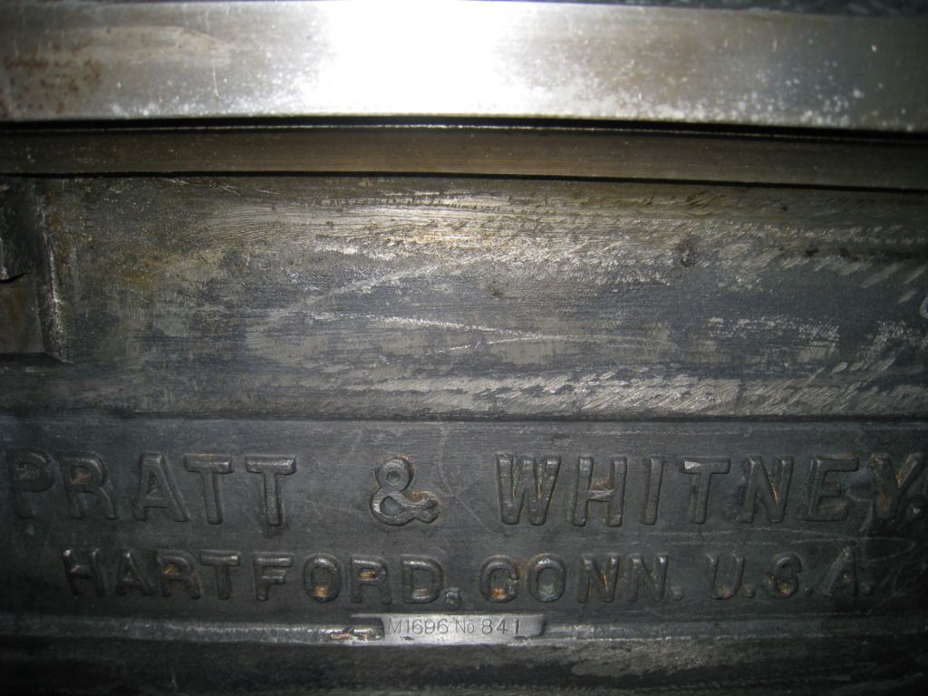

    Here are some pictures of removing the spindle. The large gear on the front of the shaft is a tight fit, so to avoid too much work with a soft (and large) hammer I grabbed a piece of scrap and drill two holes which just happened to line up with two 1/2 -13 holes in the headstock and also span the back of the shaft. I then used different threaded rods from a typical milling hold down kit to press out the spindle. It worked great. Beware as previously mentioned here on PM (thanks) that besides the obvious locknuts that needed to be loosened, the inner races of the bearings and keyed, and the keyway does not go all the way through. You must remove the key on middle angular contact bearing before the thing is going anywhere! I wish I took a better photo of that to share.
    If you look close at photo 2 you can see the needle bearings slightly exposed in the rear end of the headstock casting. I am not sure if I will replace these, they look as though the are in good shape. Anyone know how much radial play the are suppose to have when new???? They are a simple and inner and outer race with loose precision rollers. I imagine one might be able to just replace the rollers with slightly larger ones if needed, though I have not looked into this.

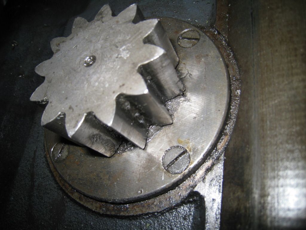

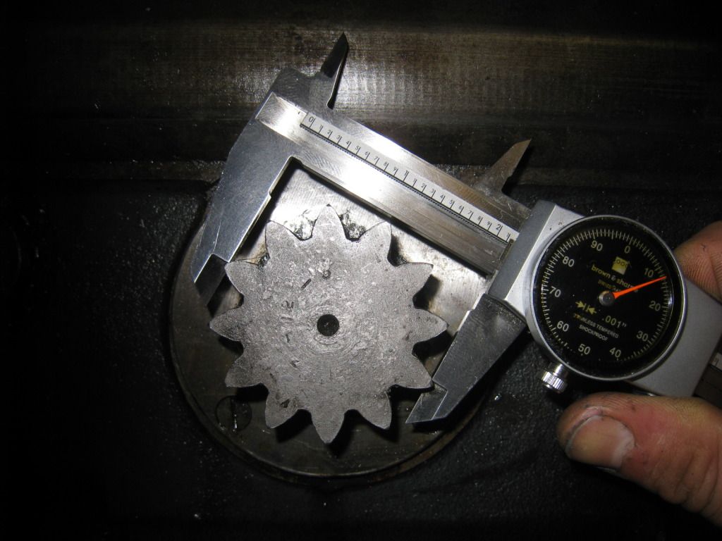

    Some pictures of my worn pinion gear, resulting from a lot of time of running with poor spacing with the rack, due to lots of bed wear. I am still looking into how to fix this. I posted a gear specific question in the general section about this but thought I would also put the pics in this thread. Here is the link:
    Pratt and whitney rack and pinion gear question

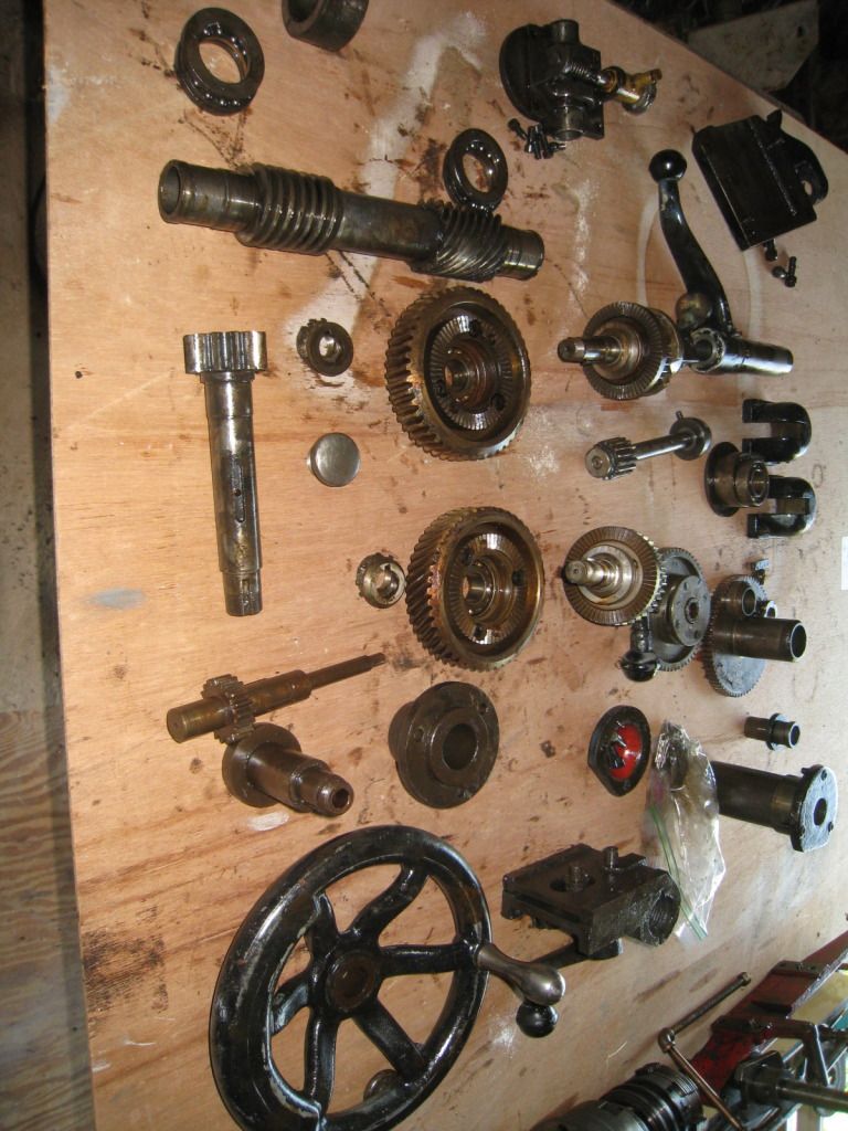

    This weekend I got a bit of time to work so I did a little painting on the lathe bed and headstock. More interestingly I got into full dis-assembly mode. I stripped the apron, quick change gear box and the ratio gear box down to the castings with the goals of:
    Finding any parts that need work
    Replacing most bearings/evaluating any bushings
    cleaning all parts thoroughly (there is years and years of grime everywhere)
    The good news is that the vast majority of parts were found in dirty, but otherwise decent condition. The bad news is there are a couple that are going to need work. The major one is part of the single tooth clutch forward reverse assembly. As can be seen in the photo below a major part was completely cracked down the center. Amazingly the clutch still worked fine in this condition as everything was held together. This one is going to be a pain to make...tapers, keyways, etc. It is doable though. Pretty far beyond any welding/ brazing repair! Any recommendations on material and hardness on this piece???
    The only other problems were a chipped gear in the quick change box and the worn spur gear of the rack and pinion that I had pictures of earlier.

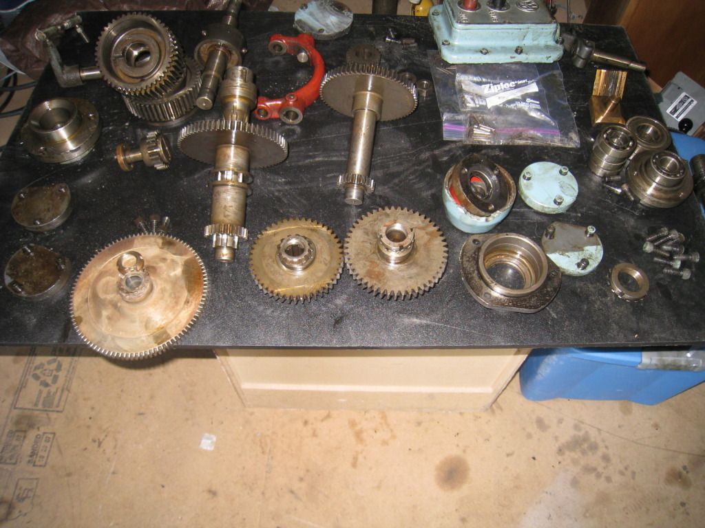

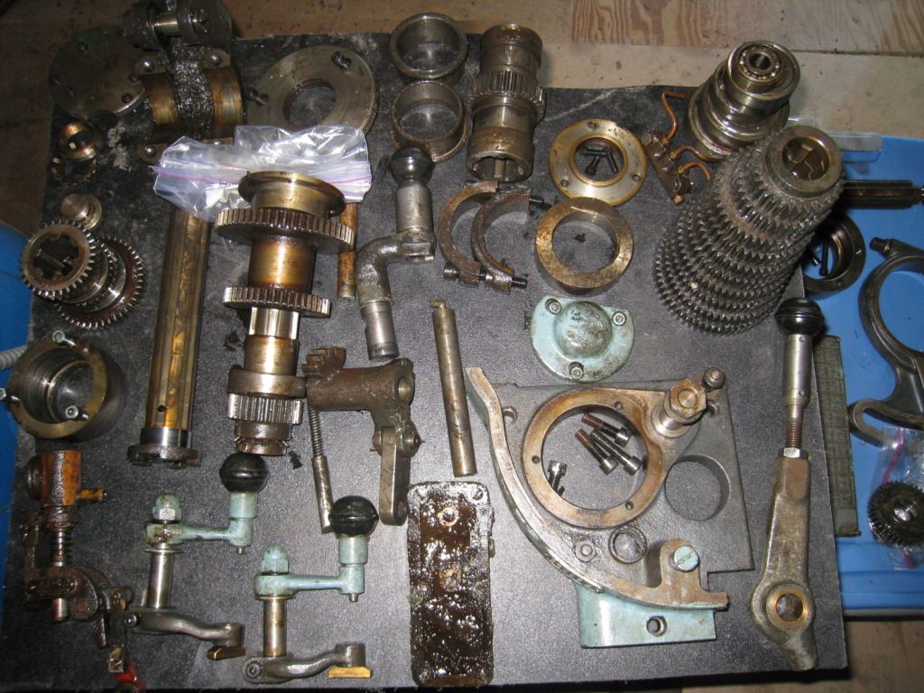

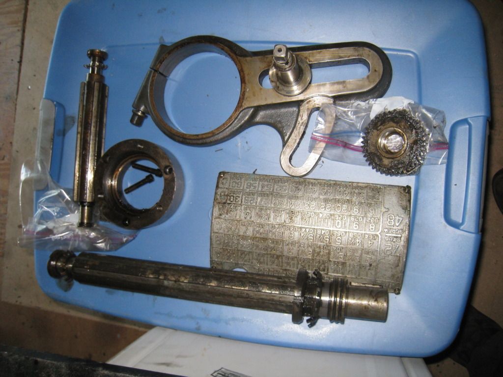

    For those who are interested in such things here are some pictures of the various parts, now waiting to be cleaned:
    First is the apron with the cover off
    And the apron parts
    Quick change gear box parts
    Ratio Box parts
    And finally a picture of the worn spur gear from the rack and pinion that I am still figuring out what to do with. I found a local gear shop that thinks they can cut it for about 2-3 hours shop rate if I supply a blank. That is if the have the cutter, otherwise they rent it from Ash gear or someplace similar for a 100-200 bucks. Still pondering this one.

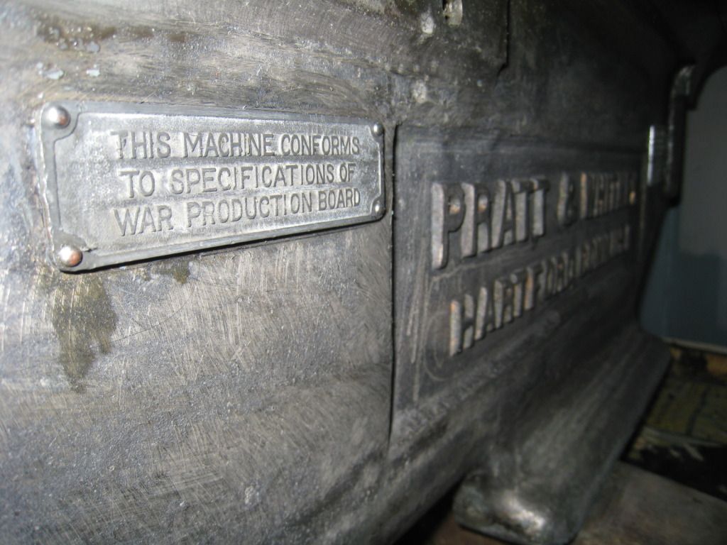

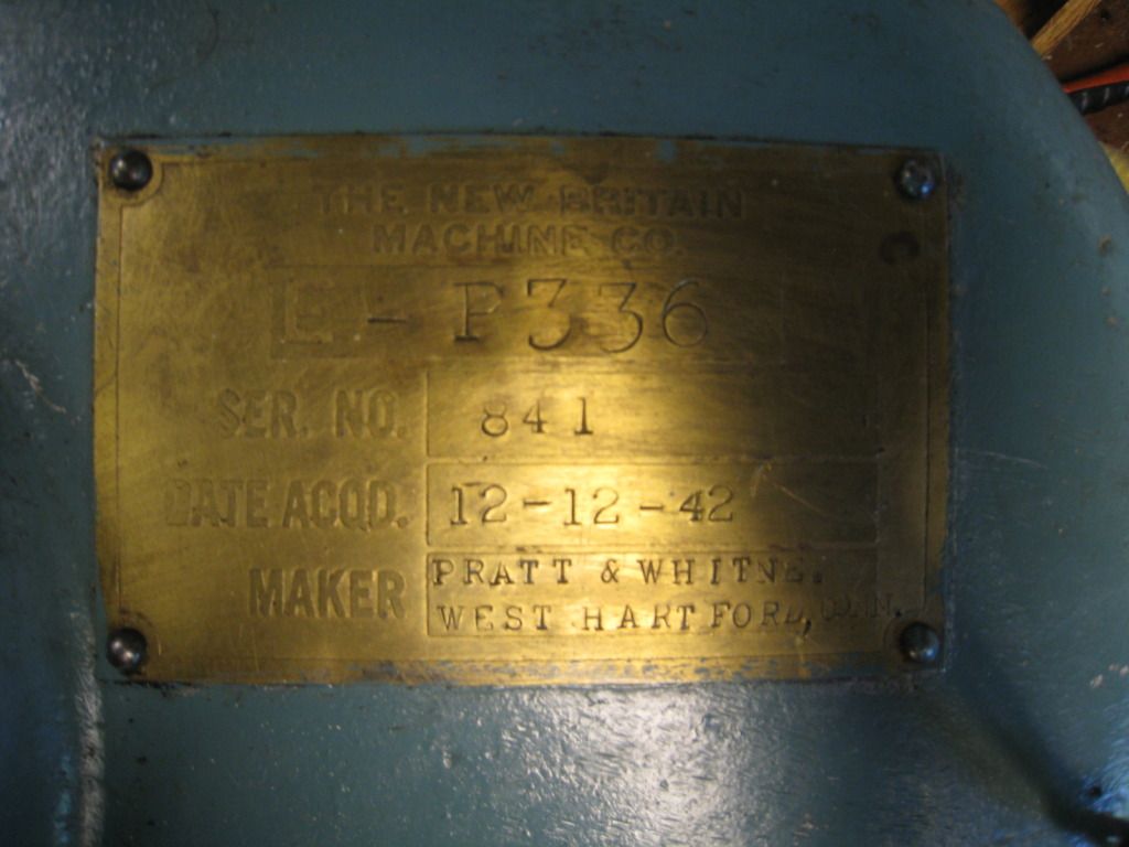

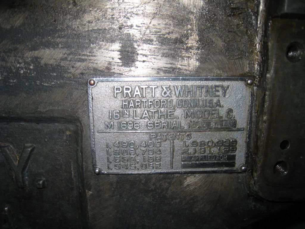

    Some other somewhat interesting photos (to me anyway and hopefully some others out there)
    Looks like this lathes first home was at New Britain in December 42 from that asset tag. Hopefully it will be back to its old self by its 70th year anniversary!
    rustytool likes this.

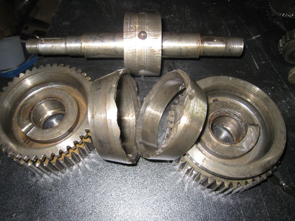

    Cool on P&W - looks like the "C" single tooth clutch assembly was redesigned to include cone clutches - sort of like sychronizers in an automotive transmission - the intent seeming to be to slow things down a bit before the immovable teeth crashed together.
    But then I could be full of it, too.
    If not - what might the cones do?

    Spot-on. Attempt to match speeds by dragging the least-resisitive or unloaded component into a velocity match with the more resisitive or loaded one. Most surviving vehicle synchros are more complex - ZF especially so - but same general concept.

    Yeah, even broken I thought that was pretty neat. The whole one piece cone (well one piece before it cracked...) provides increasing friction in either direction to get the gear spinning as the single tooth on the gear comes in to be engaged. All regulated by three spring loaded pins in the shaft piece and the v shaped groove on the cone they ride in.
    The manual says
    "In order to assure correct timing between the headstock spindle and the leadscrew after they have been disengaged for the reversal of the carriage, this clutch is of the single tooth type. A synchronizing device has been incorporated in the mechanism so that the so that the clutch can be engaged without danger of breaking at any combination of spindle speeds and carriage feeds within the requirements of good shop practice."
    Maybe someone did not read those last few words!
    How much life do you think I would get out of a cone made of 4140 prehard? Looks like the existing one was harder than that...

    Bill, you have a good point about the spur gear, while worn, it is uniform, unlike the rack. I was thinking about grinding a cutter to match a unused portion on the rack and recutting the rack on my mill maybe .020 deeper to clean it up. I don't think the rack is too hard. I would then just shim it from the back to make up for what I took off.
    About 30 years if he used the lead screw reverse once a day - that is the only time the cones do anything. Besides - you could make a spare!
