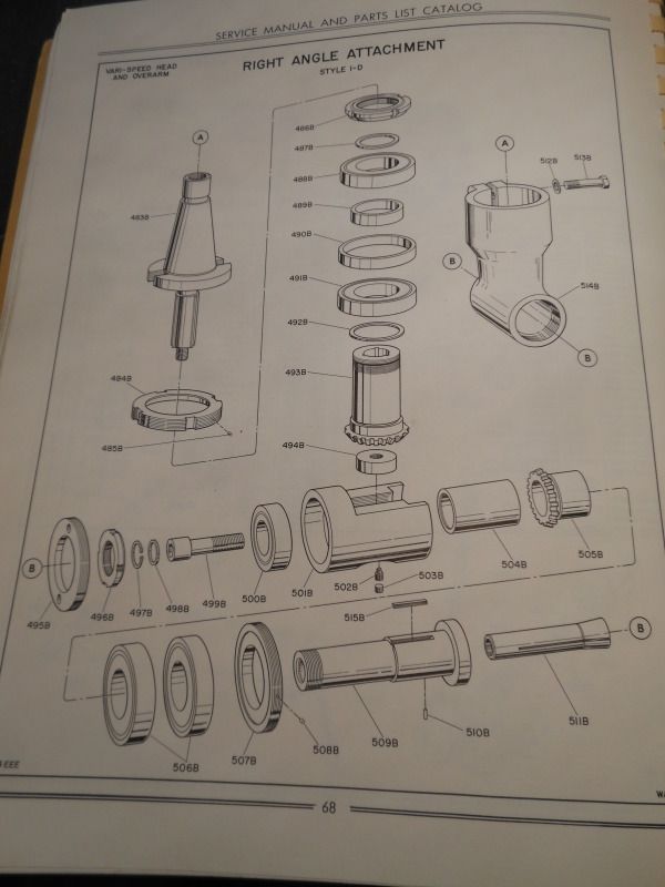

    Sorry I don't have a scanner right now so this photo will have to do. The drawing shows a thread on the end of the #40 arbor with a collar that screws on. Still not sure how this would work.

    I'm not 100% convinced that this is a true Cincinnati Toolmaster right angle attachment.
    If you look closely at the Andy St photo of the Toolmaster manual, that arbor has a three tooth male spline as the driving element and the driving gear in the head has a matching female spline.
    As I recall. the three tooth spline was a favorite Cincinnati thing for driving rotary tables and dividing heads.
    I suspect this angle head has its roots at Excello as the head casting has indicating/alignment surfaces parallel to the 30NMTB spindle centerline.
    Not to say that Cincinnati never sold an Excello head as a late model Toolmaster accessory, but I doubt that this one is an original Cincinnati Toolmaster attachment.

    Sorta agree with you Mike....
    But there's another posssibility and that is that the intire attachment was made by VOLSTRO in Feasterville Pa...it sure looks like Hermans work...
    Now for the nity grity.....
    Look at the bottom of the page and the collette that holds the tool... WHAT a pc of lightweight JUNK...
    then to confirm what it's ability to do much of anything look at what drives it... No 510B KEY....
    ya think that's a 3/16 pin??
    Also note that every part number on that page ends in either a B or an 8.... I think B... Cincinnati would never end part numbers like that page shows if it was THEIR Design.
    My recomendations??.... treat that thing with kid gloves, dont use a cutter larger than 1/2 endmill and sell it to someone that falls in love with it ASAP.... You can mount the work on an angle plate faster than hooking up this thing....

    Mister Honey,
    The picture that Andy posted is of the correct 1-D style and looks to use R8 collets. Mine is for a French machine and has an NMTB 30 horizontal spindle. I will add some pictures from the French manual for you guys to have a look at. It does show the indicating bar on the side.
    Gary,
    Please look at the pictures I posted a link to. Mine is NOT built like the one for the 1-D. Mine is more heavily built.
    The part numbers you referred to are reference numbers for in the manual. If those were part numbers, then Cincinnati didn’t design any of my 1-D.
    The bushing in the arbor support measures 45mm like the manual says. If it isn't designed and/or built by Cincinnati, it's a damn good copy.

    The way tool holders are tightened up in this spindle is as follows.......
    The quill is raised to the retracted position.
    The tool holder is inserted into the spindle screwed on the drawbar threads, then the keys are aligned and the drawbar lock is pushed in.
    The wrench with about a 2 ft long handle is used on the machine spindle to turn the spindle and draw the toolholder into the spindle, now you give the wrench with the 2 ft handle a tug and it's home.
    Now, as for that right angle adapter...
    Pull the input gear and it's bearings out of the housing and insert it in the spindle as described above just as it were a end mill holder.
    Now that you have the input tool/gear holder solid in the machine spindle, you mount the housing and carefully set the gears in mesh... Clamp it all up and be carefull running it....
