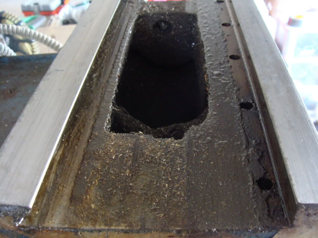

    Oh, and BTW, I wasn't dazzled by flaking and scraping once the parts were removed, but we'll see once I clean the gunk off. Also, I managed to drop the gib for the table and crack it clean in half It looks like I may be able to epoxy it back together and bolt back into place.....
    Having already had an imperfect day, treat yerself to a spot-clean with that bristle brush to clear a random area of that gunk. You'll either grin at a nice 'as original' finsih, or find it less so .... and be less worried about the gib as a major player.
    As to the gib itself? Neither epoxy nor welding.
    The pieces need to be kept from floating about, but they do not HAVE to be in tension whilst in-use.
    Give a thought to simply implementing a means to insure they can be positioned correctly, smooth the broken ends, and operate with a 'two piece' gib.

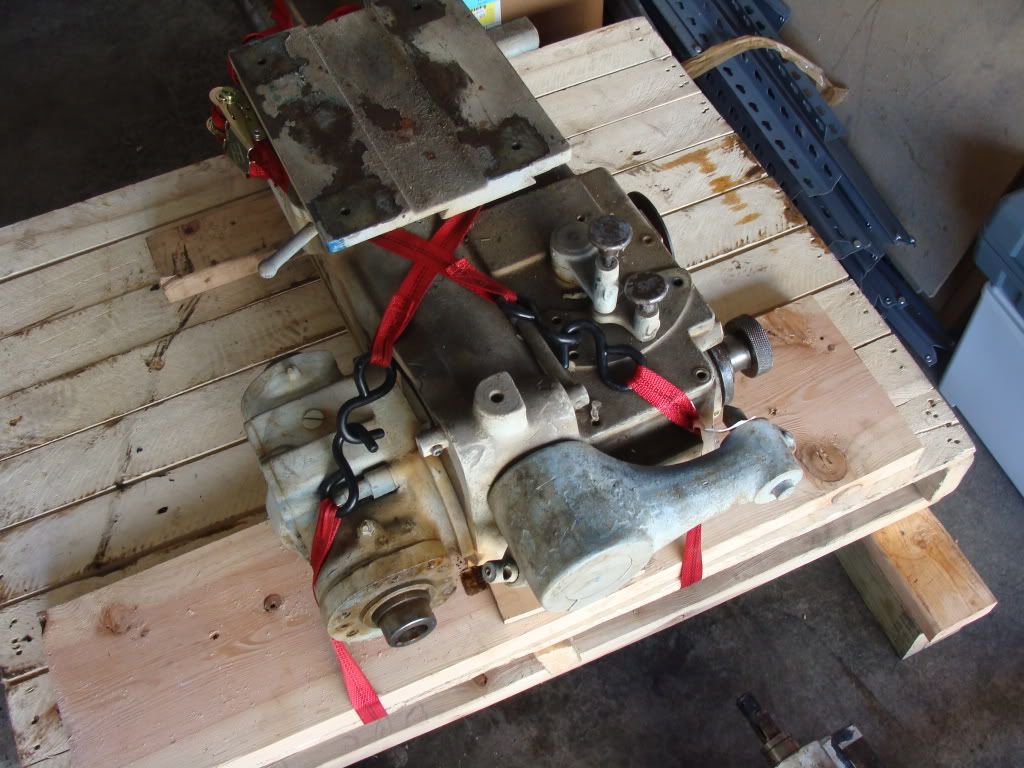

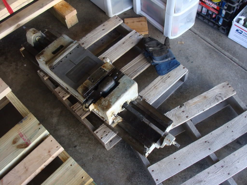

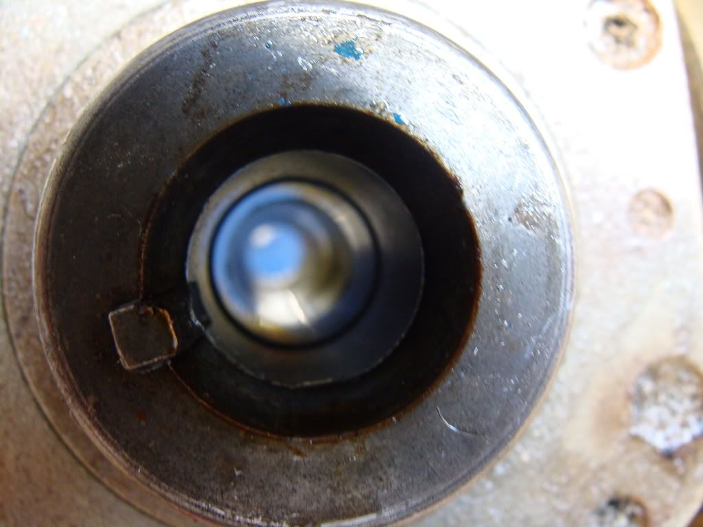

    Ok, so I managed to finally get the ram off. Like an idiot, I wasn't looking on the underside and didn't see the screws which held the gib....which was exactly what was holding things in place. I got the ram cozy on a skid of its own, and made a bigger pallet for the main column. Just gonna tip it on its side (with help) and lash it down. Here's some pics:

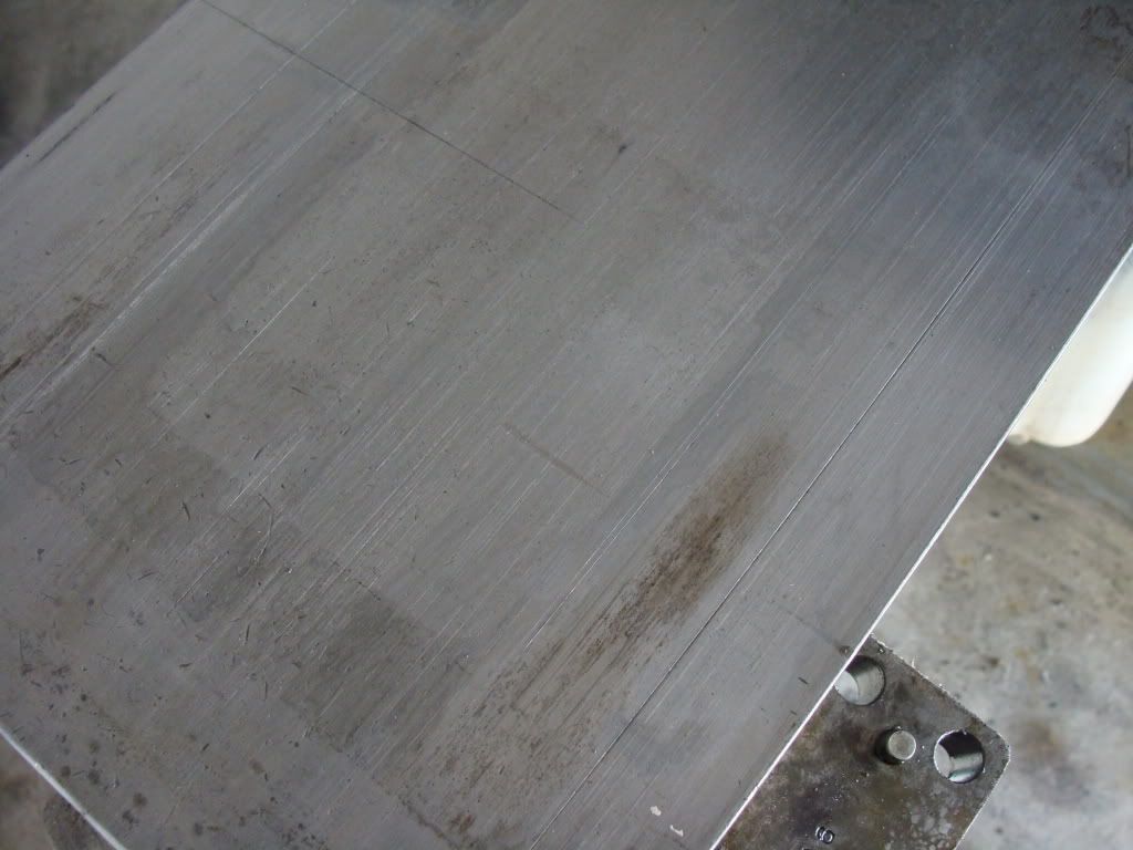

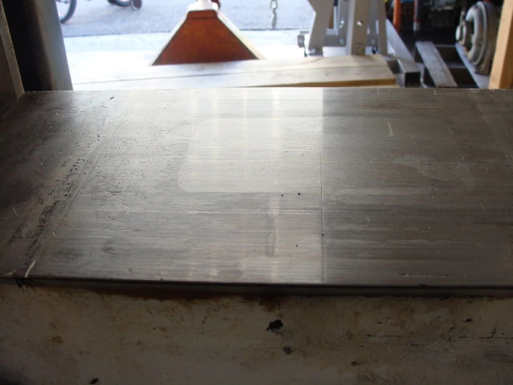

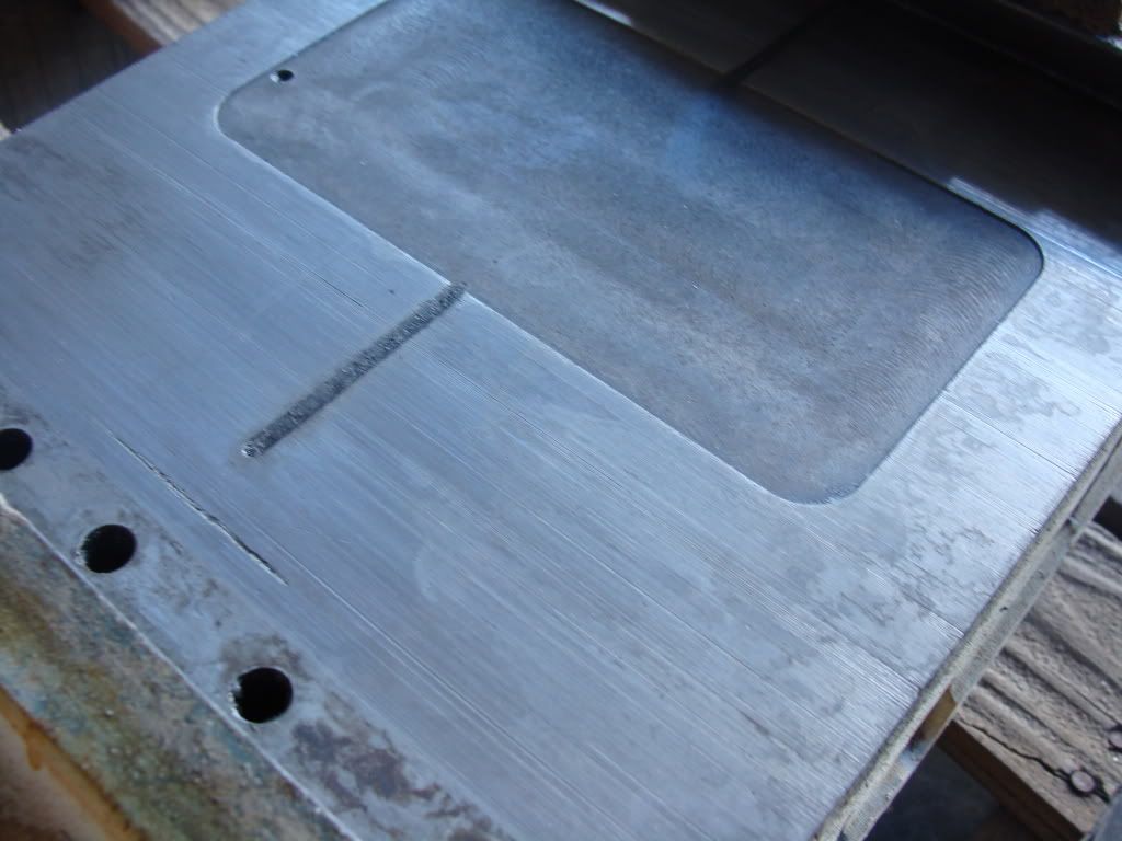

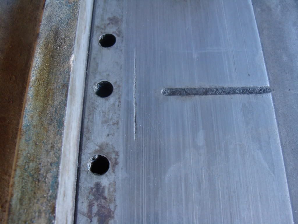

    I also did a bit more cleaning of the critical surfaces, just to see the wear. They don't look too great in my opinion. There's scoring, nicks, and zero scraping present...but I wonder if they came scraped in the first place. I'll let everyone else chime in, though.

    It's been used, but I'll bet a dollar to a donut it's at least as accurate as a brand new Bport copy. Again, put it together and see what it does, THEN decide if it needs reworking. Chances are it'll do anything you need for ordinary machine shop work.

    I've heard of people just lightly running a very fine whetstone and oil over the surface....maybe I'll do that to knock down some of the burrs, then commence the rest of the cleanup. Scraping in general doesn't intimidate me, it's the dovetails that look like they could be a problem.

    With it torn down like this you can make some basic assessments. Bear in mind I am not an expert. Take a good straight edge like a machinists square , and lay it across the bearing surfaces. Look for rocking, if you see a gap stick a feeler gauge in there and get some idea how much of a groove is worn. Also check to see how much lip there is between where the gib rides (original surface) and the wear areas.
    I would not recommend a stone on the surfaces, , one, you don't want abrasives in the iron, and two, you don't know how flat the stone is.
