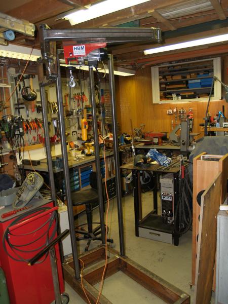

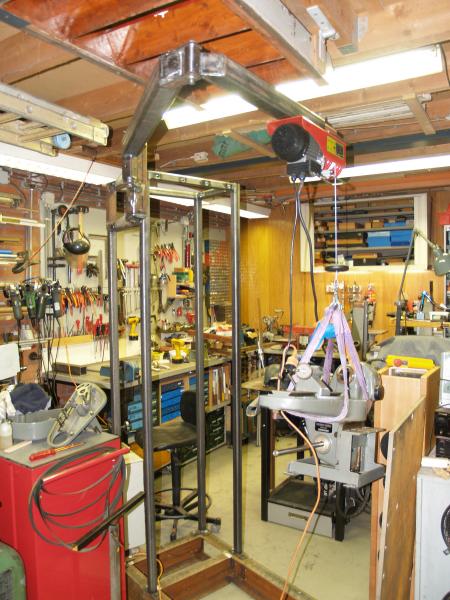

By shear coincidence I,m building a system like that right now.
Mine is freestanding and mounted on a pedastal that carries the mill (deckel fp2 about 1200 kg)
The iron baseplate that should be on top of the pedastal is standing upright at the right side of the picture.
At this moment it's disassembled for powdercoating. Here is a pic of the testing situation with the Deckel spiral milling attachment (about 100kg)
The motor is rated for 150 kg single hook and 300 kg with the cable doubled and a hook with roller.
The arm with the motor can shift out about 40 cm to reach even a little further.
The arm can fold against the studs in the back of the machine.
A fixed pole would be saver though, because I always have to watch the system to prevent tipping over when the arm is extended to one side with a heavy load attached. Although I did not actually test this. Maybe the weight of the deckel gives enough counterweight to even the heaviest loads. That will probably be the 100 kg of the spiralmilling attachment.

nice work. Does the FP2 sit on top of the rectangular frame that the verticals are attached to?
Nice test proof..the spiral milling attachment. Not sure i would have used that as a test...if it went bad might be costly. Would lean more to sand bags or the like for testing...but guess you were pretty confident as to the engineering.
Thanks for sharing that.

Indeed the deckel goes on a iron plate (about 1 " thick) on the rectangular U-beam frame., being raised about 160 mm.
That gives room underneath for a drawer.
Most pre eighties lathes and mills are a little to low for me, so the raising brings the worktable at a more convenient hight.
When the drawer is removed I can pick the whole unit up with a manual forklift, including the Deckel, electrical cabinet and hoistsystem
The very first test was with an 100kg item that was self regenerating in case of collision damage (myself)
More pics to follow when it's ready

Alan you must have read my mind. These are exactly the problems I am worried about.
With the manual chainsystem (I have a 3 ton for loading the machines) I don't like the tedious labour and even less the chains rattling against the side of the machine.
So I found this 79 euro steelcable hoist and would give it a try.
I planned to make an evaluation after I had tested the complete system, but the first tests indeed indicate the problems you mentioned.
The speed for the single line is to high and the start stop is to sudden.
Doubling the line gives better results. Only the hook that was supplied for this purpose does not have a pivot, so I have to modify that.
I already considered to swap the 220v single phase motor for a 3 phase one. It's a pity that the casting that couples it to the winchpart is a special one.
I would have to make a special adapterplate. After that I should be able to hook up a VFD and all start/stop/speed problems should be resolved.
Ross is right about the stiffnes of the frame. It is pretty bouncy but I don't know if this is a big problem.
An evaluation will follow in a few weeks.

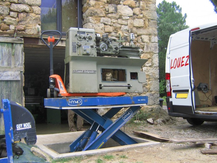

And I think lucky I was when I got that near new Demag hiost for approx. 200 euros including shipping from UK !
It has a 80kg (160 lbs) capacity, wich can easily be increased to 125 kg (250 lbs) just by tightening the clutch (a DEMAG tech explained me their hoists are just the same up to 250 kg capacity and the sole reason they are limited is to protect the equipment they are bolted on).
The hoist has two speeds and a pretty convenient hand control. Not too big, so you can still handle the load *and* the control pendant while pushing the buttons.
Of course, 125/150 kg is a pretty limited capacity, but the ceiling in my shop is sooooo low that I wouldn't allow the lifting of a machine, so I didn't need more.
My goal is to have something that won't take floor space and will be convenient and *fun* to use, for the loads light enough that you could be tempted to handle them on your own... but just heavy enough to destroy your back !
For the whole machines, I have a small pallet jack and and a lifting table in front of the shop door. It has a 3 tons capacity and has prooved a very efficient tool : No space in the shop or separate building required, no tires to puncture, no battery to charge, in fact : maintenance free !
You will barely notice it when not in use, and it makes a wonderful outdoor bench when weather allows. Definitely a "must have" !
