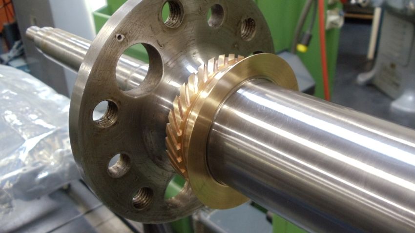

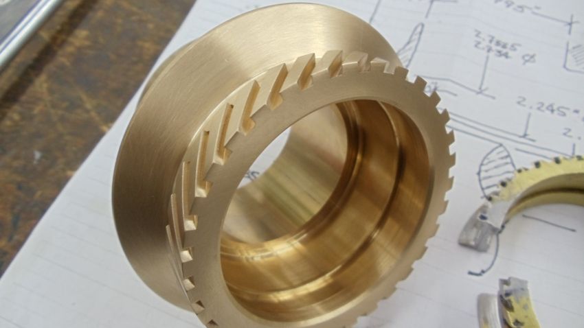

    Doing some lower end work on an old car engine. Shop is working on a 1913/14 Turcat-Mery and the job includes a complete rebuild of the engine.
    My involvement centers on the lower end...new main bearings (bronze shells with babbit) and rework of the cam bearings....
    The rear oil seal for the crank consists of a pair of brass shells machined with helical grooves that run in a close fitting bore in the crankcase and sump. The originals were in rough shape and after the line boring of the mains and truing
    of the slinger bore a new better fitting slinger was required.

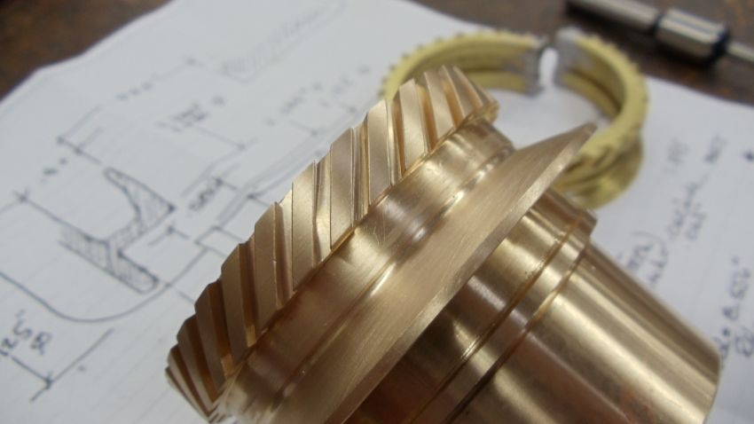

    The part is made in two halfs to allow fitting to the crank forward of the rear flywheel flange. (i have never seen it done this way before, but the part and crank are original)
    There are some features on the IDS of the slinger halfs....there is a notch bored into the ID that registers on a like shoulder on the crank.

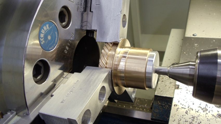

    Started out by blanking the material out on the lathe...well oversize on the OD and under on the ID..... Once blanked out the stock is removed from the lathe and cut into two halfs on the mill using a slitting saw.
    The halfs are then surfaced...via fly cutter to make the parting line surfaces flat and both halfs the same height. The two shells are then lapped on a flat surface using 320 w/d paper.
    The parting surfaces are then tinned and soldered together using soft solder ..(the stuff with tin and lead..not that water pipe sweating crap)

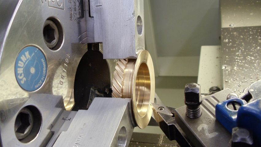

    Once joined the parts are returned to the lathe and the ID and OD finished out. For this job i left an extended section at one end of the part to allow gripping when it came time to do the grooves.
    For turning i find using the 6 jaw works well to hold the soldered shells...they are not round and by gripping with the parting lines orientated between a pair of jaws you get good enough grip to turn the ID.
    Once the ID is done, fitting up on a spud in the bore at the chuck end and squeezing against the opposite face with a disc having a center hole using the tail stock live center, one can turn the OD without
    too much trouble. Care must be used here to not clamp or work the part too hard for danger of the solder failing and the halfs coming apart and out of the machine.
    Using a 4 jaw or a three jaw with soft jaws bored to the part size also works....

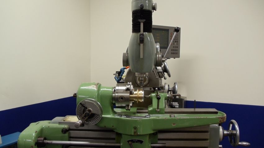

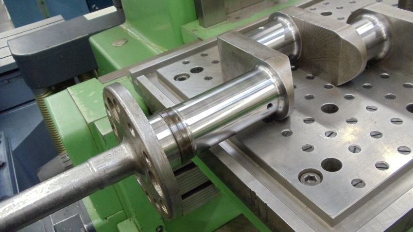

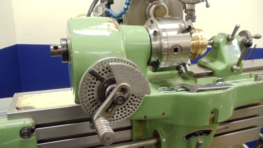

    For the grooves, i went old school and enlisted the use of my first gen FP2, fitted up with the spiral milling attachment and the precision boring head.
    Here the part is mounted using a 4 jaw chuck and supported via the tail stock on the attachment.
    The had is set to index 32 teeth and using the original as a model i setup the gearbox to produce a lead of 8" (original setup was a bit different at 8.8' lead, but that was as close as i could get without making some gears, and i deemed it "not critical")
    Part was touched off and moved to get the spindle on center. I choose to run the the precision boring head as it increases the output RPM...I needed to run a small end mill (5/64") and I wished to get the spindle running as fast as possible.
    The step up on the precision boring head is 1:3.15 so an input of 2000RPM will give 6300 out. A selected spindle speed of 1600 gave just over 5000 RPM at the tool. (the max continuous speed called in the manual is 5000 for that head)
    More to follow
    Cheers Ross

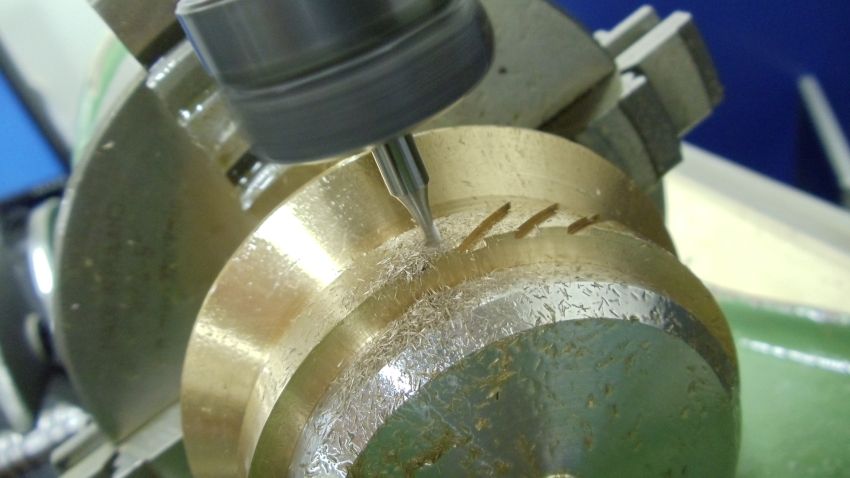

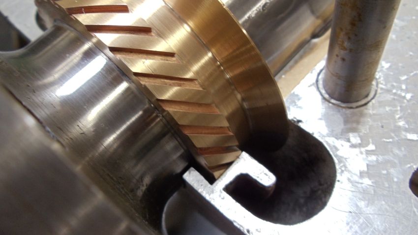

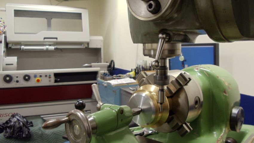

    Another view of the dividing head setup....Also note the spiral attachment is set to cut a right hand helix...Would not do to get that wrong!
    The cutting begins. Some notes. I needed to hold a 3/16" tool body and i did not have a standard 40 collet to do that. I uses a straight shank (3/4") ER16 holder gripped in a Deckel collet.
    This allowed some extension to get clearance for the spindle and the chuck jaws on the dividing head.
    Also i ran this job in one direction only...feeding from right to left as you face the work. Another advantage of the precision boring head. At the end of cut i could withdraw the spindle for work clearance and move back to begin a fresh cut
    after indexing. I used the factory depth setting or limiting feature on the boring head to give a positive depth return.
    Also it is necessary to start your cut away from the part to allow the slack of the gear train to be accounted for.....

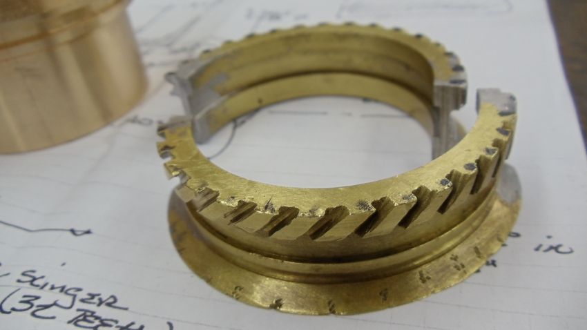

    At completion of two passes for depth the part is removed. I made this from 660 bronze and cut the slots dry, using a vacuum to collect the swarf.
    Note the extension on the part , and if you look carefully at about 5:00 you can see the seam where the two half were soldered together.

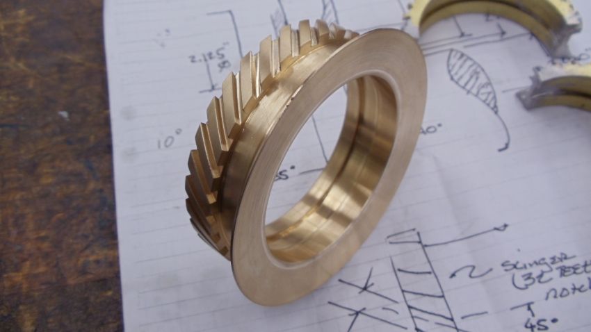

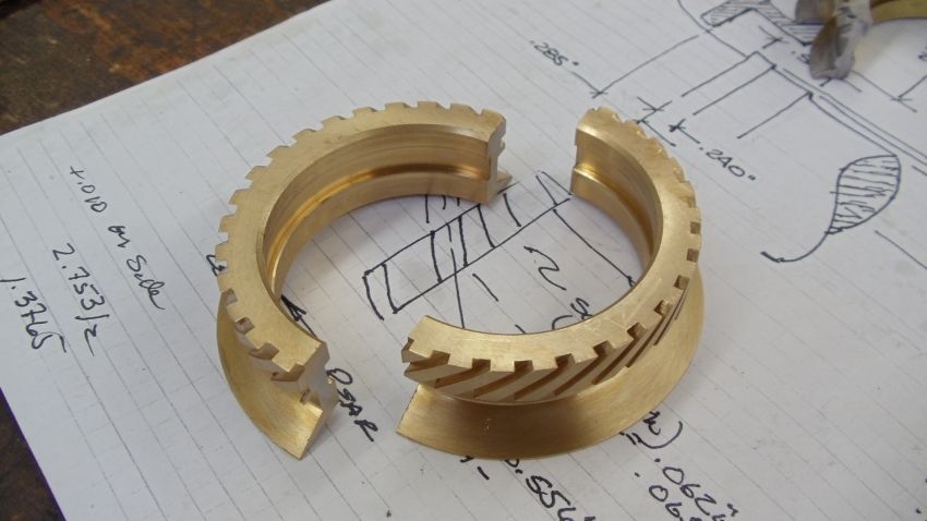

    Final operation was to re-chuck the part and remove the extra portion that was used to grip the slinger while on the spiral milling attachment.
    Use of the soft jaws here gives good support on a small grip length...note use here of support.
    Part was cut almost free then i used a hacksaw to finish...Did not wish any extra force to be used here.
    Finishing the back of the slinger ring after extension is off....
    Slinger ready for the next step...
    A bit of heat and the two halfs are free of each other (for awhile only) Two half circles mated and matched!
    Now it just needs to be fitted to the crank, and finished on the OD for the correct fit to the case........

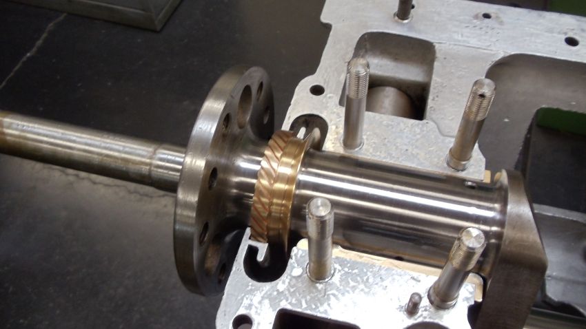

    Final work on the slinger:
    Halfs are fitted to the crank and soft soldered in place. (crank is steel...!)
    Crank with slinger is then chucked in a lathe and dialed up to run true (the crank) .
    The OD of the slinger is then finished turned to give the proper running fit to the case bore....the slinger ring (disc) is also trued up.

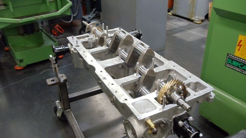

    Crank mocked up in case to check fit and front to back clearances of teh slinger.
    The big picture.
    Cheers Ross

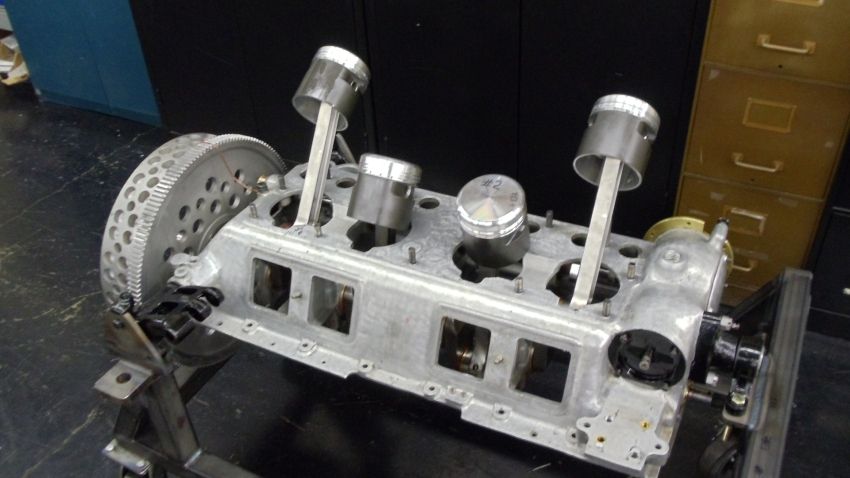

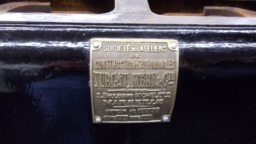

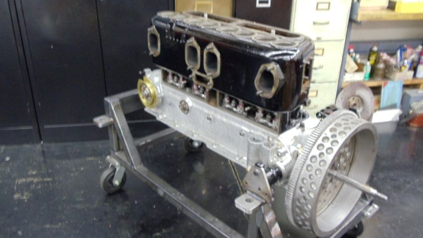

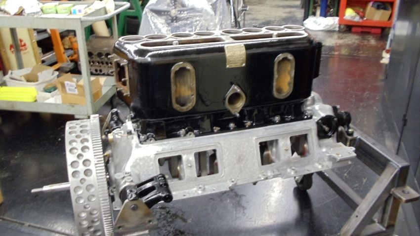

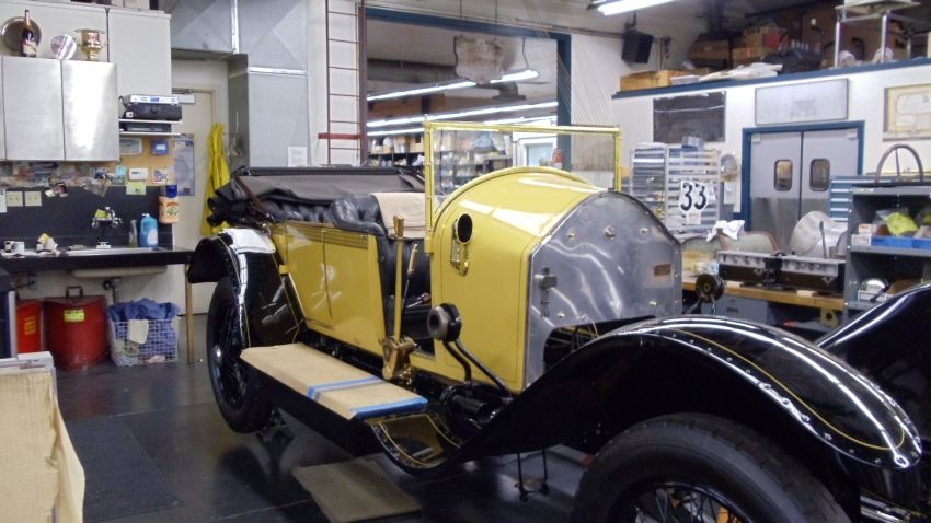

    That car and the one i am working on are the only two known surviving large Turcat-Merv's.....Might be others somewhere but the car world ,to the best of my knowledge, has never seen any others....
    Because we are talking about teh car, thought some might like a few shots of the car and engine going together.
    Some basic engine data......
    Bore:112.27mm (4.420")
    Stroke: 160mm (6.2992")
    Displacement aprox....6.4 liters (4 cylinders)
    Cheers Ross

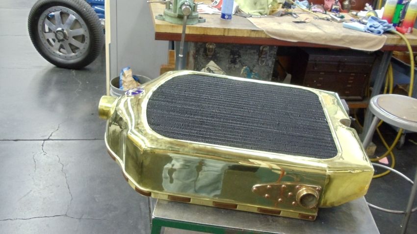

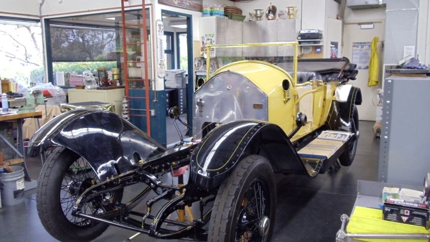

    And the car.....................
    Lots of bright work on this car....would keep "your man" busy polishing all that brass.....
    Cheers Ross

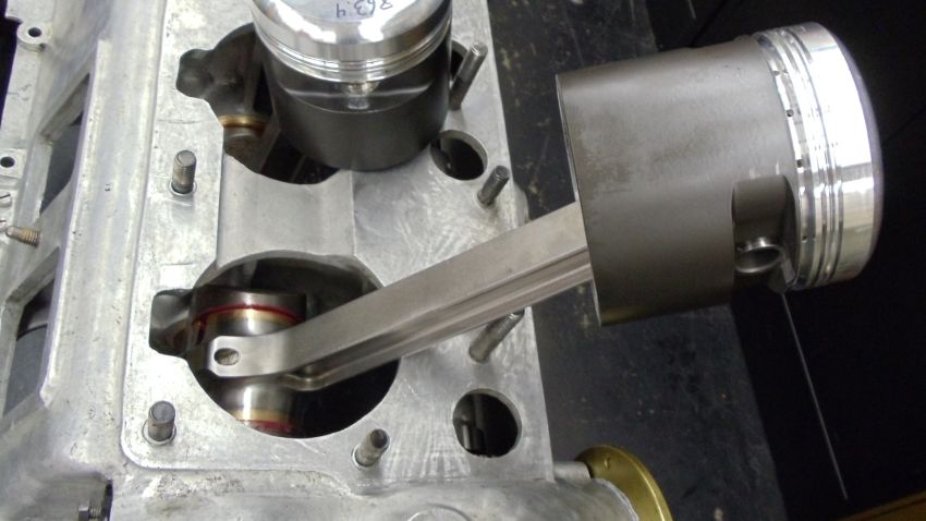

    are the pistons and conn rods original?
    is the drilled flywheel original?
