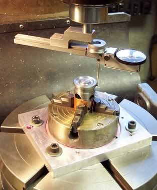

    Here is a tool I built to center things in my mill. As all of you who have tried to center stuff with a dial test indicator, the danged thing is backwards part of the time and it is easy to lose track of which way the needle is moving if you use a mirror. This device holds the test indicator horizontal so it is visible and allows fine adjustment. It is based on one described in Machinist's Workshop Magazine by Glenn L. Wilson, but significantly modified by me. My mods include the dovetail slide and the fine adjustment.
    The above pic shows it in use centering a piece in a chuck on my rotary table. Below is the right hand side showing the tool up close. The head fits in a half inch collet and has a female dovetail with gib to lock the sliding male dovetail in place. You can see that the dial test indicator is held by a small block attached to the sliding dovetail with a thin piece of steel which serves as a spring hinge. Major adjustment is by the sliding dovetail. Fine adjustment is by the large adjustment wheel on the block that holds the indicator. It has a cam surface which rubs against the end of the dovetail piece and slightly bends the spring hinge for fine adjustment.
    The pic below shows the other side of the device with the dovetail clamp to hold the test indicator.
    Yes, I know I could just go buy a co-ax indicator, but this was free, fun, and educational. I learned to measure dovetails in the process, as well as threads by the three wire method, and the design and construction phases were both enjoyable. Retirement sure is nice!

    However, I heard a rumor that may or may not be true...The rumor is that a test indicator with more than 30 degrees of flex on the needle is exponentially inaccurate past those 30 degrees. I see yours at damn near 90 degrees.

    Rugby, I think the problem is with the indicator tip at an angle of more than 30 degrees to the surface being indicated. As shown, the indicator and the dro are in agreement when I move the table.

    How large of swing will it sweep? Have you used it to check tram (I'm guessing you could bu using the back dovetail on the DTI)?

    Jon, as set up, it swings about 5 1/2 inches, but with the slide reversed it would swing 10 inches. It could be used as you suggest to tram the mill head, the only drawback being that the indicator dial would be vertical and I would be back to misreading the indicator with a mirror on the back side. Hmmm, now that you mention it, an accessory could be an adapter to hold the indicator horizontal by the back dovetail. If you will excuse me, I gotta go back to the shop now. [img]smile.gif[/img]

    Concerning tramming; I think you could adjust the indicator spindle to a "flatter" angle(45 degree or so) to contact the table. The inaccuracy from the spindle being at an angle shouldn't matter, as you would only be looking for the same reading in the different positions; not the amount of movement.
    For my use, I would consider making the holding spindle a stepped design; 3/8" and 1/2", as those are the collet sizes that I use most.
