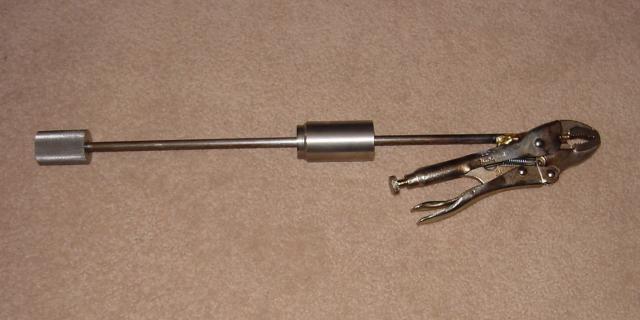

    I have another stupid question! I cannot remove two roll pins (also called spring pins) from a casting.
    The casting weighs about 250 lbs (cast iron), and the roll pins protrude about 1-3/8" from the side. They are 3/8" in diameter and about 2-1/2" long - too hefty for a wimp like me to remove, apparently! I have tried a vise and visegrips to compress them without luck. Don't think heat/cold will work. My old auto body puller will not grip them tight enough. Cannot get at them from the back - in blind holes.
    Can they be drilled out? Is there a better way? They need to come out so I can remove bolts to a sub-assembly. They are super hard and in there tight!

    Make a 1/2-13 slide hammer. Use the 1/2-13 on a pair of Vise grips instead of the knurled screw. Clamp the Vise grips on the pin and reverse knock them out.

    They are in blind holes guys.Take a die grinder or a dremel and grind a notch in the pin. Then put a peice of threaded rod a couple of feet long in the adjusting screw hole of a pair of vise grips.Clamp the pin with the vise grips, capturing the notch.Slide a peice of bar stock over the rod,put on a nut and slap hammer it out.

    It only takes a few minutes to make one of these:
    (That's a bitty 6" vise-grip I didn't have a lot of real use for).

    I have made some fixtures to pull dowel pins, with an OTC slide hammer. I take a piece of 1 1/4 round stock, drill & tap to fit the shank of the slide hammer. Then, on the other end, I bore or ream to just fit the offending pin. then drill & tap 2 or more holes to use SHCS's on the side.. use at least 2 , at 90 degrees apart, 4 is better. Use Socket heads,you can tighten them better than set screws.. Put it on the pin, & tighten, then take it off & grind a small place , where the screws can bite in.. Put it back on & start pulling... Every few strokes, re-tighten the screws...
    Impact is amazing, what it can do... a few years ago, a job was brought to me, a slide was stuck in a die. The next choice was to EDM the entire slide out, & remake it..I built a jig to grab it, so I could hook it to a slide hammer. After a day of using the slide hammer, I got it loose... That job paid very well.. [img]smile.gif[/img]

    If the roll pin is protruding (I think it is) you could also braze or weld your slide hammer shaft to the pin, after you get the first one out, cut off and re-attach to the other one.
