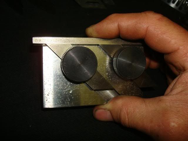

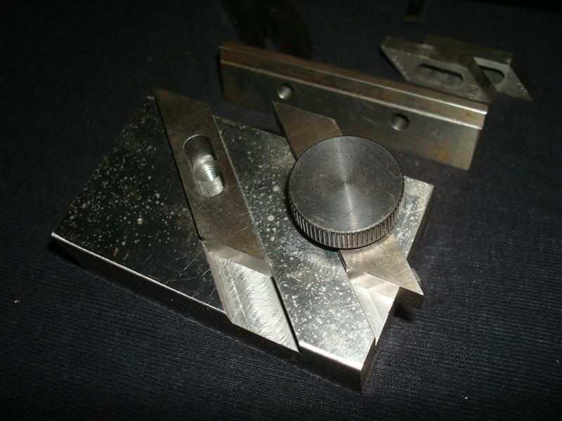

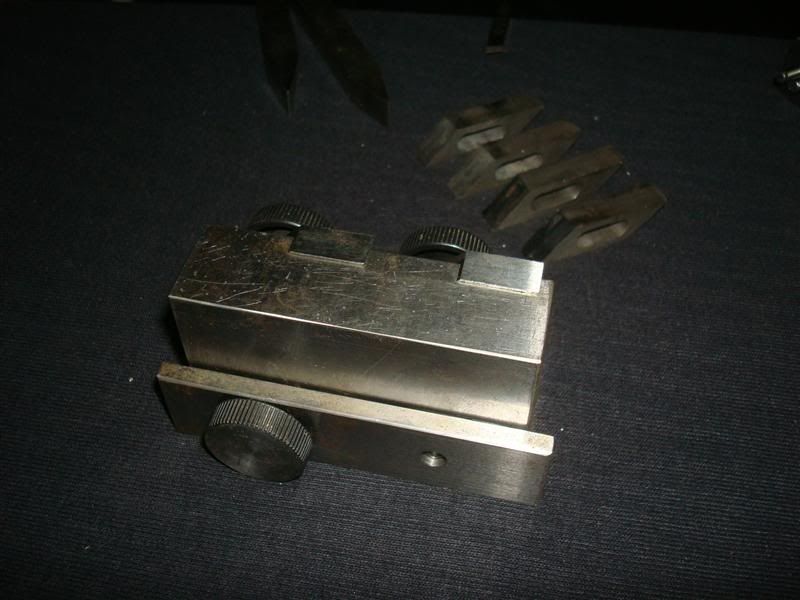

    If the Vertical is a DoAll:
    Check the Blade Guides, upper and lower. If the guides are not dead flat on the contacting surface the blade will wander after it wears.
    I made a regrind fixture and new guides for the shops DoAll to keep the guides up to snuff.
    The guides upper and lower need to be parallel. Readajust as needed so the blade does not have an induced deflection.
    Look at the back-up bearing, the one the blade butts up against when the cut starts. Is it in good shape and is the 'cap' in good shape without grooves or a high shoulder?
    Horizontal saws depend upon the guide roller bearings. The bearings must not be worn so that there is a drag on one side of the blade or the other. Like the guides in a vertical DoAll, the guide bearings must not induce a twist or deflection in the blade.
    Are you getting a square cut with your parts? If the fixed jaw is not out of square then the bearings are not adjusted correctly.

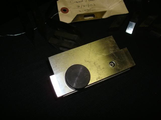

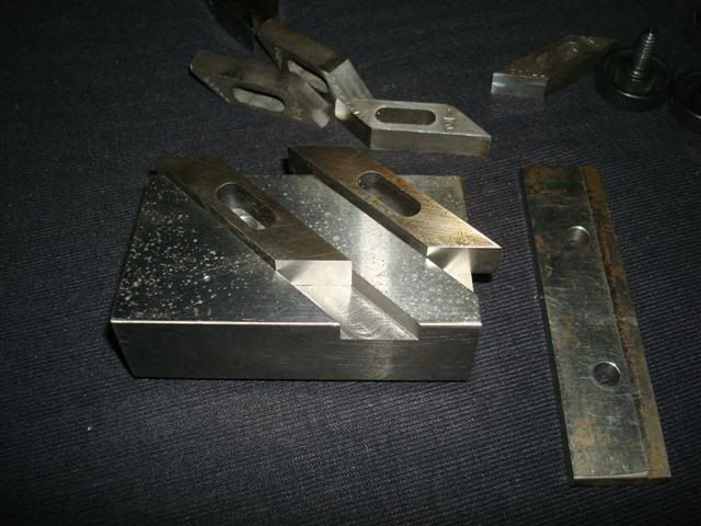

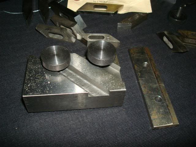

    A fixture I made for grinding DoAll blade guides. I also made new guides out of 4140 and hardened them.
    John
