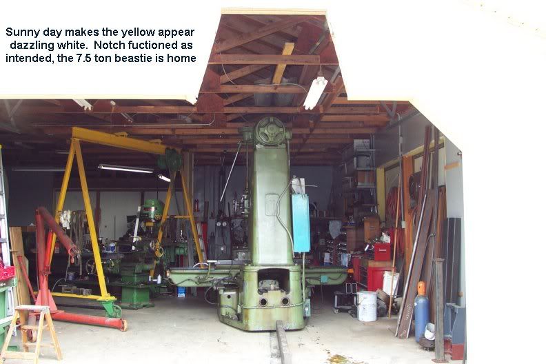

    I like my upright "As". Easy, sturdy. I supplement these with diagonal braces to near center of beam, on spreaders at top so chainfall can pass.
    Yellow gantry in photo on left.
    http://img.photobucket.com/albums/v3...e/DCP_0497.jpg

    Thanks, John. The "A" design seems to be another popular one, and as you say, it's easy and sturdy. I've added it to my short list.
