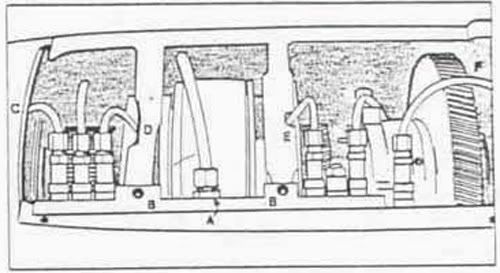

    The ways are hardened on the 1024.
    Make sure it has nice new felts on the front and rear of saddle...this will go a long way to preserving the ways.
    You talk about lubing the ways ...
    way lubing is automatic on all 1024s ...
    there is a pump inside the apron that does it.
    There is also a sight glass on the apron ...you keep the apron topped on to the level in the sight glass and the oiling is taken care of by the pump.
    Oil is pumped out under the saddle ...and the felts keep it confined to that area....if you see it all over the ways in quantity ...then new felts are needed.
    The top slide is also oiled by the pump ...no felts on this though ..may need a wipe now and again.
    The excess oil from the saddle dribbles over the rack ...this needs wiping now and again as well.
    What I would worry about is the oiling to the head .
    Take the top plate off and observe , if oil is coming out of each oiler .
    if one or two are not oiling ...there is no way to clean them out ...new ones (the Little filter units) are the only way to go.
    There is also an oil filter around the back........the old round head oil filters are not available ...but the 1024 vsl ones are .
    if you have the old round head one...
    Filters can be cleaned ... sort-of, by soaking in kerosene ...then using a wet/dry vac to suck them dry ...keep repeating until kerosene comes out clean
    The bi-pass valve for the oil filter can stick ...stopping oil getting to the head.
    disassemble and free up...if so
