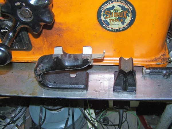

    I have the exact same valve grinder sitting in my shop. There is a fixture that bolts to the stud sticking up from the table in front of the chuck in your pic. I'll try and snap a pic or two of my machine today for you. I do not have any info on the machine though.
    Looks like your machine also only has one wheel? Mine has a wheel on both ends of the spindle. One side for truing valves and the other end for stem work and grinding rocker arms. I bought mine from the original owner and came complete with all the extra fixturing. If I recall I have the original bill of sale somewhere, I'll see if I can get a date of sale to give you an idea how old it actually is.

    your machine is the wet cut version of the dry cut i have. but it takes the same dresser as yours. it bolts on the stud that is front of the chuck also there is another attchment that uses that stud and the raised alinment bar for but grinding valves.
    don't worry about the age i have been using mine for over 10 years to do comp valve jobs.
    the sioux valve grinders are about like s-b lathes as long as they are all there and run they will make good parts.
    if you want i will try to get you some pics of both attchments on the grinder.

    Here is a few pics of my grinder
    Right side
    Left side
    Extra fixtures for grinding
    Grinder overall
    Should give you a good idea after seeing the pics.

    burcepts beat me to it. the one is the dresser that i have and in the other pic the one on the left is what i use to butt grind the ends of the valves.
    the 1deg interfearanc fit is so the valves seat real quick covers up a lot of mistakes in doing the seats. they just beat in real fast. you want the valve face and the seat to be the same angle.
    check the deg markings on the macgine but don't trust valves to do it. don't even trust new valves. even grind new valves some are way off. using an old valve to set up with is not a good idea. how do you know it is right and if it is good why regrind it?
