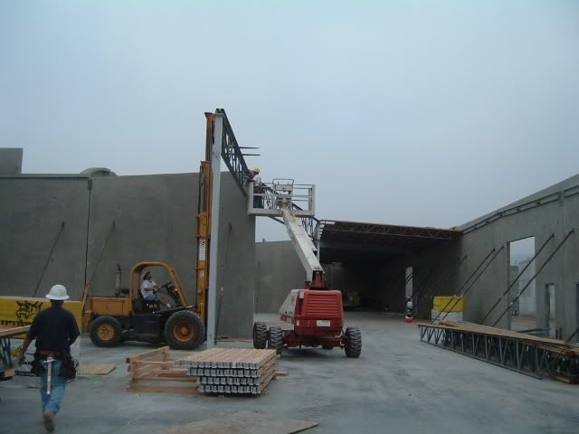

    "full 2" x 12" joist that are tripled up and 12" OC with an 11' span," is a ferocious joisting schedule! Was the building originally built to store Steinway Concert Grand harps*? (*the great iron casting that all the strings of a piano are tensioned over.)
    100 years ago and more, it was common to build manufacturing facilities several stories high, with machine tools near the top on wooden floors. The machined parts then trickled down through proccess to finished product and out the ground floor door and commonly some of the machines out-weighed that dainty Bridgeport, while sometimes the floor beneath the machines supported thousands of pounds of line shafting and cast iron pulleys with many leather belts tensioning it downward to second op machines below.
    Providing that the structure is sound, I wouldn't even crack a structural table, just move it in.
    String over the floor from support girder to support girder, right in front of where you intend to set the mill and fit a little wood gage, X marks the spot. Move in the Bridgeport, restring and if there is over an 1/8" of daylight over the gage, I'll come over and help you shore it. Rest assured that it would take far more than an 1/8" deflection to seriously stress that construct. I'd use a bit oversized 3/4", (actually, I'd use 1/2") steel plate to spread concentrated leveling points and no, those little Bridgy leveling screws will not bend down ear's on that 3/4" plate.
    Licenced General Contractor since 1972, (now retired, license on inactive status) and quite impressed with your floor.
    Bob
    PS, we'll use some of the great techniques above if I'm wrong.
    One of my later projects, (winding down as General Superintendent) over 200,000 sq. ft. in 7 buildings, (2 more of them visable in large opening on right) of this:
    Didn't even wince as the crane lowered the large HVAC units onto those flimsy bar joists.
