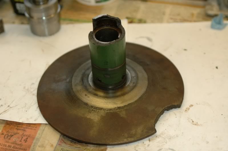

    Consider also that your reeves drive MIGHT have been 60% efficient at best. You'll gain a lot just from the switch to poly-vee (or Micro-v as Gates calls them). Log onto the Gates website and download their V belt design guide. It has masses of tables so you can calculate exactly what you need. They also have their "Design Pro" software that will do all the calculations for you.
    Vehicles are typically L or K, which is a lot heavier. I've made many J section pulleys. Assuming decent pulley wrap, one J rib is good for about 1.6hp max under nominal conditions. This is down-rated as speed falls. On vfd with a 1750rpm 3hp motor, and two identical 4.0 inch PD pulleys I use 6 rib J section down to a 400 or so RPM. I can get away with this on a vfd as hp falls with speed (assuming constant input voltage); at 400 rpm I get maybe 0.7 hp.
    6 and 10 rib belts are easy to find. Without knowing more about your design (like the diameter of the motor pulley and or the service factor of the motor), I'd say 10 rib will work fine.
    Poly-vee sheaves are difficult to find in some sizes. Sure, they are listed in catalogs, but ask for availability and you often get told 8-10 weeks. I needed a poly-vee with an internal bore of 1.75 inches, compression type mount (for going over an existing suspect surface) and a pitch diameter of 4-6 inches. Nothing available. So.. I made my own J section the easy way. Buy a QT SDS (or whatever) bushed A/B belt sheeve, turn off the V-belt metal and add on the Poly-vee grooves. A 5.0 PD B belt sheave will turn down nicely to a 4.0 PD Poly-vee. I can convert B to 6 groove poly-vee in maybe 10 minutes max. If you need more than 6 ribs, machine down a 2 belt B sheave.
    Reeves sheave shot? Turn it into a poly-vee. This is from a Clausing 6913 lathe. The busted sheave turns down nicely to a 3.4 PD J-section poly-vee. For the sharp eyes : It's a tiny bit under spec on the shoulder width but I'm not concerned as it's cast iron and has a tapered face from the old sheeve. Next time it will be 3.25 PD!
