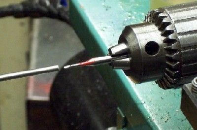

    I'm tapping some 0-80 holes in 17-4 SS. I would like to make what I would call a "Floating taphead".
    I want to avoid the 0-80 tap pulling or pushing my lathe tailstock. What I would like to do is start the tap
    with spring pressure and retract the tap with spring pressure also. The lathe tailstock will simply keep the
    tap from rotating.
    Seems like I saw a setup like this for CNC mill tapping. Does this item have a name? Is it possible to make one of these?
    Need some design ideas. I'm afraid I'm going to be engineering this thing in my sleep tonight unless I find a solution before bedtime.
    Thanks, Jim

    The chuck arbor has a 3/8 bored hole. The chuck is free to both rotate and slide left and right. Plenty of left and right travel. My hand grip will start the thread, hold the tap and retract the tap when done. Probably should of made one of these years ago.
    Below is a picture showing the chuck. Years ago a friend gave me the old Jacob #8 chuck. I rebuilt the chuck and replaced the jaws then never used it. Now I'll put the old chuck to good use.
    Larger picture
    Now I'm ready to tap some 0-80 holes. Thanks Jim

    Default Floating taphead works great
    Using the floating tap from Gordon Long works fantastic. I tapped (25) 0-80 holes using the same tap.
    Thanks for all the great ideas.
    Video of tap head working.
    Opposite end 4-40 spiral flute tap
    Jim
