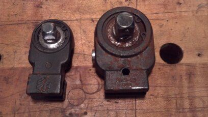

    Example of Evaporust. I suppose that washing soda and a battery charger would work, too.
    Two heads for a Sturtevant-Richmont torque wrench. I dissassembled, cleaned, and then used Evaporust. Soaked for about an hour, wiped off with the omnipresent "blue paper towels". You get a lot of black crud, which I believe is FeO, or ferrous oxide (rust is ferric oxide, Fe2O3, and related hydrates of same). The FeO wipes off readily with a towel, although I did use a wire brush to get some of it off. Pretty easy.
    Greased the head with moly-d grease, reassembled. The Sturtevant Richmont folks seem to be pretty expert in torque-related products. www.srtorque.com.
