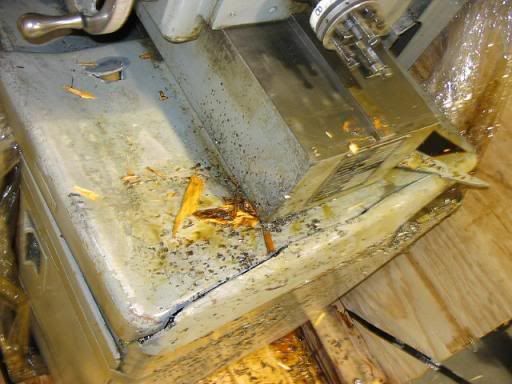

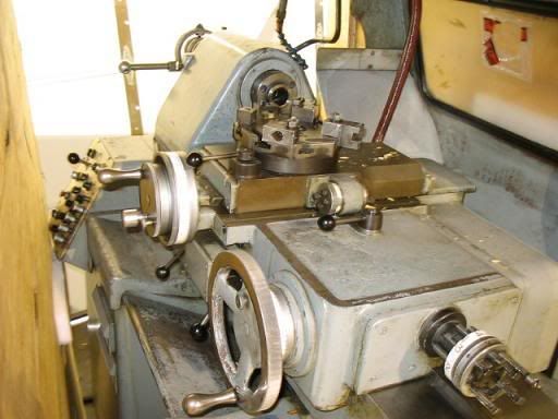

    Quote Originally Posted by exkenna View Post
    Matt,
    Do tell how this turned out..
    Exkenna, mostly a lot of yelling at the brain-dead people running the forklifts. First, they wanted to send it back (return it) and presumably let the sender deal with the damage. Of course I had prepaid, etc, I owned it...took awhile to get that concept clear that there was nobody to return it to.
    Next they wanted to pickup the downed side with the forklift and dump it back the other way onto its base. Another round of dope slaps.
    Finally they admitted that their "long fork" forklift (the one they supposedly went to get and I failed to notice had these miniscule forks on it) was down for the count and they didn't say anything about it....brought the crate down the ramp that way under enough back tilt and driving in reverse and did not mention this important detail.
    Everyone wanted to know what was in there...and you see the futility of trying to explain a high-end turret/collet lathe to people having trouble with the above issues. I tried to simplify to an aerospace quality machine no longer manufactured. I should have told them nuclear waste or something that probably would have got me in trouble
    I got my .10/lb check eventually. $230.
    I think the machine is going to be OK, amazingly enough. Most of the damage is to this beautiful aluminum chip and coolant collection pan that "surrounds" the rear pedestal that the lathe bed mounts to. Its basically like a cast piece of aluminum "flashing", however does not actually touch the mounting pedestal. And the rear chip and splash shield sustained a little damage, it was the part sticking thru the top of the crate.
    Dope slap also to the guy who crated it, I specifically asked for the machine to be thru-bolted to the skid. He agreed to this, giving me assurances of how he'd been doing this a long time (it was the sole intent of his business!), then used a couple of 3/4" steel bands...both of which broke...
    Miraculously, none of the handwheels or spindle-end or the lever-closer was touched as far as I can tell. Everything turns smoothly without bind.
    So, back to the OP, you see why my thought process is a little poisoned. You can ship stuff via truck. Its never as cheap as you think, you need to take lots of precautions with the crating, leave plenty of airspace in there, the forklift jockeys have been known to impale crates with reckless abandon (go to a truck terminal sometime....every time I've been I feared for my life due to the incredible speeds the guys run seemingly thru a tight maze of pallets and crates). Buy full value insurance and be prepared to fight if you need to make a claim, things are very slanted in the direction of the truck company (IOW Not in your favor). There are "tell tales" you can buy...simple little ball-bearing in a clear plastic case that rolls out of its "home" if the thing has been overturned and then re-righted without your knowledge. Also...note to forklift purchasers, avoid those with the very very short "4 foot tall" mast as those are likely truck unloaders, or really any lift that's known to come from a truck terminal. It's been run wide open forward and reverse literally 24 hours a day.
