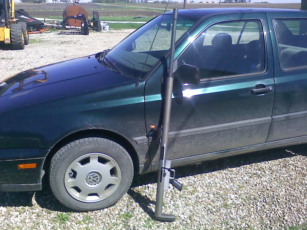

    Here is my little project, it is an 8 ga. slug gun built to fire the Remington Industrial shells.
    36 in. 20 mm. vulcan barrel, gain twist
    22 lbs
    bolt action, single shot

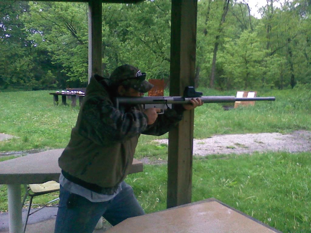

    It has four lugs in the rear set up like a rem788.
    With a red dot it will keep 5 shots in 6" at 100yds, (until it shook the first one to pieces). I would assume better performance from a scope but the dot is perfectly adequate for milk jugs..

    Nice build. Those 4 lugs will hold any pressure you'd want in
    the heavy kiln cases or brass cases. That is tremendous
    accuracy from those hopped up kiln loads. They will have
    over 11,000 ft lbs in that long a barrel. That action tube extension
    back to the thick buttpad is betterlooking than most.Ed
