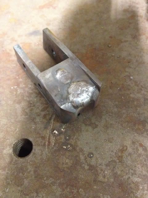

    does anyone have pictures of a rebushed firing pin.

    When properly done, there is nothing to see, it looks just like a normal bolt face. The hole is just slightly smaller and round like new.

    Not a martini but a highwall rimfire converted to centerfire....may give you some ideas

    That's about the size of it, and once its final polished to #600 no one will know its been messed with. Nuff said !

    [QUOTE=ndh78;1849657]Not a martini but a highwall rimfire converted to centerfire....may give you some ideas
    Nicely done, but that is a welded breechblock, not a bushed one. It is OK for a low pressure round, but when going to a higher pressure round, the Mann-Neidner firing pin modification is recommended. This involves boring and drilling the face of the breechblock to install a flanged firing pin. The firing pin is retained with a bushing in the face of the breechblock. The purpose of this modification is to prevent gasses and potentially the firing pin being ejected into the shooter's face in the event of a ruptured case or pierced primer.
    When a rimfire high or low wall breech block has been modified to center fire, the top of the breechblock must be drilled for the vent hole found on centerfire breechblocks.
    Rather than welding the firng pin, it is simpler to face it square, drill and loc-tite or soft solder in a piece of drill rod or music wire of the proper diameter. This way, when the pin breaks, repair is much simpler.

    I am fully aware of how the Mann-Neidner conversion is done and I don't think it is necessary, the welded firing pin tip is simply an experiment to see how it works I welded it with 4140 filler and will harden and temper it. I am also aware the block needs a vent hole and it will get one. Most problems occur because people try to use original blocks with worn holes and pins, a tight fitting small diameter pin should not have any problems.

    Actually ndh78 if you pack the sides in toilet paper soaked with salt water and work fast with the TIG there is no reason to re-heat treat it. You can have it Rockwell tested if you want, but all that will happen is that you will create a hard or soft spot about 1/32 of an inch deep and slightly larger than the size of the puddle in diameter. Often the weld area is within a point of the rest of the bolt. I have been down that road many times. Done quickly the TIG is extremely localized heat. I have a friend with a Rockwell tester at work and we abused the hell out of it learning this. Things have changed a bit in the last 30 years since guys like De Hass were burning the snot out of parts with acetylene torches and buzz boxs.
