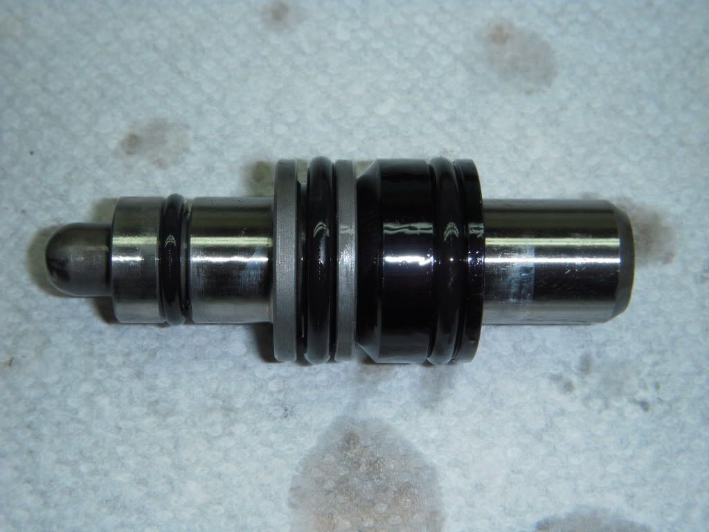

    Quote Originally Posted by moparmuscl View Post
    I got all the o-rings changed out tonight on the shot pin piston assembly, gear shifter piston assembly, and the tools release piston assembly. Everything went really smoothly in general until the tool release piston. All o-rings fit great and were the correct size. Everything seemed to be in good shape except for the o-rings that I pulled off. They were mostly all flattened and semi-hard. A couple were even brittle. I'm glad I went the extra step and switched these out. I used air tool oil to lube everything when it went back together, so hopefully that will work fine. The last thing was the tool release piston. I got it apart, cleaned up, and almost back together when I slipped putting the snap ring in. I overshot the groove and nicked the piston bore. I would estimate it was .008-.010" deep. I started with 400 grit sandpaper and worked my was up to 2000 until I had worked the nick out. I'm glad I bought extra o-rings for everything, because I didn't want to take a chance of the first one being slightly cut. I tested to piston with ~50 psi and it didn't leak, so I'm happy with the repair.
    I am having problems with my orientation piston so I am going through the same O-ring process you did. Do you know what size the O-rings are for the piston? As far as I can tell there are 2 different sizes and 2 or each size. Thanks
    Steve
