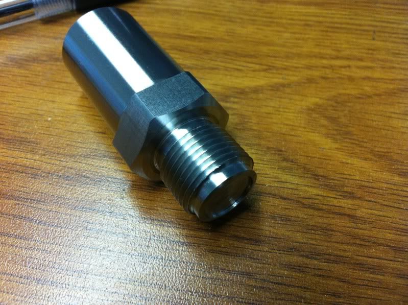

    I haven't done it yet, because I haven't needed too, but my plan to accomplish what you need should the time arise is to use a woodruff cutter and cut X and C only.
    Phil helped me program this part about a year ago:
    I used the same endmill to cut the hex and and round pocket in the center instead of using a facegroove tool.
    Philabuster likes this.
