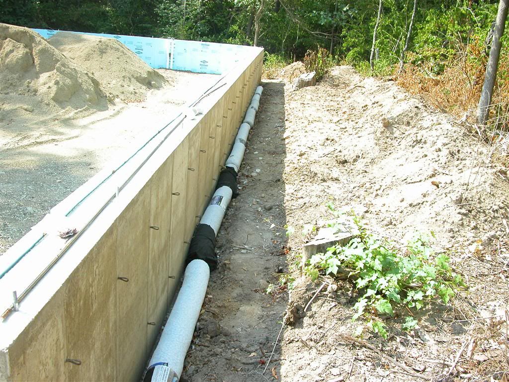

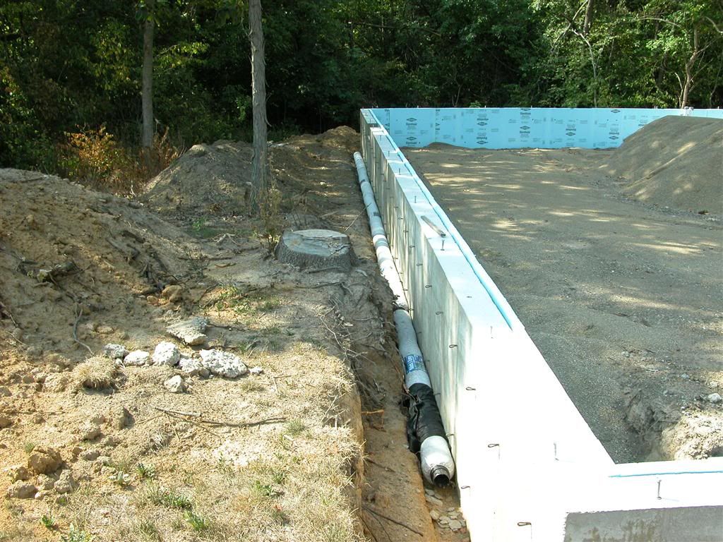

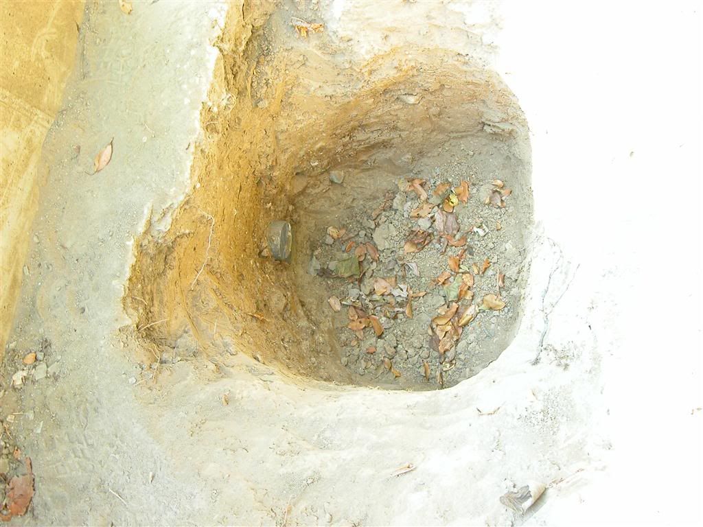

    Not much progress on the construction lately. About 10 days ago the guy that will be drilling the geothermal wells stopped by to look at the location and help me plan the well locations. We determined the well locations, but the well guy had concerns about the looks of the pvc stub piping that my concrete contractor had installed for the geothermal piping. The well guy was concerned that the plastic geothermal piping would not make the turns in sharp corners of the 90 degree pvc stub piping. Keep in mind that the corners of the stub piping were buried underground in the concrete walls and we weren't sure if they were going to be a problem or not. The only way to find out would be to uncover the other end of the pvc stub piping and try to send some of the geothermal plastic piping up through the pvc stub piping and see if it made it through. I started digging where I thought the outlet would be. To you picture this, here is where the stub piping was located after the footings were poured.
    I started digging on the outside of the footing. After an hour of digging, I decided maybe I should ask my concrete guy where the outlet of the pvc stub piping was located. Good thing I asked since it was on the other side of the building about 20 feet away. Evidently I had forgot where I told him I was hooking up to the geotheral wells. Oh well.
    I started digging in the new location. According to the concrete guy, the outlet for the pvc stub piping was located somewhere between 3 and 4 feet down. I grabbed my shovel and started digging.
    It was tough going. We haven't had rain here for a long time. I haven't mowed my yard for 2 monhs, if that gives you any indication. Severe drought. Well, the soil was like rock. I finally decided to fill the hole with water and let it soak in. Maybe this would make it easier. I filled a 5 gallon bucket with water, lugged it out to the construction project and poured it in. Several hours later I went back out and had a much easier time digging. I finally uncovered the stub piping. Maybe you can get a feel of the "rock like" soil here. The end of one of the stub pipes is covered in duct tape so you may see the gray color.
    Now I just have to wait for the geothermal contractor to come and run some geo-piping in the pvc stub piping and make sure it will go through all the way. Wish me luck.

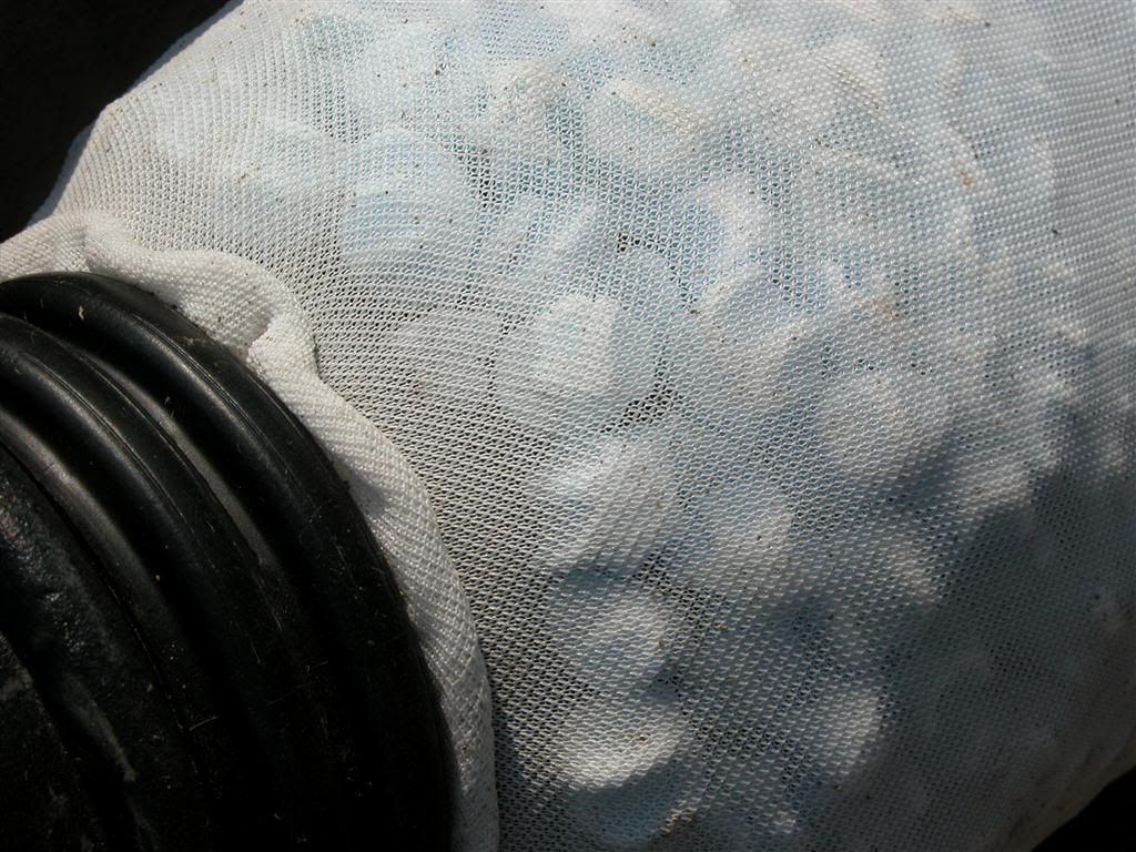

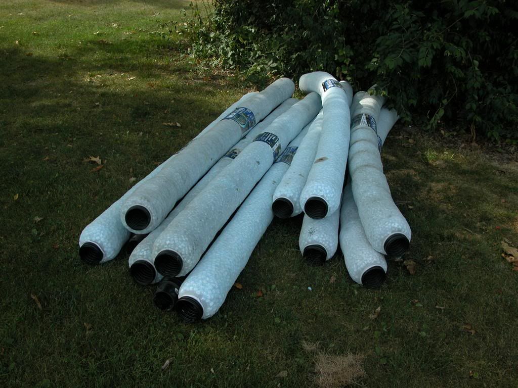

    I did start putting some drain piping along the base of the concrete walls to help me with water removal due to the slope of the location. I went to the local home center and found some new product.
    Hopefully it works as advertised. It is an 8 foot section of slotted plastic drain tile surrounded with small pieces of styrofoam and all held together with a fine mesh outside. It looks like this:
    You just put it in the trench like it is. Connect each section with internal couplers. No need to surround the piping with fabric or small stones or anything. You can just backfill with soil. I did have to "repair" a couple of the sections with black landscape fabric. The white mesh covering got caught on some sharp edges as I was dragging it out of the bed of my truck and started "leaking" the small pieces of styrofoam. I just used some landscape fabric and rubber bands to keep the styrofoam pieces trapped inside.
    I hope it works.
    I started spreading some of the sand, but I have been waiting for some rain to help me with the compacting. I think I may be waiting for some time for the rain. I may have to make alternate arrangements. Living in the country as we do, we have a well for our water supply. I am reluctant to start using the well to water the sand. I have some bad memories about running out of water when I was a kid - not in this house but in my childhood home. I don't know how deep the well is for my current house, but the one in my childhood home was rather shallow.
    Tim

    No waterproofing? No stone under the drainage tile or water proofing on the foundation walls? My understanding is that these things all work together as a system, failing to put them all together may not get a system you are happy with in the future. Of course folks have built structures for a long time without them and been Ok but modern technology is useful.
    The form ties can also provide a future way for water to penetrate if they are not removed and filled and then sealed over.
    Still I am jealous as he.. good luck with your new shop.
