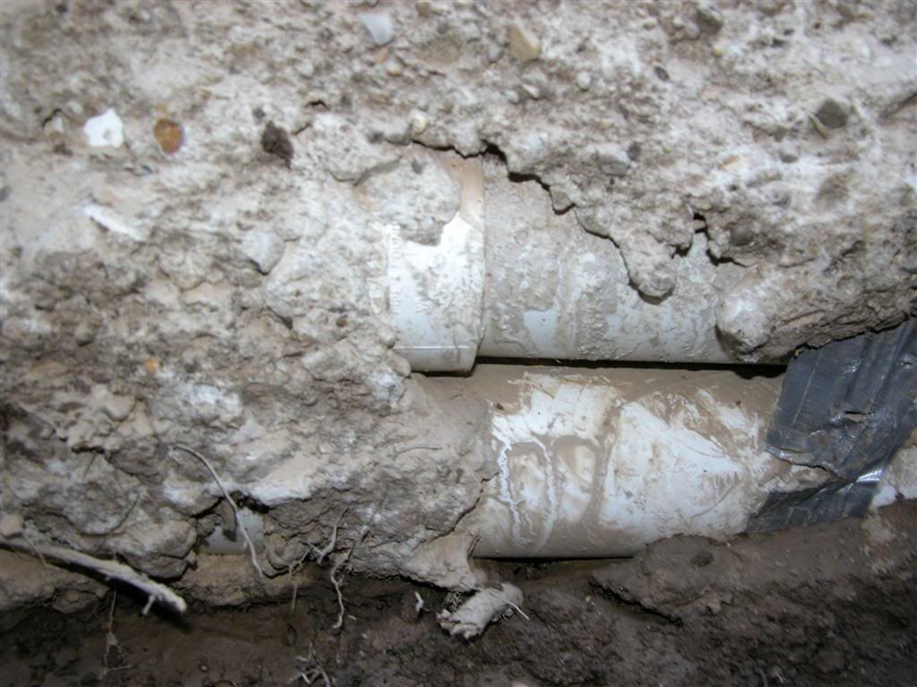

    Well I got some bad news from my HVAC contractor today. They came up and tried to send a section of geothermal plastic tubing down through my PVC stub pipes. The geothermal plastic tubing wouldn't go through. It appears that the PVC piping has a corner that the geothermal piping will not pass through. Evidently the corner is to sharp/abrupt. At least that is what the HVAC guy says.

    Thanks everyone for the sage advice and encouragement. A couple of nights of sleep (I wish I could say it was restful sleep) and some thinking and I think I have a plan. I too agree that there is some more effort that can be expended on attempts to persuade the geothermal tubing through the pvc stub piping. Sometimes you just have to know how to talk to it...whisper sweet nothings...throw in a little wire-pulling lubricant I have left over from another project...and then maybe some profanity for good measure. Just like my Dad taught me. I need to get my hands on some of this geothermal tubing as soon as possible next week.
    In the meantime, I am going to dig up around the vertical section of pvc tubing and get a better look at what my concrete contractor used as far as the "sweep 90s" to make the vertical to horizontal transition. I think most of the pvc piping is buried in the concrete footer, but I may be able to access enough of the pvc to cut a hole in the side of the piping and allow a more gradual curvature of the geothermal tubing through this hole. It never hurts to come up with a backup plan.

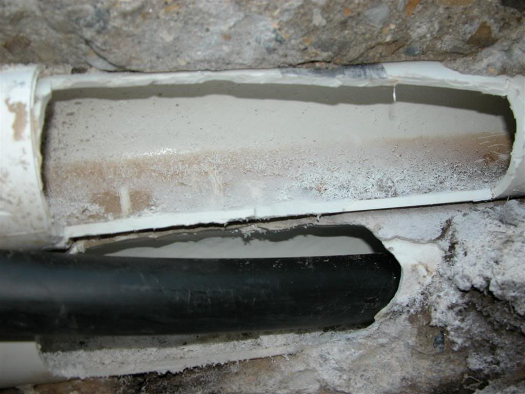

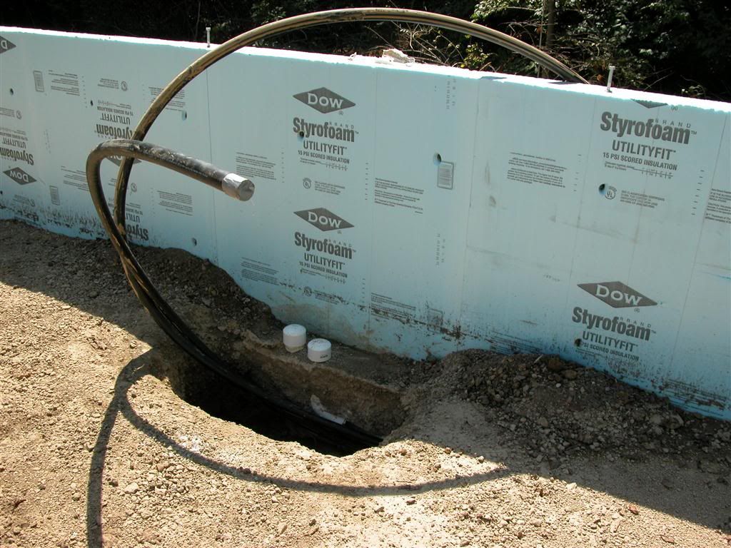

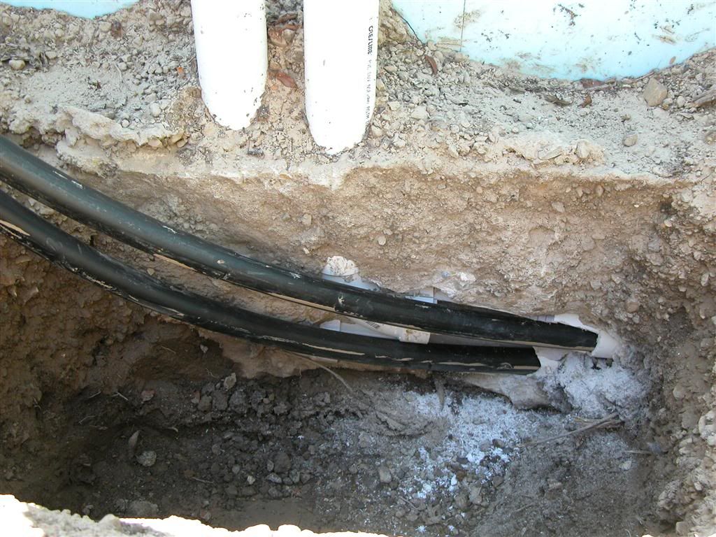

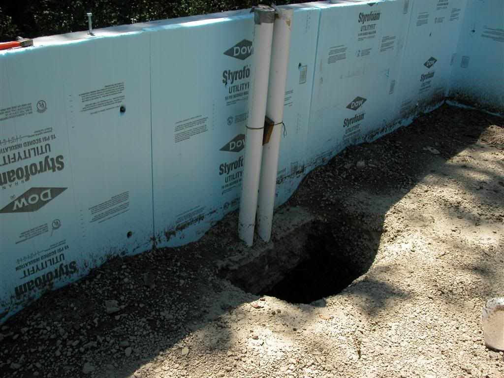

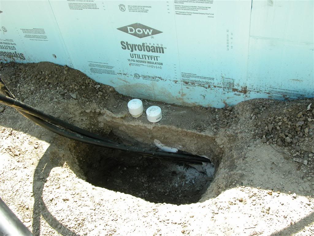

    I got a roll of the geothermal tubing from the geothermal well digger guy. I cut a 25 foot length and attempted to pull it through the pvc stub piping. No go. The geo tubing was a lot more rigid than I expected. I thought it was 1.25 inches in diameter, but that was the internal diameter. The OD was actually 1.675 inches. There was no way that it was going to pass through the 90 degree corner, even it was a long sweep 90 degree corner.
    So, I started digging in the area of the vertical section of the PVC piping and hoped that the piping had been laid close enough to the edge of the form when the concrete had been poured that I could get to it.
    I was in luck.
    The long sweep 90s were partially visible. It would only take a little work with a hammer and chisel to expose a good portion of the piping. Then I could cut out the side of the piping with my dremel. This would allow the geothermal tubing to take a more relaxed turn from the horizontal to the vertical.
    So I chiseled and dremeled and pulled the 25 foot section of geothermal tubing through with moderate effort.
    I went through a few abrasive disks for my dremel, but it was successful.
    I cut and capped the two vertical sections of PVC stub tube since they were no longer needed.

    For someone else that might want to try this, instead of plumbers sweep ells go to the ones for electrical conduit. The sweep is much larger. Also don't skimp on the diameter. 4" might be a nice size. Then use a hefty pull rope and plenty of wire lubricant on the whole thing when doing the pull. Still might not be easy though.
