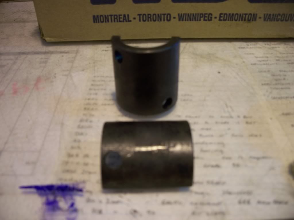

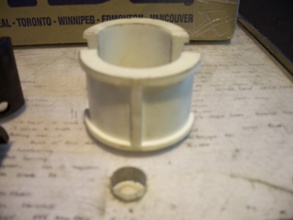

    I had an odd little job come in the other day, a customer needed a short run of bushings made. sounds easy right? well there is a catch, they have to go on an existing shaft in a machine with out the shaft coming out of the machine. Once installed on the shaft they would ride on another bushing made of UHMW, from what I gather the guys are lazy and don't like to change out bushings a lot so once the UHMW is gone it just beats the steel one to death then they change it....
    Here is the UHMW bushing they supplied,
    So after some pondering and hair loss this is what I came up with, The bushing is held on with two roll pins one placed 90 deg from each other which will allow it to drive with the shaft it has also been heat treated to add life to it.
    This is how it works,

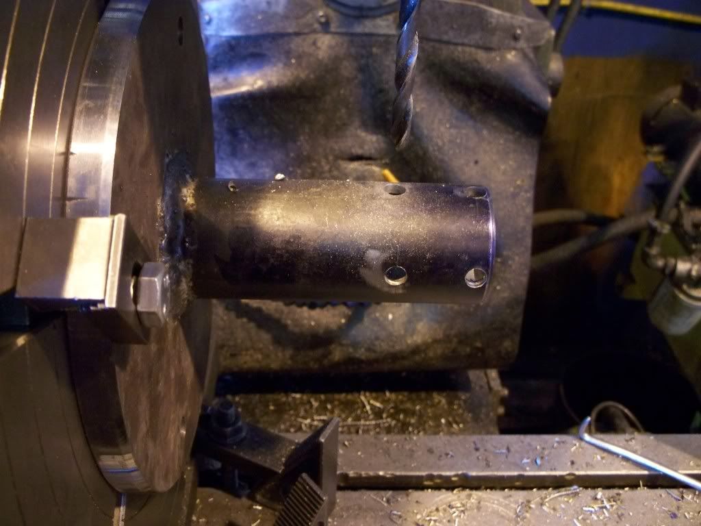

    now the fun begins, I cut the blank shafts a little long I then drilled the hole 0.187" under size and left the OD 0.187 over size I then put a bevel on both ends of the the part. Next I fabricated a jig to hold them in the saw to split them in half. I also marked each bushing in four spots with a number or letter so as each side would stick with its mate for the rest of the process.
    Once they where split into two parts I clamped them into the lather as one and machined the inside Dia to the correct shaft size, I next fabricated a sort of mandrill device that could be held in the lathe chuck and hold both sides tight so I can machine the outside to be the correct OD as well as run true with the ID. I cupped out both ends so it would slide of the bevel and sandwich the part onto the shaft.
    Once machined to size they where all faced down the correct length, next I need a hole in each end on both parts so the roll pin will go through hold them true, Some more hair loss and this happens.

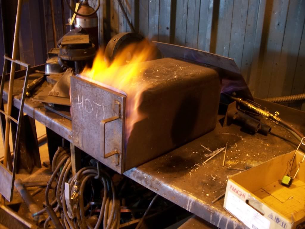

    I would drill the first hole in all the parts, after which I dialed everything back in and drilled a fresh started hole and indexed 90 deg to the next Sliding the bushing in and using a peace of drill rod through the first hole to keep it in place. After deburring all the parts time for Heat treatment. I have a small oven which runs off propane which could do about 12 at a time. Pictures are great but I managed to talk my co-worker into taking some video for everyone.
    They are heated till bright red and quenched in a oil bath, hardens them up real nice and equal and I have not had anything crack yet.
    Here are all the little buggers mated up and polished ready to be destroyed.

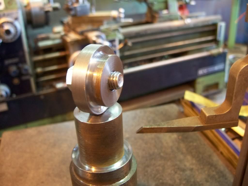

    One more little thing before I fall into a coma, Did a set of train wheels for a scale train that is used in a park.
    Major OD is 9" Minor is 7.5" this is a .250 cut off Dia or .125 per side.
