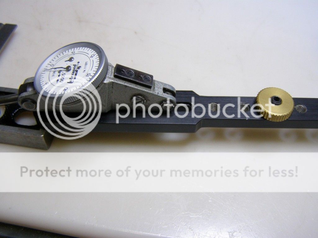

    This is something I've had lying around for months ever since I read in here problems some were having measuring large holes.
    It is something most should be able to make or "know someone that knows someone"
    Take it as an idea as it can be changed depending on who would want one. it looks so simple I wouldn't be surprised if it didn't already exist but I've never seen one similar in my life.
    http://www.f-m-s.dk/Large%20Hole%20Measurement.pdf
    If anyone decides to have a go I'm sure we'd all like to see pictures.
    Happy machining
    Gordon

    I have a device that fits a dial test indicator. It will measure holes from 0.5" up to 7.5". It's only real use is to compare a known ID to another ID.
    I don't do a lot of large holes, but I usually reach for an inside mic to measure with.

    Quote Originally Posted by crashtestdummy View Post
    That's the best adaptation of this kind of device that I've seen. It can be used for direct measurements both inside and outside by setting with a stack of gage blocks. You'll need to be sure that both of the contacts do not have flats on them. Flats can interfere with accurate readings.

    You guys have never seen a Mueller Gage?
    Mueller Gages Company - 2900 Series
    A Mueller gage and a calibrated ring or disk is hard to beat. Dial bore gages are great too, but have a practical limit in diameter.
    However, for the money, I don't think you can beat a tubular micrometer for large diameters. IMO, measuring small diameters is much harder.
    http://www.use-enco.com/CGI/INSRIT?P...PMAKA=240-0035
    Also, you really should be setting this thing with a gage block stack, not a height gage. Most height gages are only good for a few .001s.

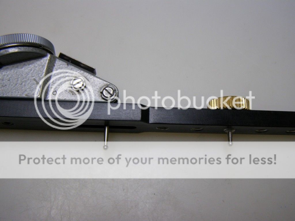

    "I have a device that fits a dial test indicator. It will measure holes from 0.5" up to 7.5". It's only real use is to compare a known ID to another ID.
    I don't do a lot of large holes, but I usually reach for an inside mic to measure with."
    I looked at one of these awhile back to check the I.D.'s of some bores that were larger than our bore gages, but decided against it. The bores were 2" deep & I was concerned about checking for taper & bellmouth on the parts. Are longer extension tips available? I wound up building an indicator gage very similar to what Gordon posted in his link and used our jig grinder for the setting master. No pictures, though. (Sorry, Gordon)

    Quote Originally Posted by toolmaker35 View Post
    The tip on mine is just a machined set screw. It would be easy to make one longer, but the base is just aluminum, so there might be some flex issues with a longer tip.
