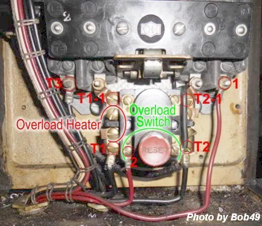

    Would I be foolish to Take the contactor which is in the machine and replace it with a known good 220 v
    http://i1177.photobucket.com/albums/...h/45b1ceae.jpg
    This is part of the mg unit I bought from work. They changed to a vfd, and the toolie says no low torque but is good enough. This unit I saw run and used myself. Had no idea there was trouble with it. I guess maint was tired of replacing brushes, said one of the units kept "burning them up". I think the problem was with the exciter. So I do belive I have a good mg if there are problems with the one in my machine.
    Back 2 wireing, I think I can get this done myself as long as I can get good direction, and I feel it's here.

    "Would I be foolish to Take the contactor which is in the machine and replace it with a known good 220 v ..."
    That starter is a Cutler-Hammer and is closer to a stock 10EE than the previous starter.

    Looks to be an original stock MG piece. Having the option to revert to something known and documented using pieces in hand is certainly attractive if you can't figure out what's there now.
    The good thing is the monkey business seems to be upstream of the MG. Switching and providing overload protected line power to supply the MG are the main functions in that compartment.
    The route you suggest is viable, didn't know you had original type parts to replace the lashup shown in the previous photos.

    Quote Originally Posted by Alsuchy View Post
    http://i1177.photobucket.com/albums/x350/alsuchy/monarch 10ee/monarch/45b1ceae.jpg
    This is part of the mg unit I bought from work. ...They changed to a vfd, and the toolie says no low torque but is good enough. This unit I saw run and used myself. Had no idea there was trouble with it. I guess maint was tired of replacing brushes, said one of the units kept "burning them up". I think the problem was with the exciter. So I do belive I have a good mg if there are problems with the one in my machine.
    If the Cutler-Hammer (CH) contactor from the other 10EE was correctly set up, that is has the right coil and overload heaters, then using it makes sense. Just because the tag on the front says 220V doesn't mean that it hasn't been changed at some point. These things are modular and the coil, etc. can be easily changed. Check the value printed on the coil itself and the metal tags on the heater elements (see my conversion checklist for the locations). If the coil is 220 and the heaters are H1374 or H1375 you should be good to go. If the heaters are wrong you may be out of luck with the CH contactor. Brazil Electric used to be a source for the heaters, but I guess that we've exhausted their stock and the heaters haven't been made for decades.
    This thread provides detail on how the CH contactor starting circuit works, including diagrams showing the circuit at start and during run: 10EE MG Starter Circuit with Cutler-Hammer Contactor - Revised.
    The Allen-Bradley (AB) contactor that was in the machine will work just fine and is a better choice (in my opinion) since parts are easier to get and it provides overload protection on all 3 phases instead of just 2 for the original CH contactor. Here's a link to a thread that provides information on wiring up and troubleshooting an AB contactor in a 10EE: 10EE starting circuit with Allen-Bradley contactor
    Either way, it's a good thing that you pulled everything out of the contactor compartment and are starting from scratch. There's not a whole lot going on in the starting circuit, it just connects to the start/stop station and the drum switch in the headstock (unless someone has wired in additional interlocks). If you need help identifying the wires just holler.
    Note also that either way there are things you need to attend to if you are going to run from a rotary phase converter.
    Cal

    Cal thanks for all the info on the starting and run circuits with either the c/h or a/b contactor. Reading the posts/articles about these has helped me out tremendously. I have a bunch of photos of where I am currently in this project (wireing to run 220). Have changed over the controll box at front by your feet to two wires on L1'L2,L3 & 3wires bolted togeather photos of that included.
    Kinda of at a roadblock since some of the wires in the contactor box are not marked. 3 large black at the bottom and a couple red comming from the start stop switch. Where do these go?
    Also did I get the jumper right to run on rpc, black wire from L3 to 3?
    How do you know which is the generated leg from the rpc?
    Feeling a little more confident with the three phase stuff. The schematic from monarch is not a easy read for a novice!
    Sure hope all this stuff from the original Mach. Is good!
    Photos here
    http://photobucket.com/albums/x350/alsuchy/monarch 10ee/monarch
    Don't understand why but must cut and paste to make link work
    Thanks for the help guys
    Al
    Where do these go?
    The 3 large black wires are the 3 AC phases running to the MG. They connect to the T1, T2 & T3 terminals on the left side of the terminal strip on the front of the MG and pass through the start/stop switch box without interruption. They can be connected in any order to the T1, T2 & T3 terminals on the contactor.
    I don’t much care for the butt splices in the AC wires. If you don’t have enough wire to connect directly to the contactor I would recommend replacing the wires. Use #10 stranded wire. I used lengths of red, blue and black wire on my machine. This makes it easy to connect T1 on the contactor to T1 on the MG, and so forth; however, as already mentioned, they don’t need to be connected that way. When you start the MG the first time it’s critical to make sure that its turning the correct direction. If it isn’t, swap T1 and T2 at either the MG or the contactor.
    The red wire coming in from the top goes to the center position switch on the headstock drum switch. You have it correctly connected. The other red wire coming in from the top and going out the bottom is the other side of the headstock center switch. It connects to terminal 3 on the start switch. The 3 black wires that also pass through the contactor compartment connect between the C1, C2 and C2 terminals on the DC panel and the headstock drum switch and control the forward and reverse contactors.
    The two loose red wires that go out the bottom also connect to the start and stop switches. Someone has added wire numbers 2 and 3 to these wires on your machine; ignore those numbers. One of the red wires connects to the terminals on the start and stop switches that is common to both switches; the ones that have a jumper between the switches. That wire is #1 and connects to the #1 terminal on the contactor (see annotated photo); that’s the right most terminal on the bottom of the of the four main contacts. This can be a bit confusing since the terminal above is 3 and the one on the bottom is 1, but your black bar has the correct number on it, inside the little circles (other AB contactors may not be labeled this way). You can identify wire #1 by pulling on either end or by checking continuity with your meter. The other red wire is wire #2. Verify that it connects to the other terminal on the stop switch (the one without the jumper) and to the #2 terminal on the overload switch (see annotated photo).
    The jumper is correct.
    You can identify the wires at the RPC with a volt meter. Set you meter on AC volt, using a scale that’s good for 240 volts. Take one of the two AC terminals coming in from the circuit breaker and (with the RPC running) measure the voltage from the terminal to the 3 AC terminals on the machine side. One of the 3 will read near zero volts, label it “L1”. Go to the other incoming terminal and again measure the voltage from it to the three outgoing terminals. A different terminal will read zero, label it “L2”. The unlabeled output terminal is the artificial or “wild” leg. Another way to identify the real phases is to measure from ground to the 3 output terminals. You will read about 120 VAC from ground to the real legs and different voltage (usually higher than 120) to the “wild” leg.
    You can identify the leads coming into the lathe by continuity measurements. Connect the real legs to L1 and L2 and discussed in my CH contactor thread.
    Cal
    I am disappointed! flipped the sw to rpc, zoom all is good. Power at machine this is good, L3 generated good. Power at top of contactor L1,L2 real, L3 generated good. Ah! turn it on right? NOPE! No go. Coil doesn't even try to pull contactor. When contactor is pushed in manually BUZZ, HUM but no movement. BLAH!
    Still worried, even more now, that I may have a short down stream of the terminal strip @ T1&T2, or worse stupidium got all over the wireing.
    Let's get the contactor working and then worry about the MG. Verify that the coil is marked 220V. Check the resistance of the coil. Press the reset button to reset the overload device. Disconnect the MG from the terminal strip (terminals T1, T2, T3) for further testing until you get the contactor closing and opening with the start/stop switches. With the start button pushed you should read 240 VAC across the terminals on the top of the coil.
    Make sure the MG is free to rotate by turning it by hand from the exciter belt.
    Cal
  19. #39
    Alsuchy's Avatar
    Alsuchy is offline Aluminum
    Join Date
    Jan 2012
    Location
    Minn USA
    Posts
    73
    Default
    Quote Originally Posted by Cal Haines View Post
    Cal
    ok let's try this.
    http://i1177.photobucket.com/albums/...l/e87a62a5.jpg
    On the left side if disconnect from the terminal block all wires have continuity from the contactor, and are independent. Once connected though T1 and T2 will read as though they are shorted togeather, no resistance. T3 stands alone. If T1 is removed from the right side T1,T2,T3 are all separate.
    Based on what Cal just said I would say T1 & T2 are shorted at the MG.
    So now I will as suggested try to get the contactor working disconnected from the terminal strip.
  20. #40
    Alsuchy's Avatar
    Join Date
    Jan 2012
    Location
    Minn USA
    Posts
    73
    Default
    Coil reads 208-220 on name plate. 180 ohms resistance. Rpc running and start button pushed. Across top terminals on coil = 0 volts.
    Also no resistance across output terminals of 6volt transformer. Assuming that it's bad, when does this get energized? After contactor is closed?
    I really appreciate you guys patience here!
    When I must get the electrican SAY SO! Don't let me waste your time trying to save some money.
    I did expect this to start. Shucks!
