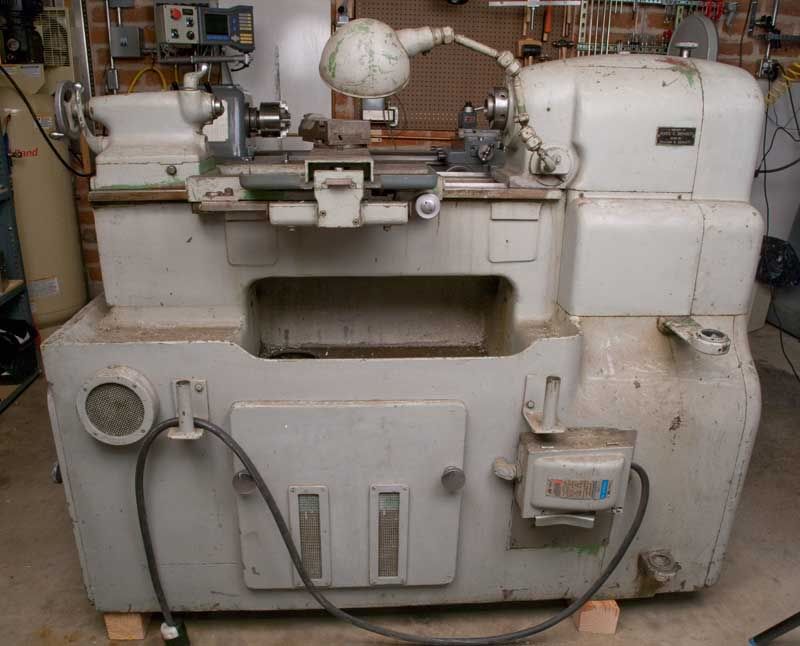

    Must have been sometime in early 1976 when I first saw that lovely row of Monarch 10EE’s in the Texas Instruments North Building Model Shop in Richardson Texas (Dallas). I was a green weenie mechanical engineer with a lot to learn so I hung out there as much as possible working and talking with the machinists. It was the 10EE’s and the big SIP Jigbores that got my machine lust going the most.
    Now I can thank (or blame) this here forum for re-igniting that desire to have my own 10EE.

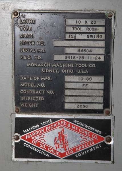

    Here are some pictures of my 10EE project starting point. Got this lathe from a local machine shop a few weeks back for $2200. It is a 1960 model, WIAD, Square Dial with ELSR and taper. Mechanically in good shape (just very dirty from sitting) but unknown electrics as the shop owner said the drive did not work now but did when they purchased it at a University of Arizona auction several years ago. Monarch says it is one of the last of the WIAD drives with a mfg date of 10-60.
    The plan is to first clean, lubricate, adjust mechanicals as required for basic operation then see if I can get the WIAD to run. Will use 240VAC single phase for power (no coolant pump). Got the proper manual and some replacement parts from the nice folks at Monarch (flat belt, way wipers, apron pump filter). Just waiting for me to get some time to go at it. After I get it running I will decide on what level of further refurb to do. Probably will then do a paint job but not sure what level of effort I will be doing on that.

    Reminds me of mine when I first got it. But mine was totally "wore out". The carriage handwheel would turn almost a half of revolution before it would move the carriage, and over .100 backlash on the crosslide dial. Sounds like yours is a whole lot better.

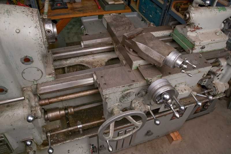

    Quote Originally Posted by daryl bane View Post
    Hoping it will suit my needs without a total tear down and bed regrind. Hard to tell without being able to do a test cut and check for taper but I took the risk buying it knowing I may be in for extensive work. Carriage handwheel has only 5-6 degrees of backlash. Crosslide screw has about 0.020 (diameter on the dial) backlash as it is now. Tailstock seems tight at full extension. Carriage has not been scraping the inside flat way ever. No abuse of the ways is visible and wear "looks" to be not bad (looks can deceive here however). Spindle nose is decent looking with some minor dings and such that will need dressing up.
