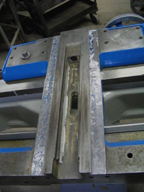

    Set up for scraping the cross slide's guiding dovetail slide. Needed to get the slide in such position that I could see it, and not stand on my head.
    The 3 holes on the right are for the cross feed nut. The 2 outer are for the screws, the center is an oil galley that oils the nut and screw. There is a hole on the headstock side, that is visible in an earlier picture, with a grease fitting. The hole to the left of the 3, is for the TA's drawbar clamping screw.
    Different style of scraper blade. I tried a short straight blade, but there was interference between the cross slide, the BIAX and my knuckles. Probably a good thing, the scraping seemed to go a lot easier.

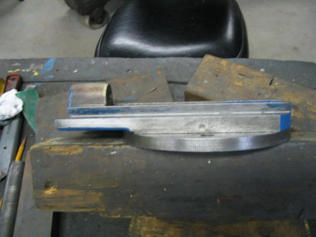

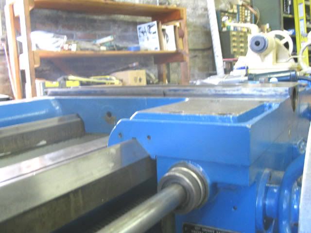

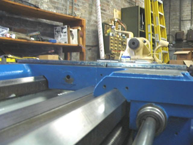

    In my post of 4-6, the caption for the last picture with the level checking the cross slide ways needs to be qualified. The last part about being parallel to the bed ways in both directions would apply if this were a full reconditioning job, ie; the bed scraped or ground, the carriage slides reconditioned, etc, etc. THIS IS NOT A FULL RECONDITIONING JOB.
    I started then stopped, scraping the cross slide ways today, and reconducted the survey. The results are the same, what has changed is that I determined that the level readings are mostly the result of wear in the carriage slides. Yes, there is wear in the cross slide ways, and that also contributes to the level readings, but I also checked the height from the top of the dovetails to the cross slide flat ways, and those readings were fairly constant. The different readings I got, did not jump out a say this is excessive, in fact they showed very little difference from side to side or front to back. They basically agreed across the board, so to speak. This caused me to stop and re-evaluate my earlier objective, and to consider the results had I persued that course. My conclusion was that I would be making things much worse, especially in regards to the cross feed screw alignment, plus a lot of additional scraping, not counting the problems with fitting the gib.
    I will still use the level as a rough control, but I will not rely on it as the sole arbiter. I will use the cross slide, and the height from the top of the dovetail to the flat ways, as the primary arbiter.
    Fortunately, I had only done about 3 scraping cycles, so no great harm was done.

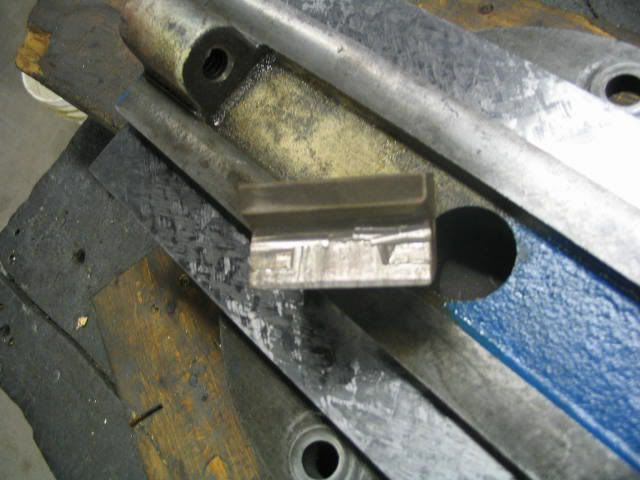

    Spotting the top slide ways, about the 7th cycle. When I started the spotting closely matched the bare area in the 2nd picture of my 4-11 post. Every so often I will check the parallelism on the surface plate. The spotting sequence used the the top slide's slide for 2 cycles, then an angled straight edge for 2 cycles, to get ubder the dovetail. This spoting was done with the top slide. You can see where the tapered gib goes on the left side. It was finished about cycles later.
    Checking the parallelism of the guided dovetail way to the guiding dovetail way, which was scraped earlier. I made the dovetail block that the mag base is on, when I did the same check on the 12" CK 6 years ago. The dovetail has 2 raised pads that contact the dovetail face. Notice the nut that is partially obscured by the knob.
    I forgot that I took this picture of the raised pads. I used a die grinder to get rid of the excess material after I cut the dovetail.
    About the 4th cycle, also a better view of the integral nut. The left side needs approx .0015" scraped off to obtain parallelism. As this prgresses the spotting will start increasing to the right.
    Spotting the tapered gib, the gib is held in postion with the block and 3 nails. The big punch is used to seat the gib, firmly, in the assembled compound rest. The smaller punch is used to remove the gib after spotting. The gib was finished about 3 cycles later.
