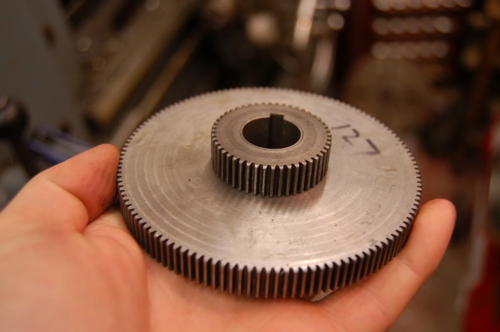

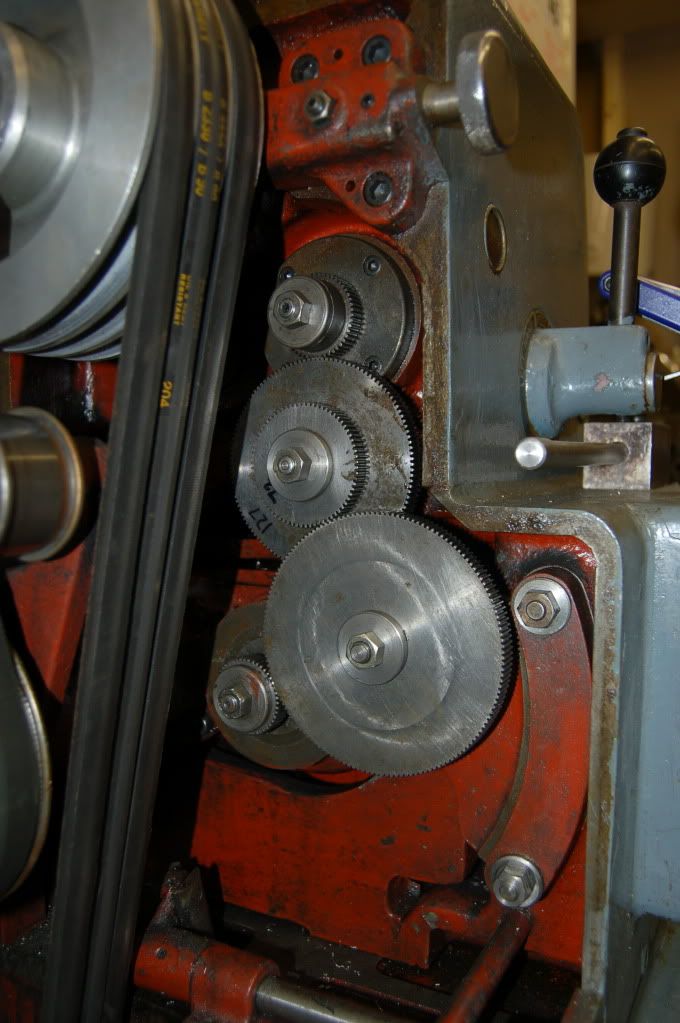

    Just some photos of the metric changewheel setup on my CVA, to help out an Ozzie who asked
    Overview of the metric wheels:
    They use smaller teeth than the imperial ones, so the 127 translation gear is manageable in size.
    The changewheel chart from my machine:

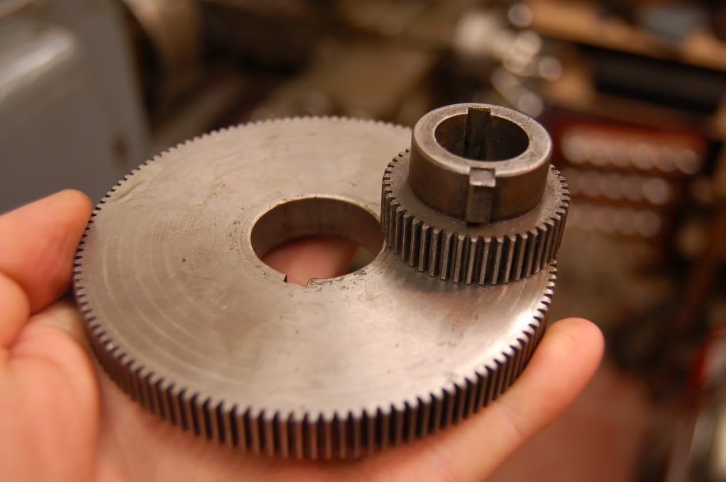

    The 127 compound gear is used with either 48 or 72 teeth. They are keyed together. Here assembled:
    And Split:

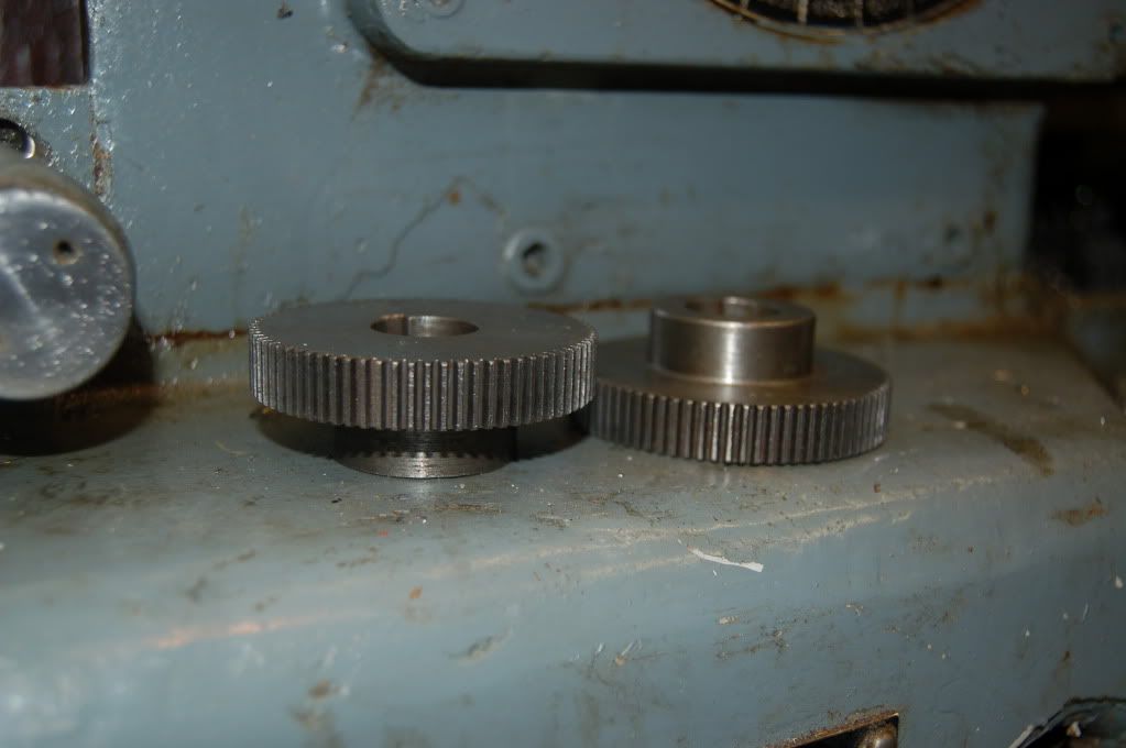

    And heres a couple of changewheels so you can see the boss on them:

    Thanks Guys. It's all interesting stuff to see, especially the split photo as there seem to be a multitude of ways of keying those gears together.

    The end gear unit of the square dials is enclosed and cannot accommodate a quadrant gear larger than 4.03 inches or a reverse shaft gear larger than 2.56 inches.
    So, for metric threading on an Imperial 10EE, a switch is made from 16 DP to 32 DP for the reverse shaft gear and the 127 teeth gear.
    The remaining gears are 16 DP.
    For some of custom conversions, Monarch employs reverse shaft gears and its mating gear with DPs between 16 and 32, to maintain the largest possible gear which fits within the enclosure.
    32 would appear to be the smallest DP for use in a machine of the general class of a 10EE.
    The round dials have two quadrants, whereas the square dials have only one, and the round dials are quite flexible, certainly more so than the square dials.
