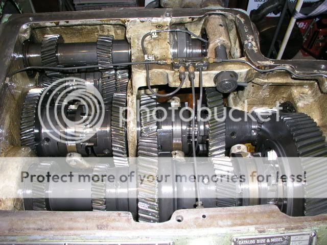

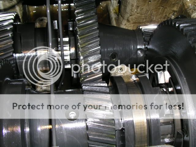

    Default Interior looks good to me
    Took the cover off, yes even a short, round, wimpy guy can do it
    I really do want to thank everyone for their input.
    Here are some photos, everything looks good to me, don't see any broken teeth etc. Tomorrow after work; I will drain the oil. I also need to check to see if the lower oil sight glass has been covered-up with something on the inside. Sight glass appears to be a thin piece of plastic.
    Mike

    Default
    The round thing (with the bright wear track) on the biggest gear is actually an eccentric and works the oil pump. Each time the spindle makes a rev, the upper sight glass with the end of the tube showing should deliver oil. Drip drip drip mine goes at slow speeds. Faster should be more of a stream.
    This shows you the pump is functioning.
    What it don't show you is if tubes going to front and rear spindle bearings are doing the same thing.
    John Oder

    Default
    Pull the tube ends out from spindle bearing ports and work the pump. You'll soon know if oil getting there.
    Harry
