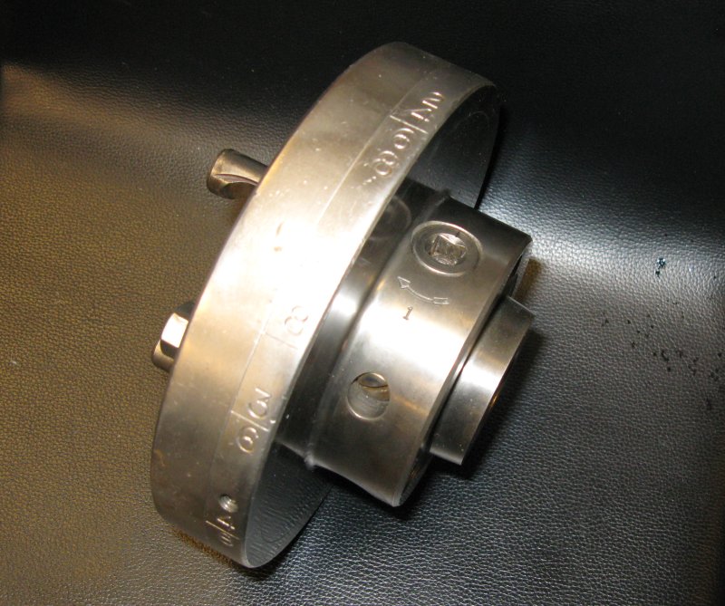

    Quote Originally Posted by daryl bane View Post
    I'm done. I've got it all. BUT I would like one of those multiple threading faceplates though. Actually I had all of the original worn slap out chucks with mine also, but somebody wanted them worse than I did.
    You mean one of these?
    Really, it's come in handier as a spare D1-3 nose than as an indexing attachment for a chuck,

    Default
    Yessir! thats the baby. I can imagine I would use the crap outa that! I have a D-3 nose mount project to do, but since the move haven't been setup for it.

    They also work great to do hole patterns in flanges, I just looked on mine and it has NO number on it?
