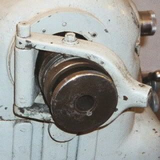

    The only thing I would change is the mounting bracket on the rear of the headstock. As it is now, the bracket has to come off to take the cover off, but that will be the new owner's problem. I used the lathe for 7 years, and had no problems with the system, other than the way I made the bracket. I was a little worried about the 4140 PH for the spindle nose, but I couldn't find anything wrong with it over the years.
    BTW, that post is hard to find. Somebody posted the link a few years ago, and I had been looking for it, but couldn't find it. It's in Favorite places now.

    The Monarch factory installed collet closer used a special, two-piece cover in place of the upper cover. Here's a couple of very early photos of mine:
    Cal
