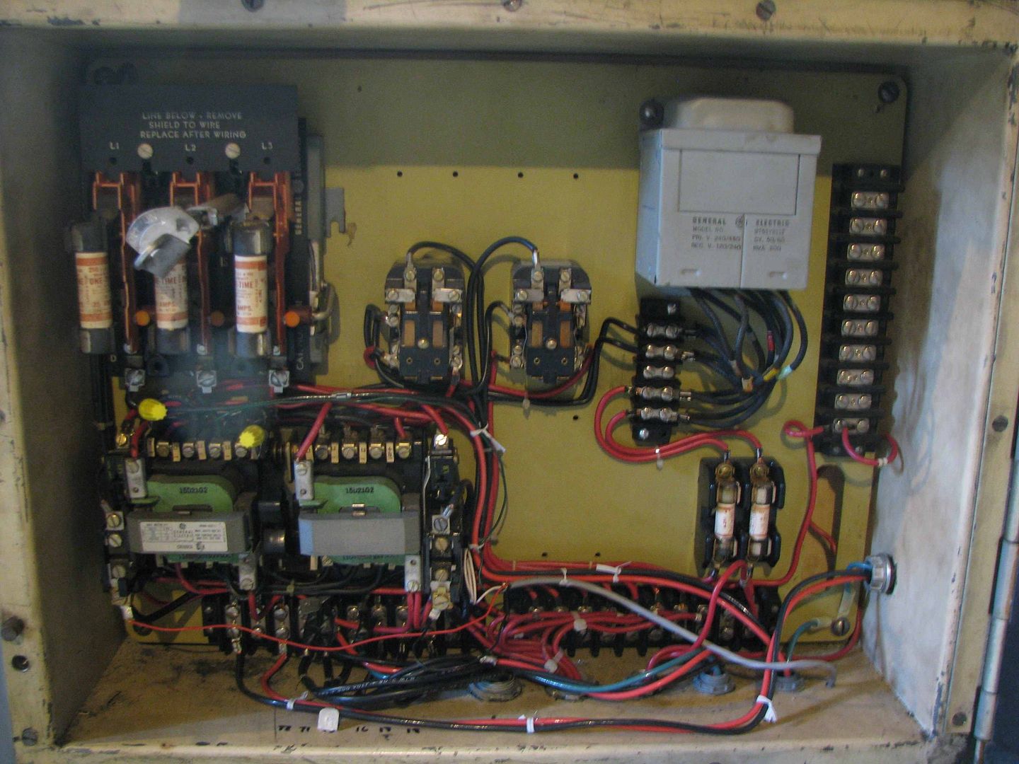

    Ok, here is a photo of my electrical cabinet. Comparing to yours, it does look like someone made some changes, and that transformer looks to be missing. It looks like your coolant pump contactor is where that transformer is in mine (and in the diagram). My lathe does not have the coolant pump. I'm also not sure why you have 4 of the small contactors rather than 2? Those are the fwd-rev contactors for the Reeves drive motor.
    Here is the diagram copy that I marked up to keep track of my VFD conversion, so you can make sense of some of the differences you might see.
    BTW, the spindle motor is the only 220v load in the machine, and the only 3-phase. The controls and the motor for the Reeves drive are all 110v single phase.
    EDIT: (in yours, the coolant pump would be 220v 3-phase as well according to the diagram)
    Is it possible that someone stripped that transformer out and wired the 110v loads with the neutral? Whether that is an ok conversion is beyond my ability to judge, since I'm not sure what the reason was behind using a transformer originally. Maybe the neutral wire is/was uncommon in industrial 3-phase lines?
    Yes, just as we had suspected...it does seem I'm missing the transformer. We can only guess that the transformer was pulled out and a separate 115v line was run to power the controller. Not sure why they would have done that, or if there
    would be a problem doing as was intended from the factory and adding the transformer back in. That is what we're leaning towards.
    Yes, but I actually do NOT have a coolant pump on my machine, per the plate and/or manual, so we're not sure why they would have put a relay in there.
    Beyond my ability to judge also, and why I am getting help from a friend. The first diagram you sent had the size of the transformer (200va) and I found one on ebay for $35, but before I buy it we just want to make sure this is the right thing to do.
    Thanks for your help rusty, much appreciated.

    rusty,
    Thanks again for posting your electrical cabinet. I just ordered a transformer on ebay, found one that was very similar to what you have and what another lathe had it it.
    The number is slightly different, but should be similar, and it is 240/480 primary and 120/240 secondary, with a 80 degree C rise.
    The only difference is that the one I bought is KVA .250 rather than the KVA .200 which Rivett used.
    Hopefully this will get the power straightented out and get my lathe spinning. Thanks for posting your pic.
