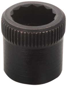

    What about an Allen nut (the ones intended to use with Allen or hex drivers, generically called hex socket head cap screws)? IIRC, they are about the same dia as the cap screw head since the hex is on the inside....
    Like these, but metric: Allen Nuts
    Worst case, you might need to relieve the gear side slightly with something like a woodruff cutter - the surface for the nut should probably be spot faced anyway.... or a special washer, concave on the bottom, to match the hub fabricated.

    Hi Turnado,
    modifying the gear to adapt the threaded tapered pin with the double hex nut is probably the best thing to do.
    on the double hex internal teeth you can apply a lot of force. loading the pin with the hex nut and a slam on the small side of the pin can do the job. I must admit, so far in my case it was pretty simple to remove the pin. just a fine blow with a copper hammer and a large Facom punch.
    I can do this because the bearings are plain bearings and not needle bearings.
    Bertus

    No problem, Bertus - just a suggestion. I though it looked like the Allen nut would work without modification....
