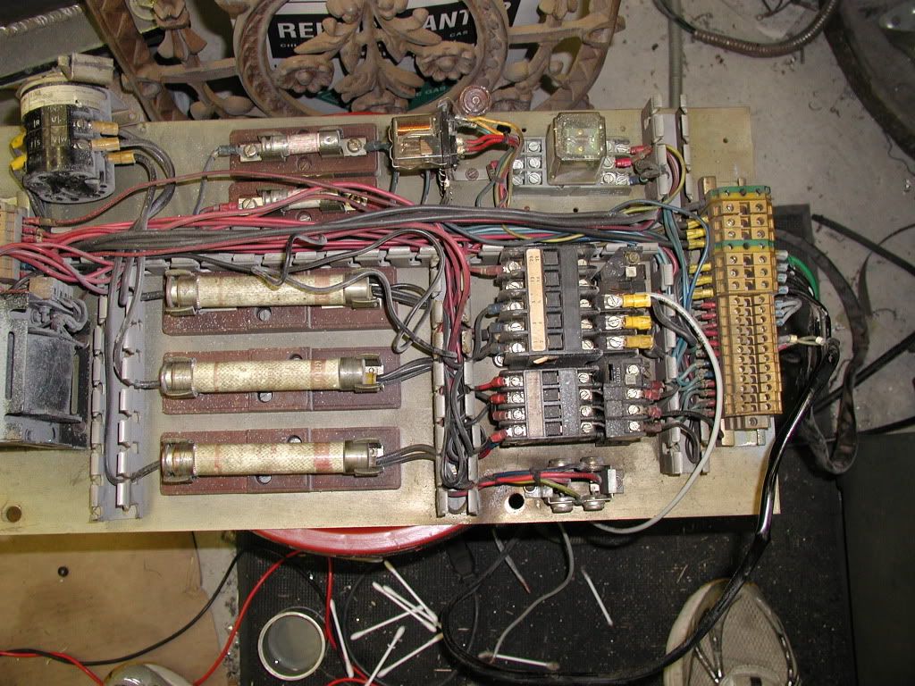

    Default I knew I should not have looked at this.....
    before I needed it.... :
    As you can see, my fuses look nothing like you are describing - or like the picture in the manual, for that matter! I'm not even sure this was from the factory. For one thing, there is an extra relay (upper right corner, right of the timer components). For another, I'm not sure they had even started making those wiring channels in the 70's.
    BTW, new data point on when my lathe may have been made: the electrolytic capacitor in the timer circuit is dated 1975 - oh, and it's 1000 uF at 50 Volts.
    I tried to match the schematic to what I have, but several nice-to-know details are left out: like which terminals of the motor starters are the coil - pretty clear it has to be a and b, but they are not marked on the actual units so that's an educated guess. Also, there's a little letter b on what appears to be the heaters, but again, just a guess on my part. Fortunately, I know how the circuit basically has to work, but getting the diagram to explain the details has not been straight forward.
    Upper left is the mechanical input disconnect from the supply lines, below that is the dual secondary transformer. I have not verified this by wires, but I expect the 3 large fuses to be for the main motor, and the two smaller ones to protect each secondary winding from over current. Right of the two smaller fuses is the timer circuit and right of that is the extra unknown relay. At this point I am guessing it was added to handle the current of the timer circuit, as the contacts on that smaller relay are miniscule (but gold plated! ).
    The main motor starter is below the unknown relay, with the coolant pump motor started under that - the bridge diode silicon rectifier is at the bottom, and replaces the antique selenium rectifier stack shown in the manual pic. The terminal strip at the right (which is really the bottom of the assembly when it's in it's box) is where all of the interconnections to the joystick and electrical transmission are made, as well as the power input and motor electrical connections.
    The other thing making understanding the circuitry difficult is the places on the schematic where wires cross is not consistently marked as to whether there is a connection at the crossing point, or if it is a cross over point (no electrical connection). I have a bad feeling I may have to draw my own schematic before this is over.....

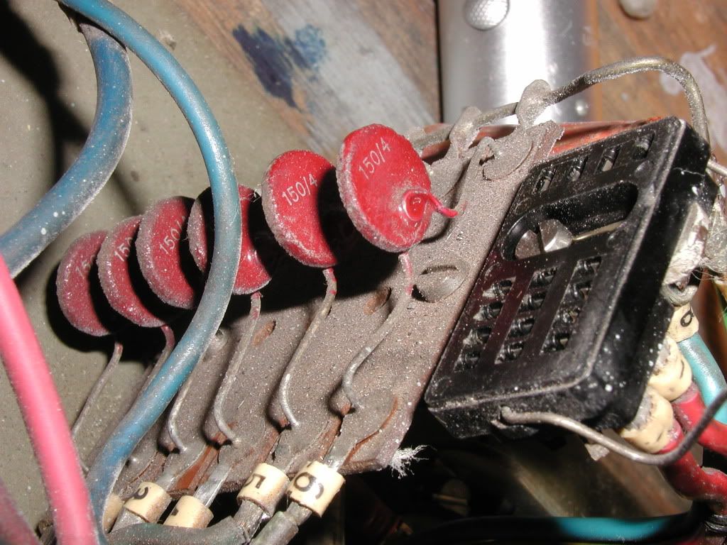

    Oh, and a question for the readers: There are six devices (one on each of the clutch wires) that are round discs with a lead soldered on each side (like a ceramic disc capacitor without its coating) about 3/8 in (10mm) in dia marked with "150/4" that only make any sense to me if they are MOV type surge protectors - again, were these in existence in 1975? Or can someone identify what they really are?

    I thought the cable channel was put in at some later stage too during a rework. The 210 on ebay - early 1980s vintage? has them as well, so must have been around back then, unless there's a few astounding coincidences. I notice he has the same singular relay near the timer.
    Capacitor is the same, can't say I noticed a date printed on it. Timer and rectifiers identical....one more here.
    Is the pump 3 phase or fused elsewhere?
    The ceramic diazed version fuses, I assumed would have been used within the range around that date, although again, the ebay lathe has your type. These were made by Sipa, so maybe those long cylindrical ones come from them as well, the short ones look garden variety.
    Did notice what I thought were capacitors in the rapids gearbox bridging both wires for the clutches back there.

    Now that you have gotten me started on this....
    I spent a couple of hours with the digital multimeter and discovered the timer circuit cannot work as I (and I suspect others) thought it did. Instead of holding the motor starter closed for the pressure switch contacts to close, it is wired to keep the motor starter closed for short dropouts of the ps while running - just guessing, I would think it is covering for such things as air bubbles in the oil line, etc.
    The motor starters stay closed after the initial push of the start button by using an auxiliary contact to apply coil voltage after the momentary push button is released. Normally, the stop button (normally closed) is pushed to remove the coil volage to the contactor and once it starts to open and opens the auxiliary contact, it will continue to open - to only way to restart the motor is to re-push the start button.
    Graziano is using the ps contact to apply coil voltage to the contactor, so even a momentary opening of the ps contact due to a drop in oil pressure will shut the motor down. The function of the timer circuit is to parallel the ps contacts and stay closed during this momentary drop of oil pressure. To do this, they use a 1000 uF cap across the 930 ohm resistance of the timer relay coil, giving a time constant of almost 1 second.
    Unfortunately, this design requires to ps contacts to charge the 1000 uF cap every time they close, so it's no wonder they do not last very long! There has to be a better way to keep the timer relay closed......
    I also realized during this more detailed examination of the circuitry the statement I made earlier about the voltage being applied to the clutches even when the motor is stopped is incorrect - by running the voltage supply line for the clutches thru another set of auxiliary contacts on the motor starter, no voltage is present on the clutches unless the motor starter is closed.... implying the motor should be running. With this arrangement, the clutch voltage is removed even if the motor is stopped by the heaters of the starter from overload.
    Here is a close-up pic of the mystery devices I asked about in my last post:
    As I mentioned then, they only make sense the way they are connected if they are surge voltage devices when the clutch current is interrupted.....

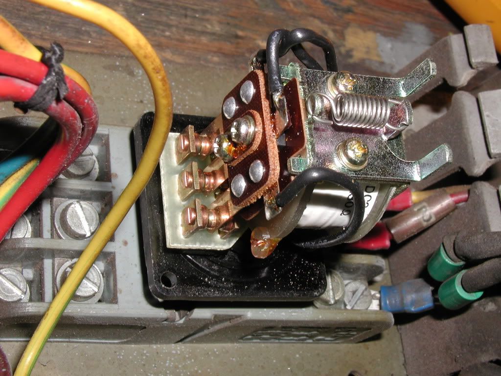

    Also, I deciphered the function of the second unknown relay: it is connected to the push button on the joystick and used to apply the brake by turning on both the forward and reverse clutches at the same time. Wires are connected to both clutch 5 and clutch 6 using a diode in series with each line so the connection of the two together does not interfere with normal operation - here is a close-up of the that relay with the protective cover removed:
    The two diodes are at the lower right of the pic and are green in color. Note the relay used has two extra set of contacts, so if one gets pitted from use, one can just rewire to another set...
    After looking at it closely and looking for extra holes on the backside, I believe what I have is a factory job - the wires are all numbered in agreement with the schematic (except those not present... ). Apparently, the 3 phase coolant pump lost it's fuses when the brake relay was added. On mine the motor starter with its heaters are being considered adequate.
    The big fuses in mine are Gould TRS-30, but notice they are a bit shorter than the holder would allow, so may not be original - 30A is too large for any real protection of the motor and I noticed both adjustable current settings on the motor starters were maxed out as well - perhaps the previous owner thought bigger was better....

    The relay currently being used for the timer circuit has a second set of contacts that are currently unused (it is a double pole double throw [DPDT] relay). The current design has the 1000 uF electolytic cap hard wired across the 930 ohm coil - instead, if the cap were connected to the common terminal of the unused side and the coresponding normally open contact of the relay were connected to the coil where the hard connection was, then the pressure switch would only see the coil resistance when it closed and the very high surge would be avoided on closure it the cap was already charged to +24 volts.
    To accomplish this, the normally closed contact could be connected to +24 v thru a resistor to "trickle charge" the cap to +24 v as soon as the main breaker were closed.
    Any comments from the readers out there? Is there an easier way to avoid the high surge of charging the 1000 uF cap at turn on? The basic problem is the cap looks almost like a short circuit the instant the ps contacts close in the current design - if the ESR (equivalent series resistance) of the cap was 1 ohm, then the initial surge from 24 v would be 24 amps!
