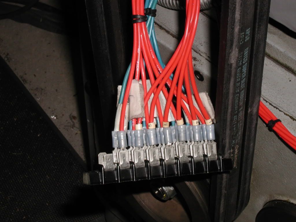

    Today I finished mounting the knobs, installed the control panel, and wired it up:
    I decided to use .25 in wide push on terminals and terminal block for these, instead of the little setscrew blocks Graziano used back in the 70's:
    Since there are three wires meeting at this point (one to the control panel, one to the joystick, and one to the electric transmission), I used "piggy back" terminals for one of the sets of wires. These have a male terminal on the side of the female terminal so another female push on can be attached to the same point.
    The terminal block is shown pulled out of the access slot at the back of the gearbox, but will be pushed back in and attached to the casting for support and to prevent possible shorts to the base casting. This makes it much easier to attach and detach wires compared to the original arrangement, which required crimping two wires into one terminal, and then attaching to the setscrew block.
    As shown, there are seven wires, one for each of the six clutches and one for the clutch supply voltage, which is supplied on pin 9 of the control panel, and goes to the joystick (but not the transmission).
    Since I am using a VFD, it will be wired directly to the motor, and the pushbuttons at the top of the panel will be wired into the VFD so they control it. I am not planning to use the coolant pump anytime soon (if ever....), so I only need to wire single phase to the control panel terminals that end up feeding the transformer. If I ever do use the coolant pump, I will probably wire in a small VFD for that motor.
    If anyone knows where to get the small slip-on wire markers with numbers 0-9 like those shown, I would like to hear about it....

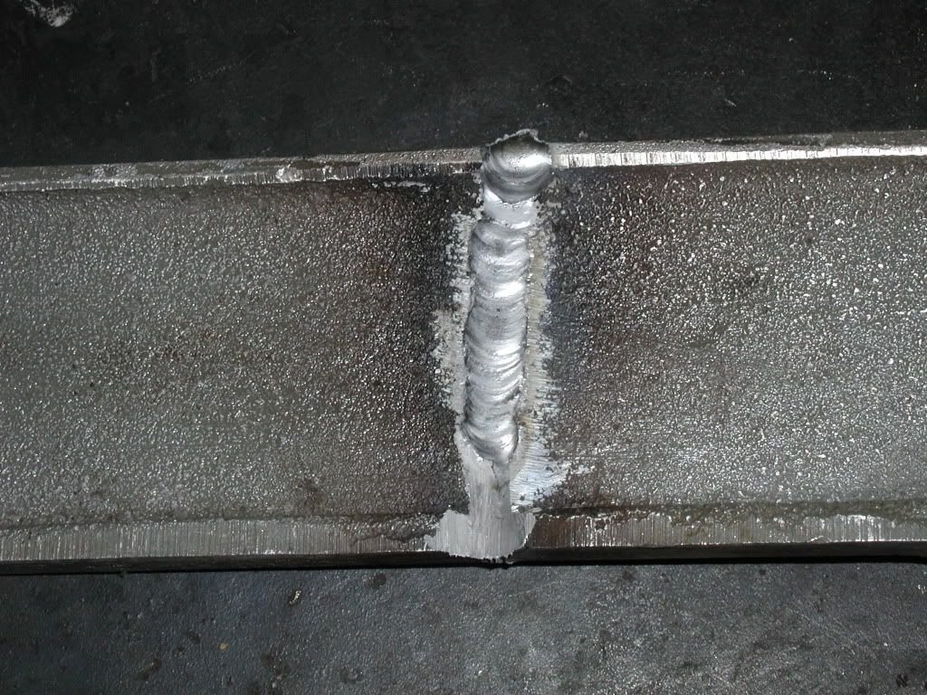

    I also welded the aluminum belt guard (keeps oil from the change gears off the belts):
    The PIO must have changed gears at some point and moved the adjustable gear support to the other side of the banjo. Then when going back to the standard setup, the 51T idler gear hit this guard and he shoved on it hard enough to break the al casting. I Vee'd it out on both sides, and then welded the material back in. Here is a pic of the guard in place:
