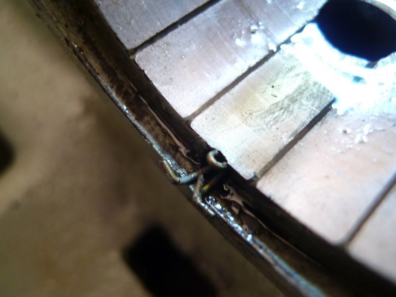

As I was sniffing around with a torch just to inspect everything and I saw these little guys in the oil return feed holes that flank the spindle bearings:
Are they there just to block stuff getting into the oil return feeds?

The bent wires in the main bearing oil drain holes are meant to be there. The break the surface tension of the oil so that it drains through the holes.
