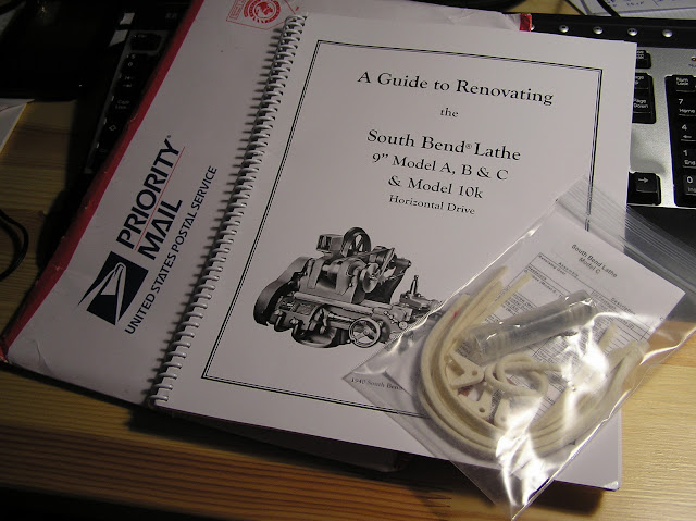

    Anyone know about the felt wicks in it?
    I suggest to get the Rebuild Manual from Stephen Brooks. There is a well written step by step instruction on felt wick replacement in it. He is also selling the felt wicks in kit together with the manual for different type of SB lathes. Well worth it, you can use it for future overhauling, repairs or reassembly as well.
    LINK to his listings.
