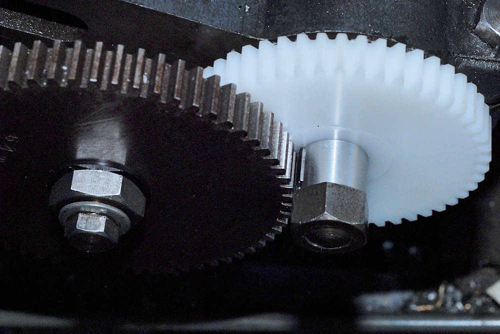

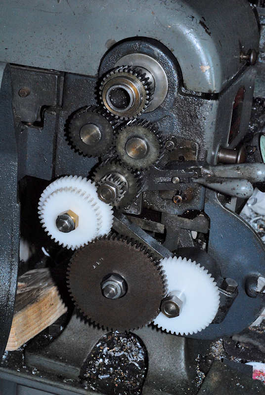

    I was cutting some fine metric threads for the first time on my Logan, but suspect this applies to SB and other lathes as well. Reading on the 'net about 127/100 and 47/37 gear sets, all seems simple and easy. It probably is for 1mm and easy division pitches. Silly me. What I discovered is that for fine threads, say 0.35mm pitch, there are only a few possible combinations of gears, and of those, there are combinations that simply can't be made to fit and/or engage without interference. I ended up cutting several new change gears I didn't have, and remaking various spacers and fasteners, so I could get the teeth engaged without collisions. This is just a warning to anybody contemplating very fine metric threads to really think about the gear train and clearances.
    On a similar topic, I was hoping to someday stumble across a cheap used Starrett gear vernier. Apparently that's not going to happen. I just saw the new price- why in the world is a 456 gear vernier way over a thousand bucks???

    Hi Conrad,
    Not sure how your gear train is set up, but on my SB 9A, it's fairly simple: replace the 80-tooth idler with a 100/127 compound gear, install .46" thick spacer behind 56-tooth gearbox gear, replace 20-tooth stud gear with 28-tooth gear, then set gearbox tumblers to D-3.
    This is based on my experience with the gear set from Tools 4 Cheap. It includes the same gears as the original SB metric transposing set, and will cut all standard metric pitches from .20 to 6.00mm (though 4.00 is a more practical limit for this size lathe).
    Since you selected the 100/127 gear, I assume your Logan has an 8 TPI leadscrew? Is your lathe a change-gear or quick-change type?

    Hi Paula, actually I went with the 37/47 combo. So far as I can tell, there's no way to cram a 127 in my fairly small (10") machine and still have room on the banjo to install much of anything else. Even with the 37/47 it's a tight squeeze to get the other reduction pair in there. I have to wonder if maybe Logan supplied an alternate banjo with longer slots to accommodate larger gears. This isn't a QC, just plain change gear- I wonder if having a QC actually improves the whole clearance issue?
    When I get a chance I'll post a photo of what I've got because I keep having this nagging feeling that there's some alternative way of setting it up that hasn't occurred to me.

    Quote Originally Posted by Conrad Hoffman View Post
    I have to admit that I have zero experience working with a change gear lathe. But I do think that having the QC gearbox helps with the clearance issue, mainly because of the array of 16/32 compound gears in the left hand tumbler position. This provides a compact way of adjusting the scale of the ratio required. For example, the stack-up of gear ratios on my 9A to cut the .35mm thread are (starting with the stud gear):
    28/127 x 100/56 x 16/32 x 16/32 x 16/32 x 32/20 x 28/20 x .125" = .013779"
    .013779" x 25.4mm/in. = .35mm
    Notice the three 16/32 multipliers -- these are all within the cluster of gears controlled by the left-hand tumbler. I think that this compact arrangement of (4) 16/32 compound gears (and one 16-tooth single gear) greatly aids the clearance problem with high-ratio pitches.

    Ah ha! Yes, the QC box moves a lot of conversion off the limited space at the end of the lathe. My .35 solution is:
    0.125 (leadscrew pitch) * 37/47 * 28/50 * 16/64 = .01377"
    The 16 is the stud gear and the 50 is the leadscrew gear, leaving me with the 37/47 stack and the 28/64 stack- you can only put two stacks on the banjo, so whatever is to be accomplished has to be done with that limitation. Because the 28 is small compared to the 64, the 64 wants to hit the shaft of the leadscrew. I had to replace the normal spacer/bushing on the leadscrew with a slotted ring. The slot is for the key, since the key goes around within a few thou of the 64 tooth gear. Probably be clearer in a photo. Anyway, with the plain change gears (call me weird but I do actually like change gears) this isn't just a matter of the math working out, but the parts have to fit- my guess is that finer *metric* pitches might not be possible. Normally it's no problem to go 250 tpi or more because the transposing gears aren't using up the space where another reduction can take place. Hmmmm... visions of a three slot banjo are forming!

    Hi Conrad,
    You can work with the 47/37 compound as well. 94/37 gives you a 2:1 reduction for example. Unfortunately 47 and 37 are both prime so you can''t break them down.
    There is another ratio that gives very close to 1.27 or 2.54, but I can't remember it. The tooth counts were 60's or 70's IIR, and my vague recollection was that one of the tooth counts was not prime and could be broken down, but maybe not in a way that gets you closer to .35mm pitch.
    'Course, making or sourcing these big oddball gears is either time-consuming or expensive, so there are practical limitations as well.
    Custom banjo is definitely a possibility. There's really nothing magical about how many slots or their orientation.

    Joe, I've perused the Logan info, but it's somewhat generic. That's what led me to believe metric setup would be an easy no-brainer! Goodness, though I'd like an HLV, I think I'd like a Monarch even better. Still, like a Ford man or a Buick man, I'm a Logan man. Having beat this to death, here's a couple photos. The 64 tooth gear at the lower center is only about 4" in diameter, so you can see that a 127 tooth gear would cover the banjo and much of everything else. Fortunately the 37/47 combination works just fine. Also note how close the 64 tooth gear is to the key on the leadscrew! It does just clear, and I don't know if I've mentioned that the M6-.35 parts I had to make turned out just beautifully.
    http://www.conradhoffman.com/metric1.jpg
    http://www.conradhoffman.com/metric_key.jpg

    Another option is to go to a higher DP. Yes, you'll need to make a different stud gear, but there's no reason the end gears have to be the same DP as the originals, or the same as the gears in other trains. As long as you're running low-speed and light loads, 20 DP or even 24 DP should stand up just fine.
    64-tooth in 24 DP is only ~2-1/2" OD.

    Finegrain- excellent and clever thought. That's what Sherline does- two entirely different DPs to solve the diameter problem because their lathe is so small. I actually thought about the fact that they do it, but never made the mental leap that it wouldn't be all that difficult to convert at least one pair of mine. Thanks!
