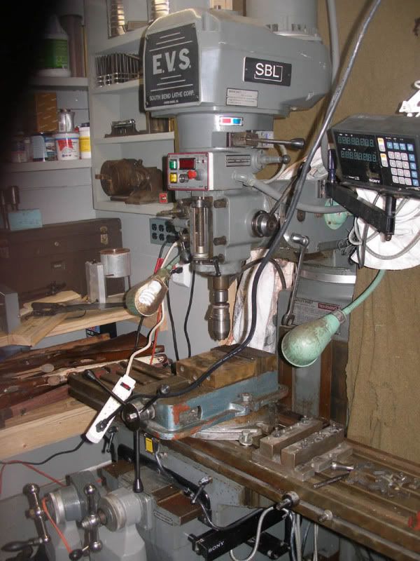

    At the risk of threadjacking, I really need to know my S-B linage and this thread has me questioning my place in life. Kinda like the kid that looks nothing like his father but is a dead ringer for his uncle, I never asked where my S-B’s were made, scared and suspecting they were not made here. Below is a 2003 ad from GFS showing the same lathe I use at work with a little flag and “Made in the USA” on it. We got this lathe (Procter and Gamble, Ivorydale, Cincinnati) about 1995 from LaBlond and believed it was made in Batavia, Ohio. I always knew it wasn’t but there are no back badges stating country of origin. As I understand it, the lathe was made by a company named Turret from Tiawan and sold through the Spainish company LaGun? We also have a S-B mill bought at the same time, with a Baldor VFD. I was so impressed with this mill that I picked up a 1993 model (Magtech-Yakasawa VFD) for my small home gun shop.
    Is this (my at work machine) a Tiawan/LaGun?
    This is an ad from 2003 General Factory supply
    My personal garage toy. Is this also a Turret/LaGun? (ChipMaster II)

    12
    Default
    Yes it is as I have the same lathe I purchased two years ago from Lagun Republic. This is the lathe Ted and I were taking about that was a collaboration between lagun and SB. There are three features on this lathe that I destined into the original TWS line of lathes built by Turret back in the late seventies and early eighties. One is the transposing gear in the saddle that changes the direction of the cross feed. Originally these lathes built by Turret (as all Asian lathes did) longitudinally fed to the left and when you shifted to cross feed they faced in. I changed that by adding a gear between the main drive gear out of the apron gear box and the lead screw gear. I also shortened the lead screw gear so the drive gear did not contact it. If you were to pull the front cross slide hand wheel assembly off the saddle you will see the pin just to the left and a little below center were this pin is pressed into the saddle and you can look through the hole into the saddle and see the little gear I added.
    There is also the direction of feed change by push pull knob on the front of the apron that I also designed into the originals Turret lathes built back in the early days.
    In the late seventies none of the lathes coming from Taiwan had more than 45 degrees of graduation on the compound. In a meeting with five plant owners and there engineers from Taiwan I setup a lathe and showed them why we wonted at least 60 degrees of graduations so we could set the compound for cutting threads. It my amazement none of these guys had ever seen threads cut by advancing the tool from the compound only the cross slide. I will say it was a fun time back then.
    Turk
  20. #20
    Join Date
    Jul 2008
    Location
    South Bend, In
    Posts
    2,138
    Post Thanks / Like
    Likes (Given)
    88
    Likes (Received)
    146
    Default
    bigearl67,
    Dennis has answered your question on the lathe(with a few other tid bits that I didn't know).
    The mill is the early version(circa 1993) of the same mill that Lagun imported from Spain. I don't remember the name of the company(started with a V or S ???)
    Ted
